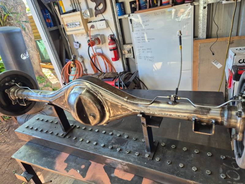

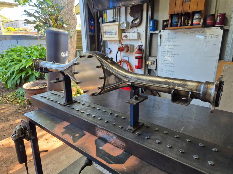

Thanks for all the input on the column, we haven't got there yet been a while since updates . So after spending money on 2 x banjo centres that appeared to be good but ended up being trash the banjo is gone. It just wasn't worth wasting more money on old stuff. We have gone down the route of a custom shortened hilux diff. Trutrac centre new gears , pattern change the whole works new everything. Wasn't cheap but should be set and forget for another 60 years. Should be ready in the next few weeks then we will be full steam ahead again .ImageImageImage

Posts: 14276
Re: Family Affair Ek Ute
That’s a good choice sneezy , those diffs can take a lot of punishment and with those upgrades it will be even better 👍
Posts: 5741
Blacky wrote: Fri Jun 06, 2025 11:11 pm That’s a good choice sneezy , those diffs can take a lot of punishment and with those upgrades it will be even better 👍
Good for about 400hp of hard abuse, a lot more power f driven sensibly.

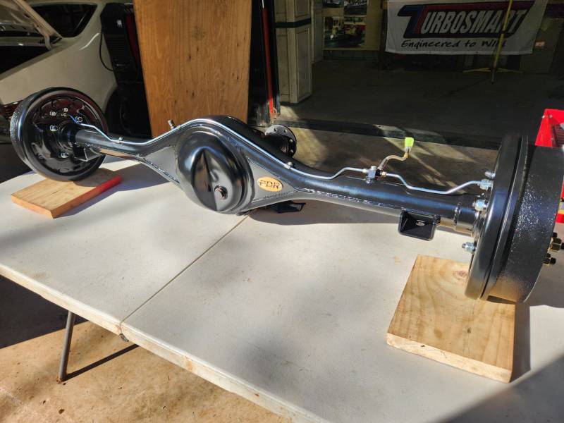

Well diff is all done and assembled, wasn't without hiccups tho suppliers sending wrong parts and so on.. At one stage it looked like it wasnt going to work there were meshing issues but luckily trev that owns that little 10 second 202 torana is mates with the diff builder he worked his magic and its together. Just cleaning up the springs with some paint and its ready to go in.. momentum stalled a bit the last few months but keen to get the old girl back together again.

Posts: 11670
Solid choice of rear axle there. What ratio? Are they originally 4.5” &*#@ pattern?
