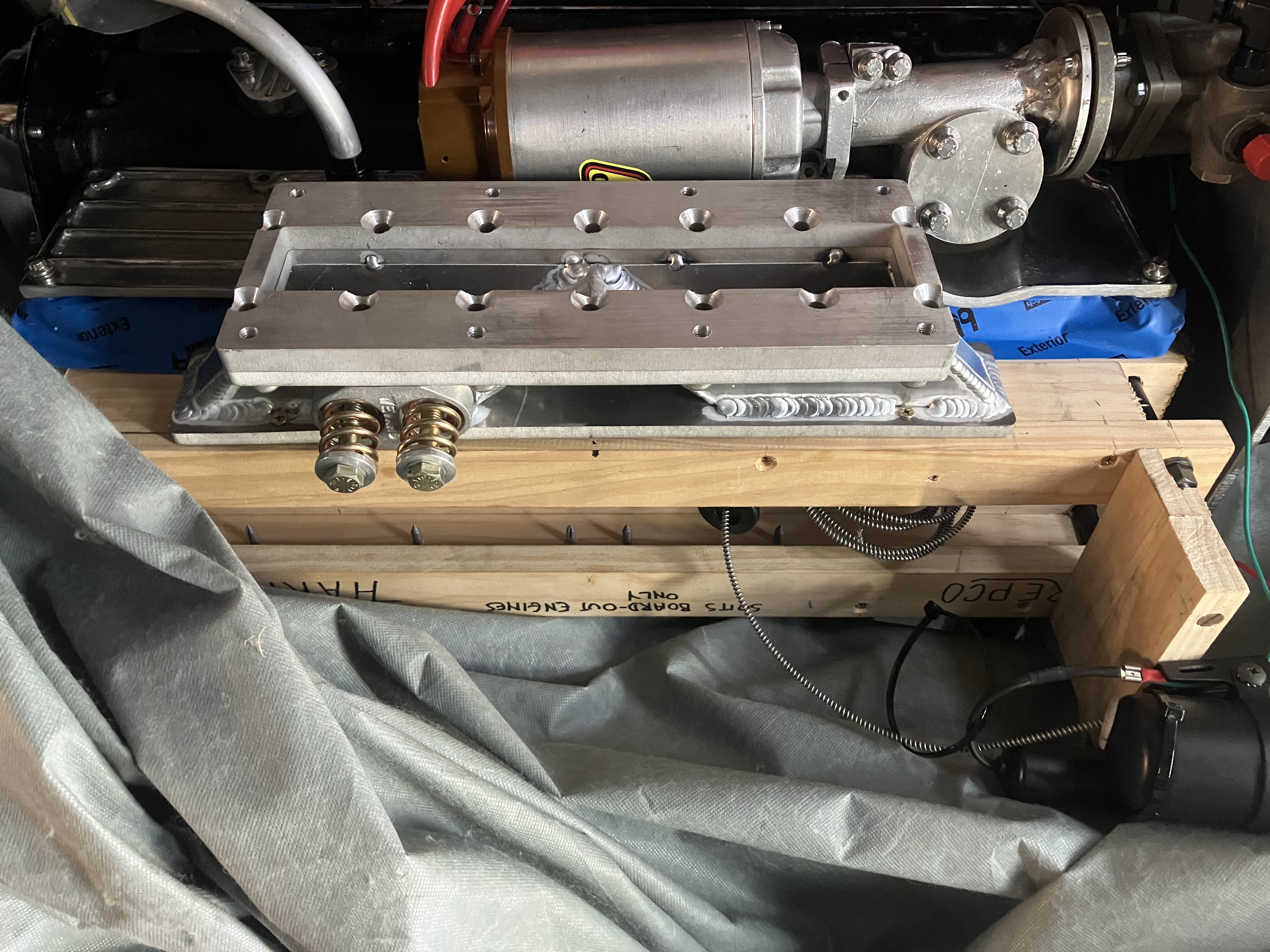

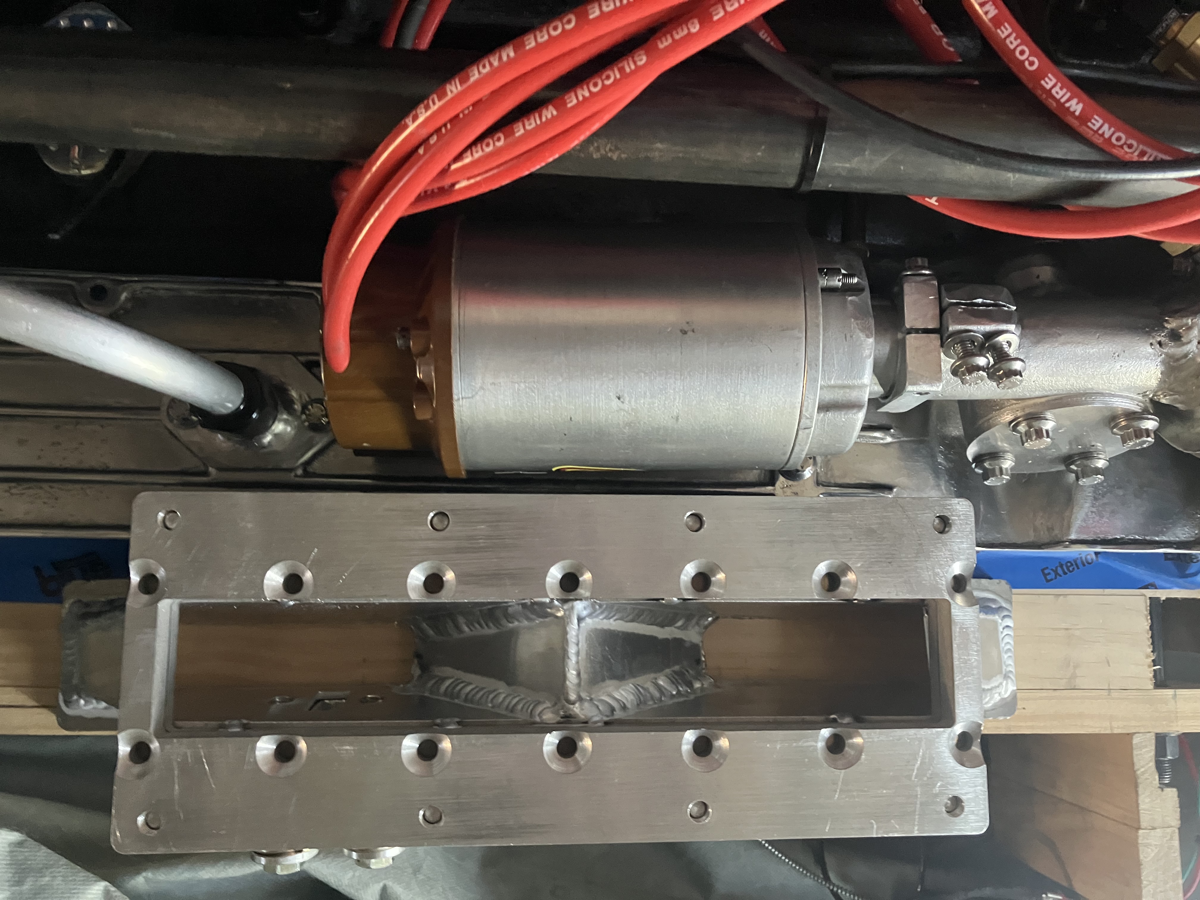

Cylinder head-to-Norman and Norman supercharger to McGee injector manifolds arrived today, with thanks and respect to Mallaby Sheetmetal and Bain Racing. Need to remember how to use my BMC Mini pixie-fingers. Teaser photos below:
Suddenly the real estate on the (normally) boring side of a grey motor got scarce.
Onwards and upwards.
