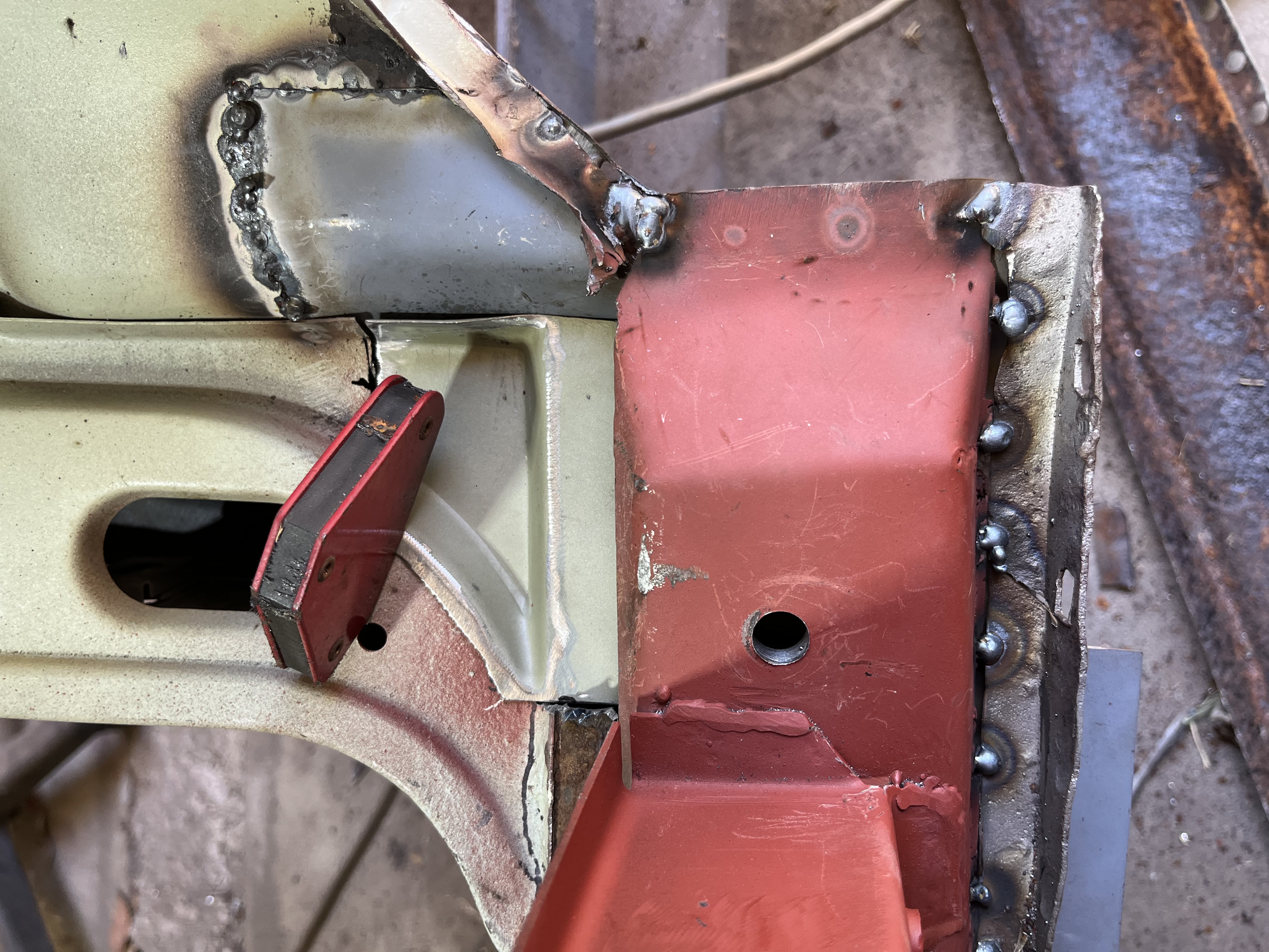

Didn't get much else done this weekend, cleaned all the rust out of the inner sill on the drivers side and used some rust converter and then primer on it.
Completed the bottom of the Drivers side A Pillar, trimmed the bits off the bottom and folded the edge under like you are supposed to do.
Need to roll the rotiss back over now and finish of the bottom of the passenger side A pillar.
Both front floor sections after that :cry: :lol: :lol:

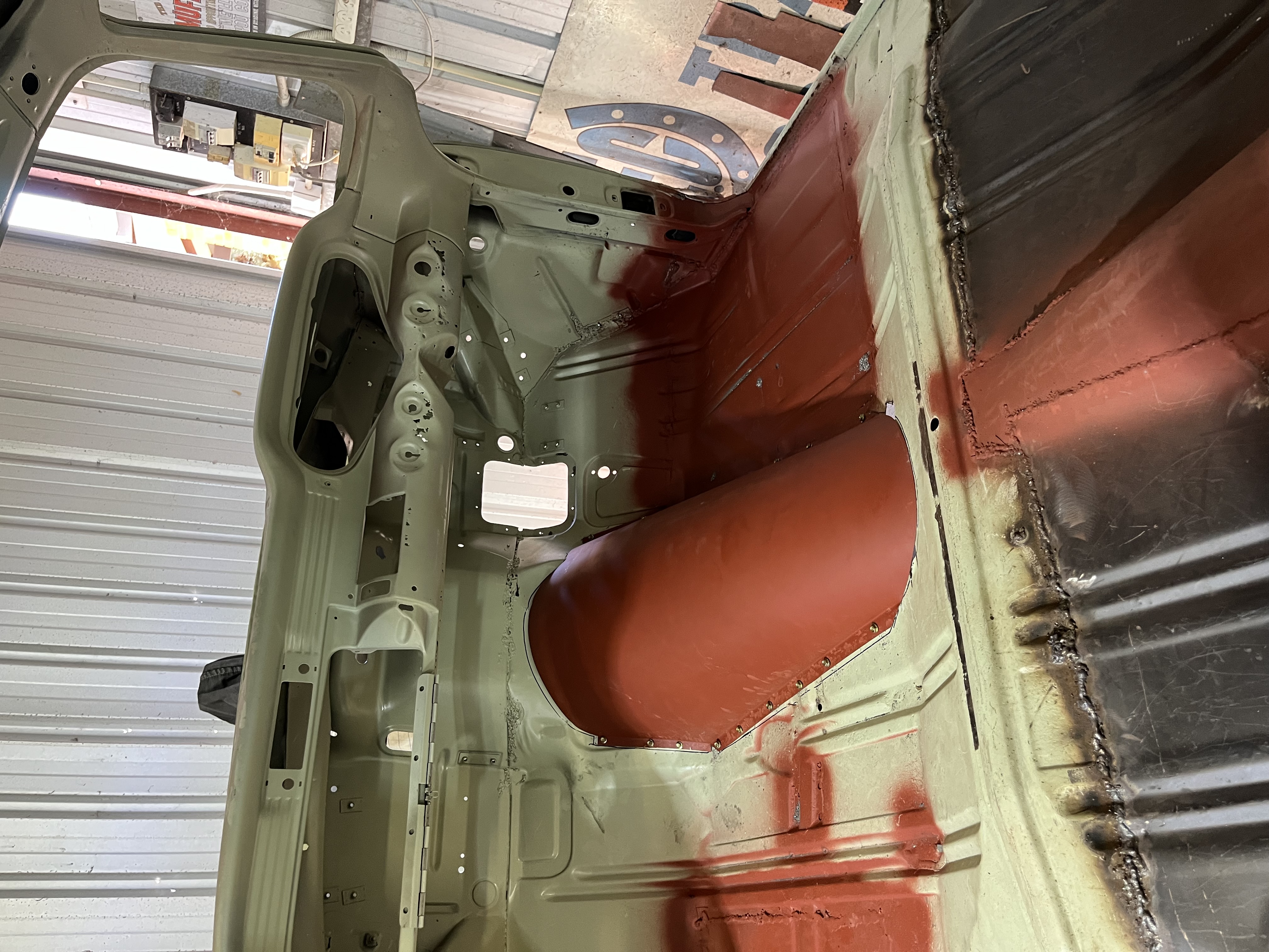

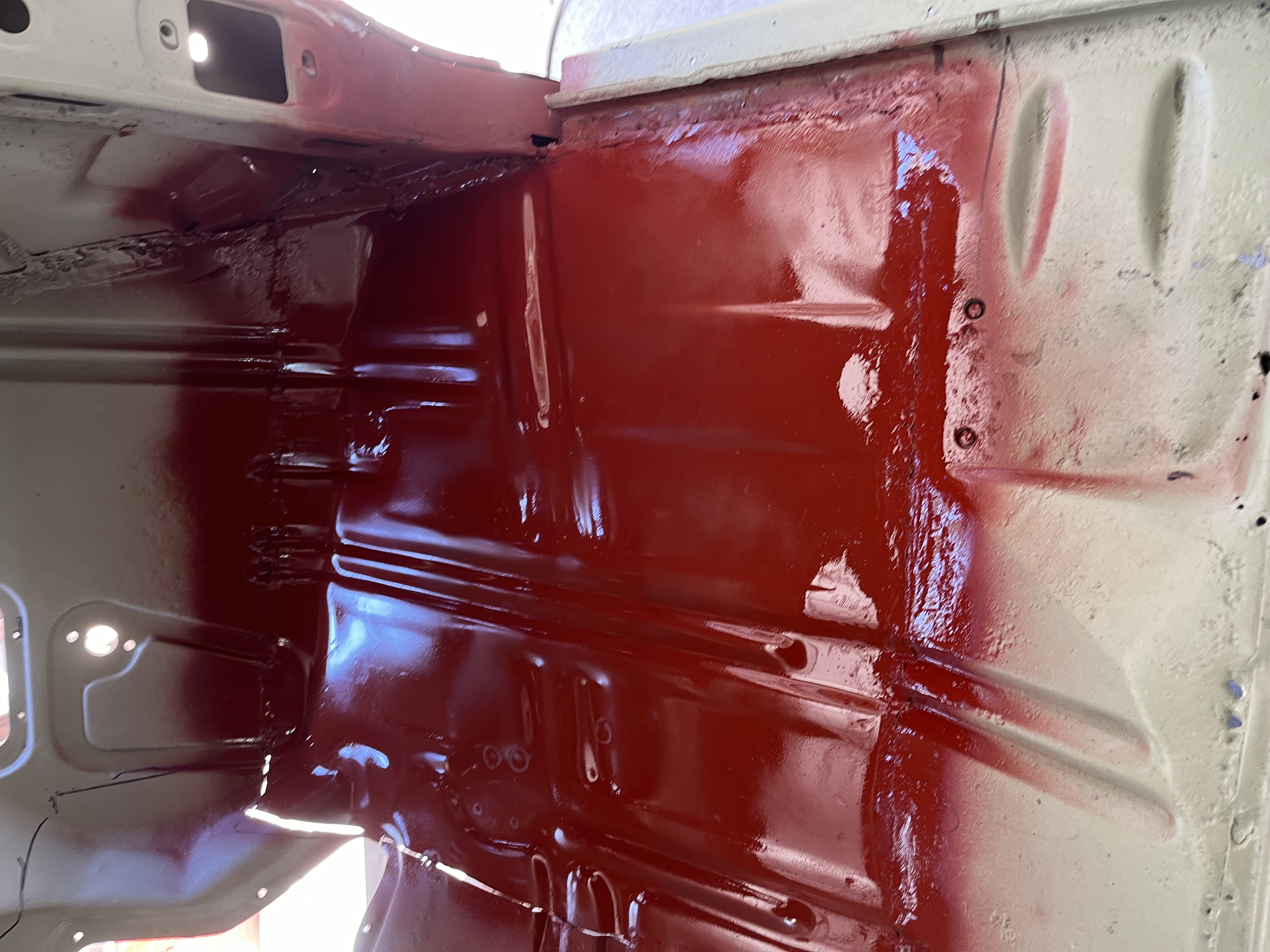

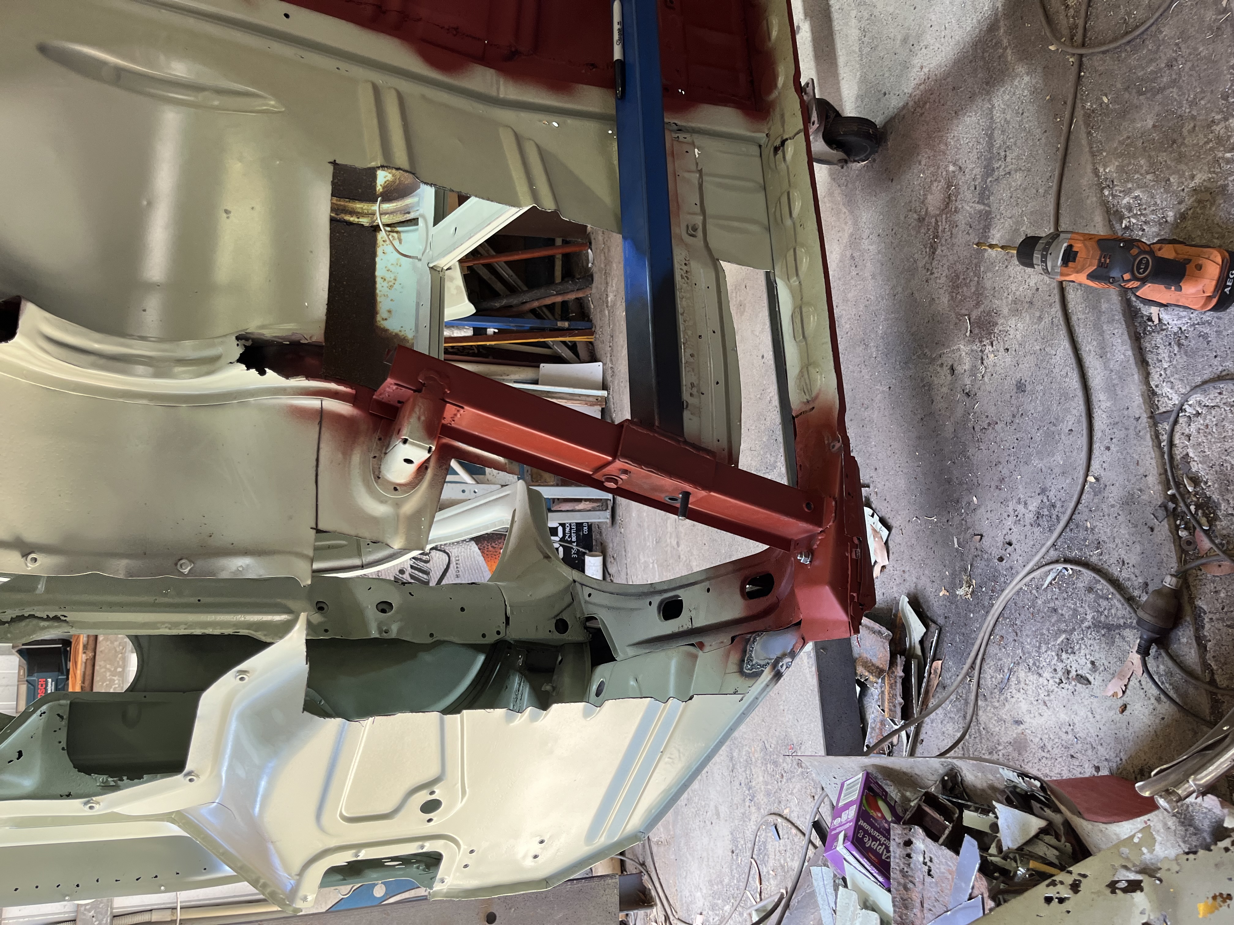

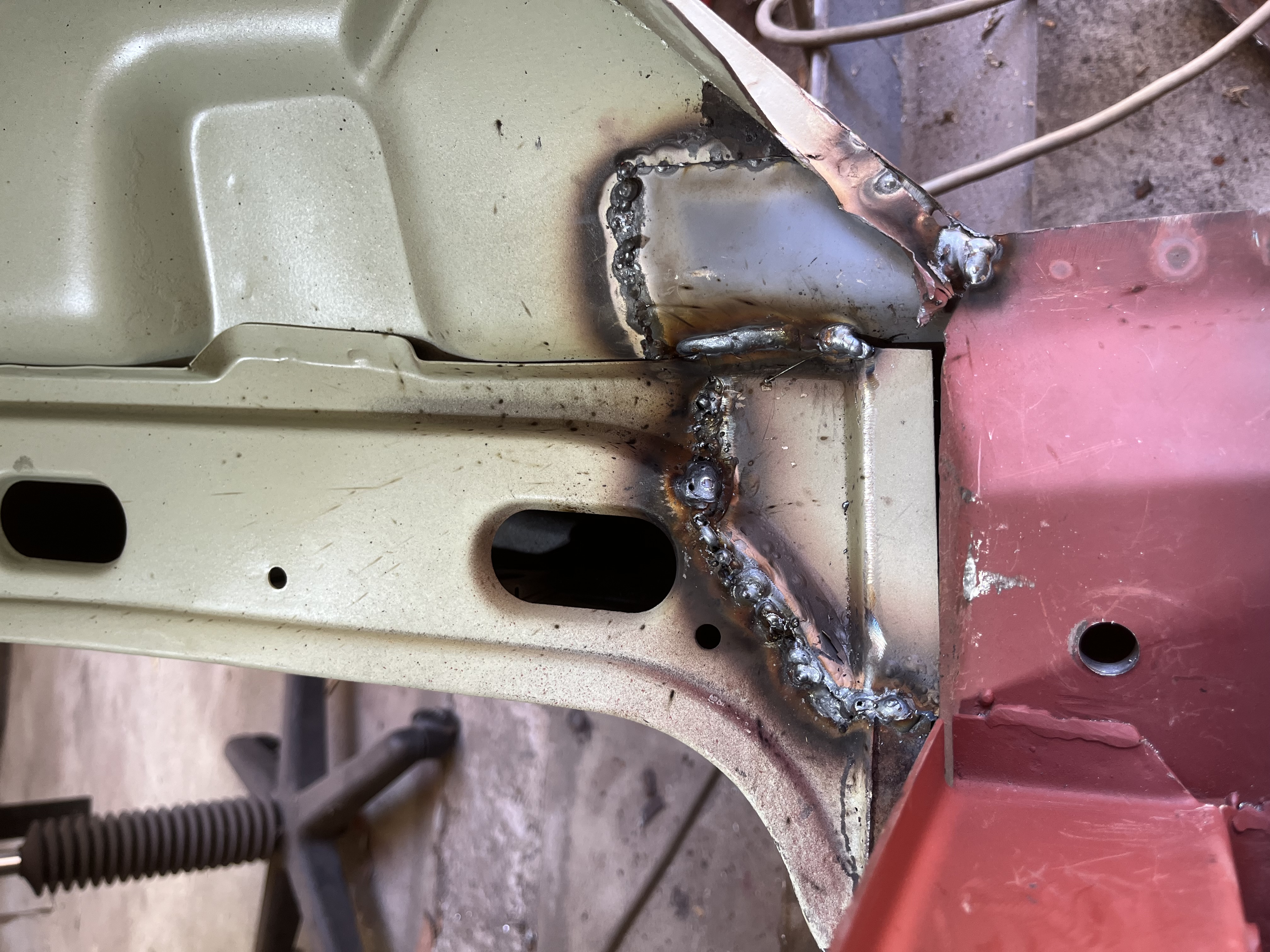

Got a bit done yesterday and today.
Had to do a fix on the inside of the passenger A pillar
Both A pillars now finished
Passenger side floor repair also now done.
Drivers side floor repair hopefully tomorrow :roll: :roll:

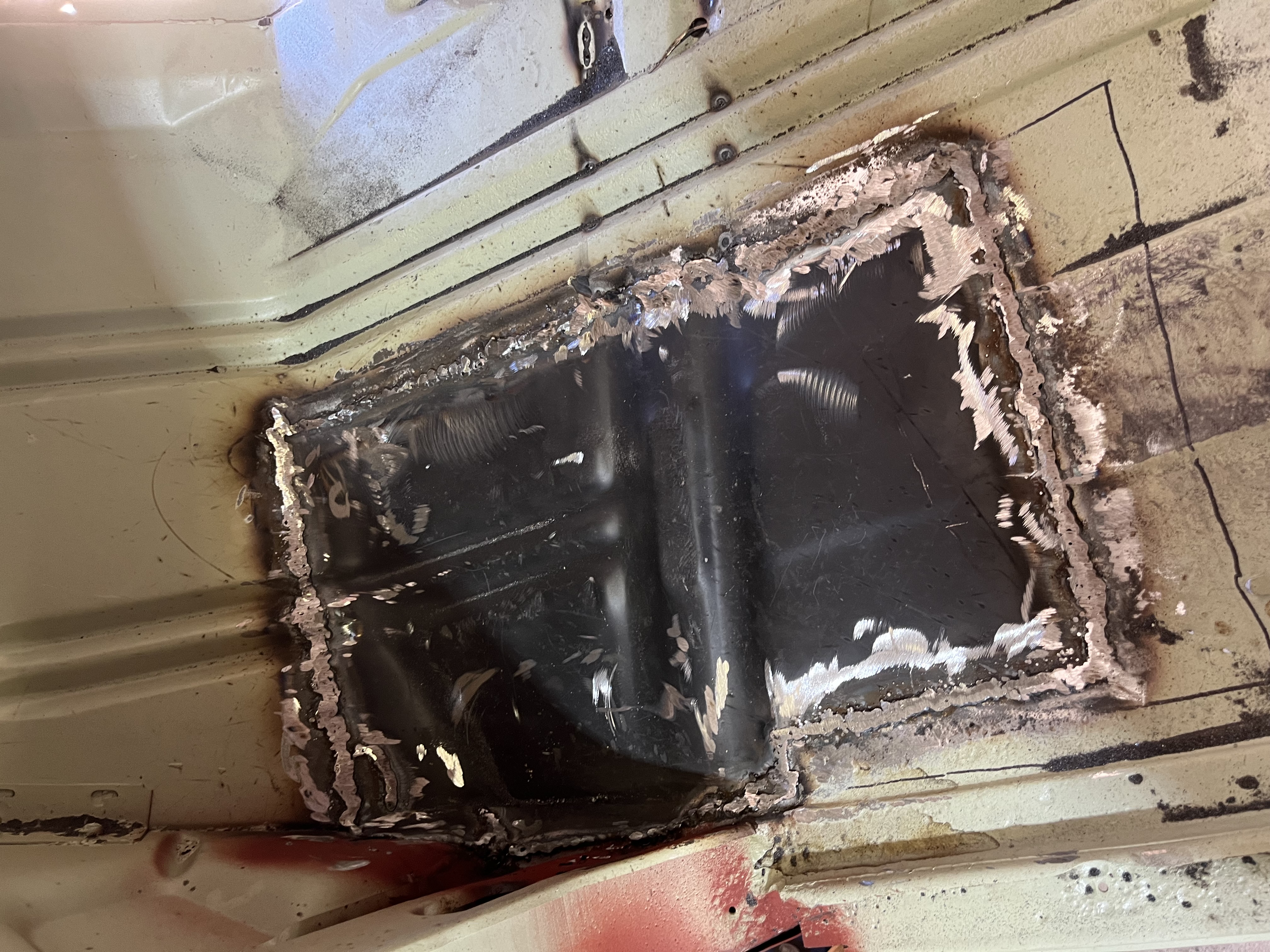

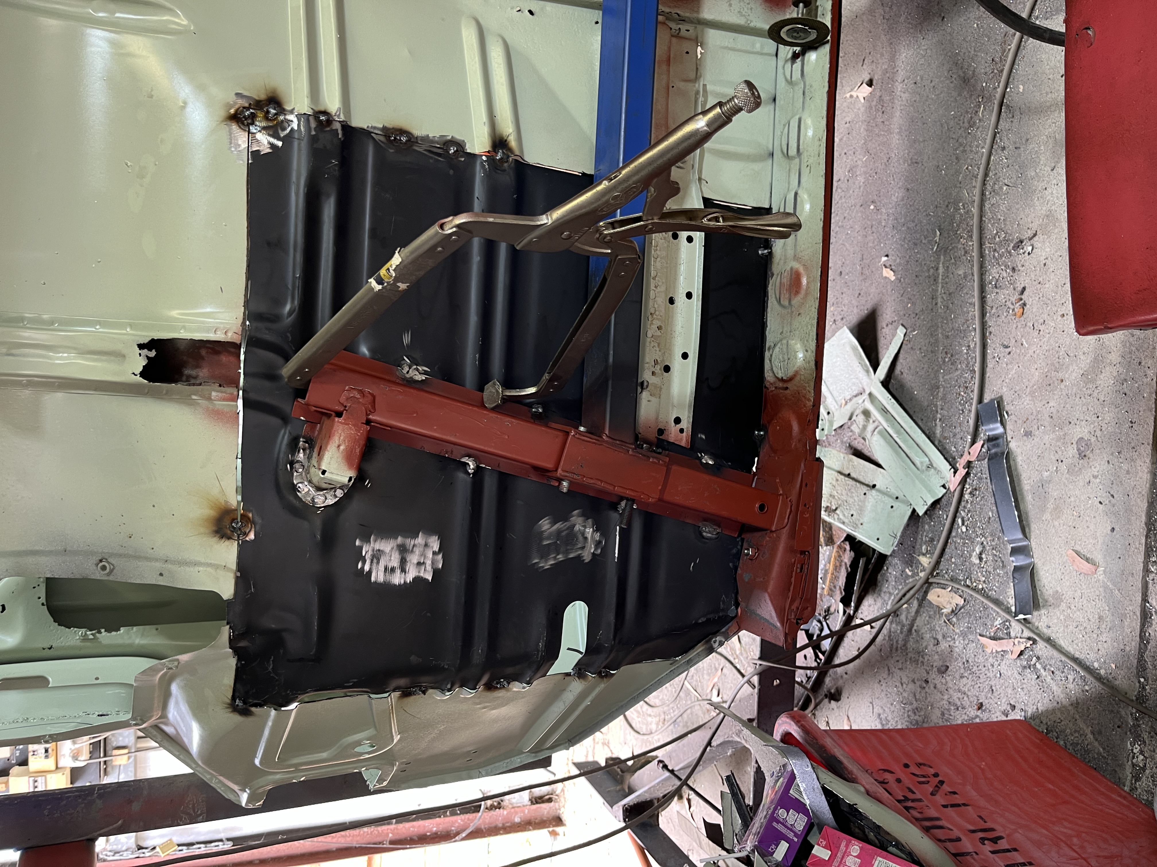

Ended up getting the driver side floor pan tacked in.
This was by far worse side of the front, it has taken nearly all of the Rares replacement panel, weird that the passenger side rear floor and under set areas were bad and the driver side front :wtf: :wtf:
Some of it will be cut out when the new floor hump goes in but I thought it was better to have good metal for the floor hump to mate to than the shite that was still there.
Big hole to start with.

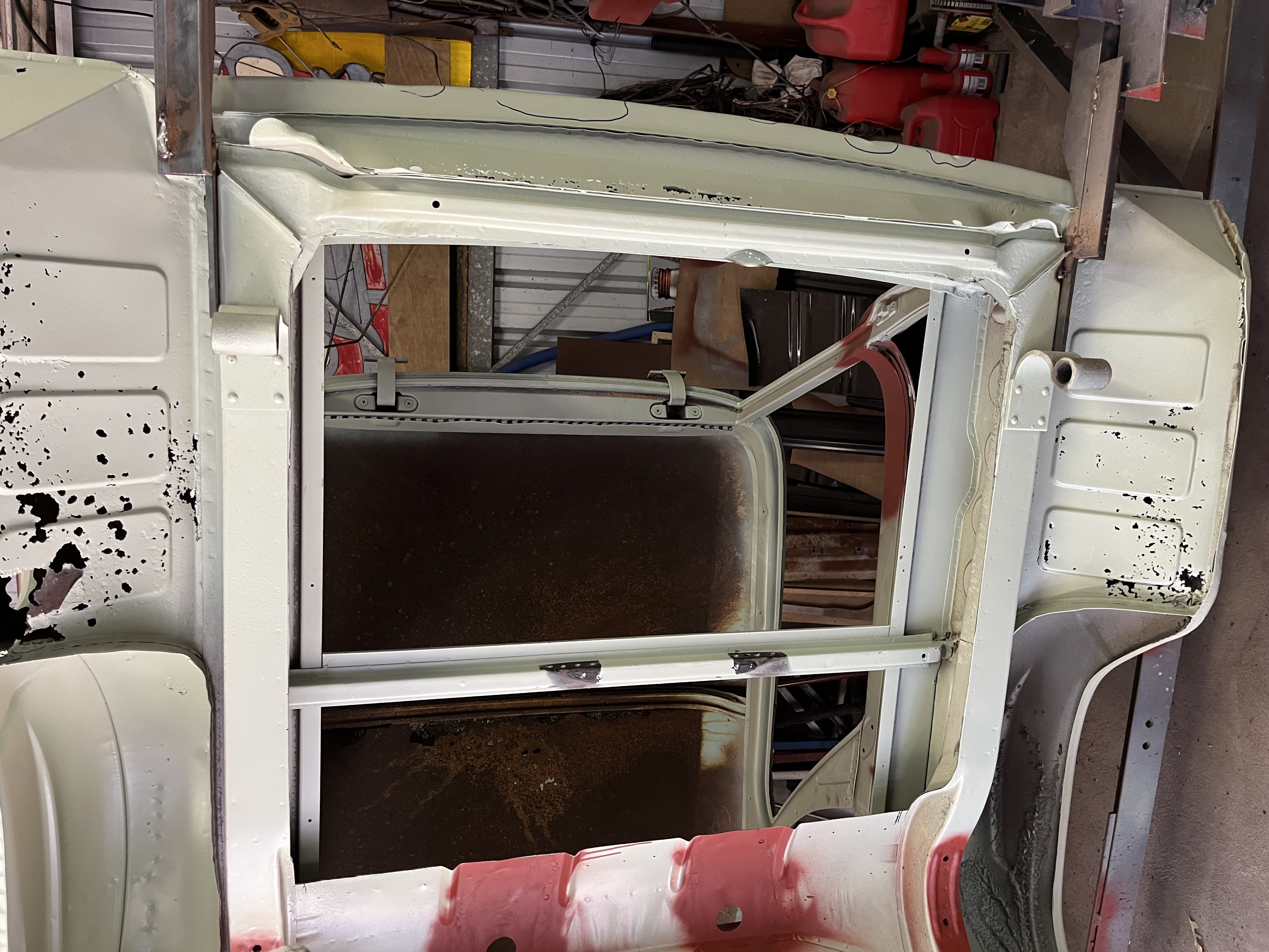

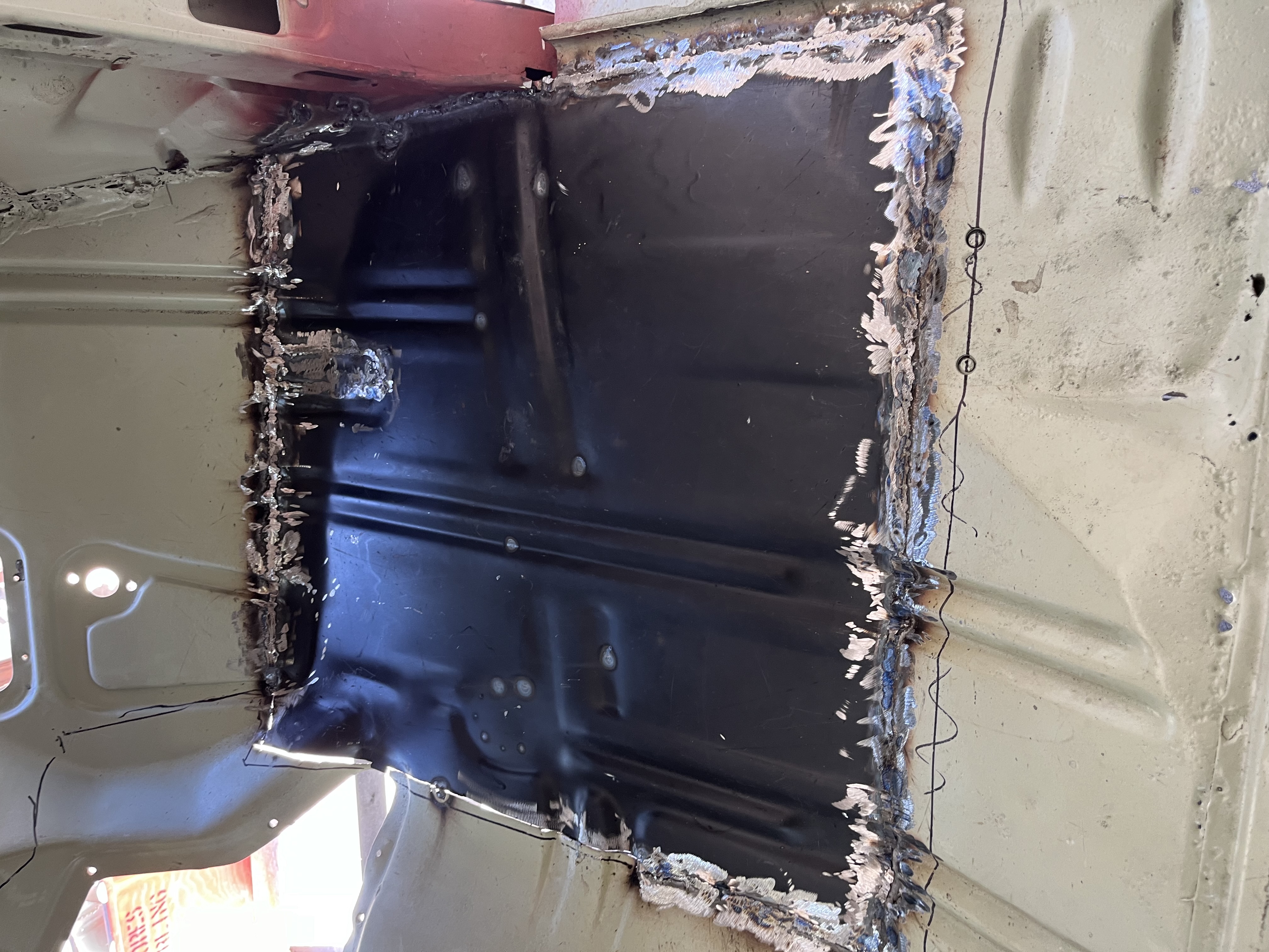

Decided to cut out the rest of the fuel tank surround before rolling the rotis down again, it was all rotted so no real lose
Not sure what I’m going to do there but I’ll sort it at a later date :lol:
Rolled the rotis and welded the driver side floor patch in.
Going to move on to the gearbox tunnel, like always the new one just does not fit all that well so as always “improvise, adapt and overcome :lol: :lol: :lol: :lol:
