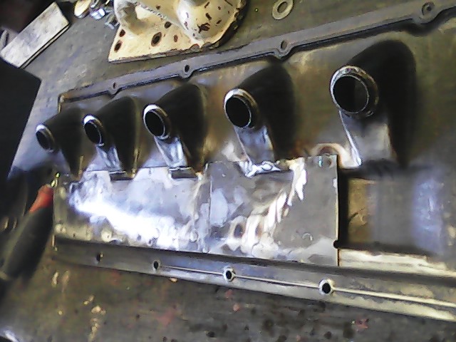

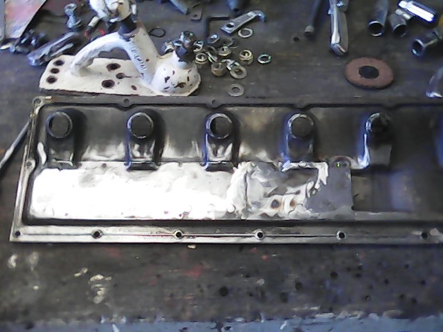

Another little update this week. All my mods on my side plate didn't make much change to oil dripping from the breather. The last one I even tried to mimic a red motor rocker cover baffle which had little effect. I even used an amount of stainless gauze and some foam which also didn't do much. I now know the cause of the problem is two fold. Firstly its constant high speed driving as we do out here in the sticks, and secondly the resultant high amount of airflow across the crankcase pulls oil into the area behind the breather plate and out the vent tube.
Believe it or not the fix I have found is restricting flow into the breather cap. It has stopped the oil issue and my thinking is restricting air flow reduces the amount of oil pull over, and as you can see it was pulling it uphill towards the pipe as per the incline of the engine. Secondly I am hoping it will impart a slight vacuum in the crankcase and reduce any leakage at the rear main. I will be fitting up a crankcase pressure gauge soon so see what the outcome is. I just don't want to risk turning a good engine into a sludgy mess.

I also tried and tried to prevent the breather pipe from dripping oil on both grey motors I had - nothing I did was as elaborate at your attempts.
I tried restrictions in the breather cap - even cutting away some of the "bell" of the cap.... oil continued to drip until the red motor went in.
With the V8 diesel 200 series Land Cruiser - they are very well known for picking up oil in the crankcase ventilation system. So much so, that it gunks up and eventually kills the left hand turbo (2 on these motors). I fitted a "Pro-Vent" 150 oil/condensate separator to mine.
It is a huge job on an engine that size - lifting the intercooler put threat on dislodging a small sensing tube at the rear of it - and there is simply no access to re-fitting the blasted thing. I was lucky, I was warned.
This Pro-Vent (Mann and Hummel, Germany) unit separates everything which comes out of the crankcase fumes.... it does this by the use of a special membrane filter... which reaches full efficiency after some 1,500 km's. A catch can, mounted remotely under the vehicle traps the oil/condensate until it can be drained out during an oil/filter change.

So, I'm now keen to see where you get with your vent pipe..... the obvious answer is to fit some form of almost "invisible" PCV system.
The breather pipe can be left in situ.... for cosmetics. Extracting condensate up and out of the rocker cover with a PCV valve shouldn't be too difficult to keep under the radar... you are expert with shaping and polishing pipework.. I could very well envisage some "eye candy" arrangement to compliment the fuel and vacuum pipe array up there. The inlet manifold of a grey motor has a great little port on the side of the heat box for such an addition. Idle mixture would need messing with.... maybe the main jet might need to be up-sized slightly as well - I would expect a great place to start this determination would be to study the different sized carby jets between a HR and HK 186... if my memory serves me correctly, the HK was the first to get the PCV system... I don't recall them being fitted to HR's... only the water heated manifold.... may be wrong....
One thing I would stress heavily though - is not to tap the manifold at all.... by adding a connection to the rear of it... this was the huge mistake made in the HQ series... they fitted the system to the rear (brake vacuum port) and #5 &#6 piston ran very lean... burning #5 out time and time again until Holden found the "cause"... stick to the central tapping port..... and find a PCV with a strong spring to keep it sealed at anything just above slight vacuum.... I would expect something in the vicinity of 10"... "moderate" power.
I'd leave the rocker breather in place - it would act as both a filtered input and also a vent for any build up.
I fitted a sealed system to my red when I first installed it... from a HJ. Worked a treat.... until I realised the intake air was not filtered through the air cleaner element.. but through a flimsy little dry gauze pad inside a plastic holder.. why, GMH - why?.... Toyota simply made the connection under the bowl... which is filtered air......
I now have the factory HK system... PCV and vented rocker breather... washed in petrol and oiled during oil changes.

Thanks Rosco, all very valid points I might add. Restricting the breather cap slightly actually fixed the problem. I only used some light foam and packed it into the back of the breather so it covered over half the holes. I think slowing the air speed down around the breather exit in the sideplate is important as the air is funnelled from a volume area to the diameter of the pipe. This I think speeds up the air (like rapids in a river) and that has the effect of syphoning any oil near it out the pipe. I'm not one for PCV valves, I don't like the effect it has on mixture control with carby engines. Like I said, just some pressure testing to go so I'm sure there is a minor negative pressure across the crankcase at all road speeds where possible. I know air flow wont be an issue as I can blow air through the breather quite well. Just a matter of balancing the inlet restriction amount to air flow across the bottom of the pipe for the average road speeds that I travel at.
Re: Seagull Grey EK 2106
Posted: Wed Feb 08, 2017 5:03 pm
Craig Allardyce wrote:Restricting the breather cap slightly actually fixed the problem. I only used some light foam and packed it into the back of the breather so it covered over half the holes.... Like I said, just some pressure testing to go so I'm sure there is a minor negative pressure across the crankcase at all road speeds where possible. I know air flow wont be an issue as I can blow air through the breather quite well. Just a matter of balancing the inlet restriction amount to air flow across the bottom of the pipe for the average road speeds that I travel at.
This is smart thinking. I like it, especially the verification with a temporary crankcase gauge 8) .

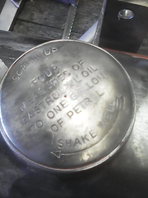

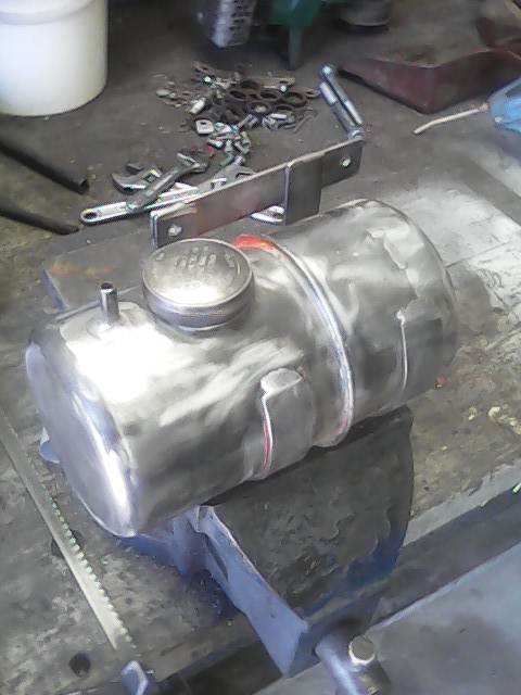

Todays little effort is brought to you by "I'm sick of coolant stains in my engine bay"
Managed to source an old mower/stationary engine fuel tank, cut an 1" out for the length of it so it could fit between the radiator and inner guard, fit pick up tube, knocked up some brackets so it bolts to the existing radiator support bolts, pressure test, and paint. Didn't want an alloy or polished recovery tank, just something that looks old and period. Love the instructions on the cap the most!
Between this and Harv's work with new improved head gaskets I should be good cooling system wise.

Thats Beautiful Craig - did you extend the pipe down into the bowl so it will work both ways or can't the radiator cap be modded to work both ways?

Yes it has a tube welded to the bottom of the tank but has a feed hole in it about 1/2" above that. Cap is a double sealed recovery tank cap 7 psi. These are readily available. System is designed to expel from radiator under expansion and draw coolant back to it when it cools as per normal.
Cost $50 parts and consumables, labour $800. Let me know when you want to order. :lol:

Schmicko Craig. Beats my plastic Rocca Bros one.
