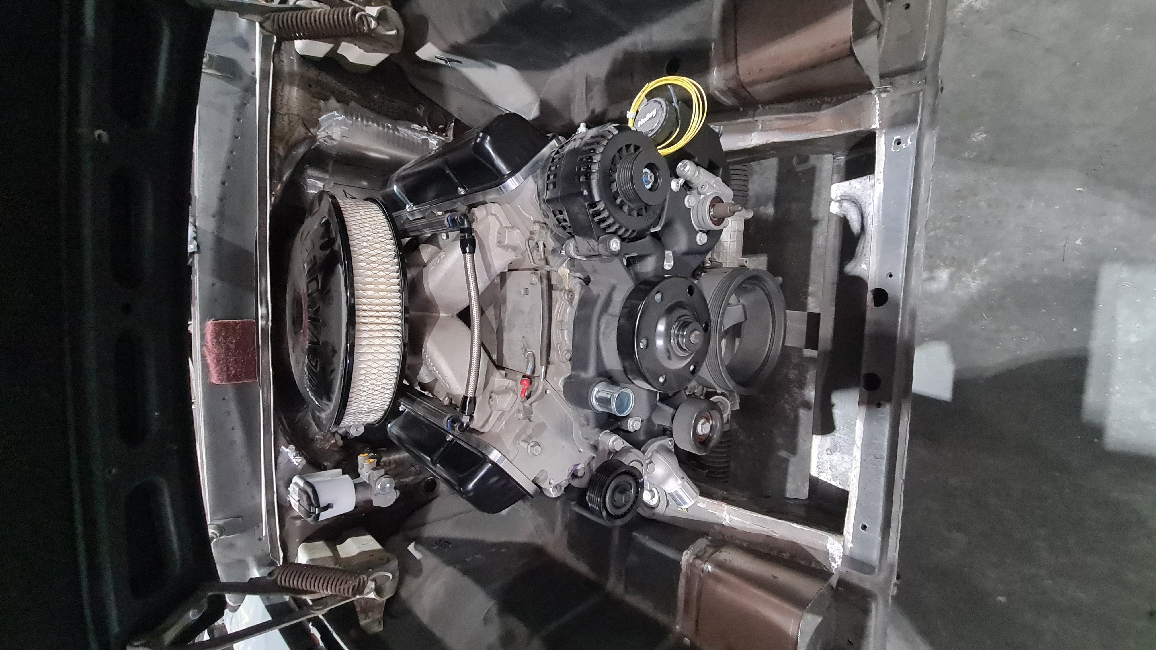

Holley accessory drive kit. Pretty awesome bit of kit and makes it all neat and dead simple as the alternator and P/S pump brackets are all part of the waterpump housing.

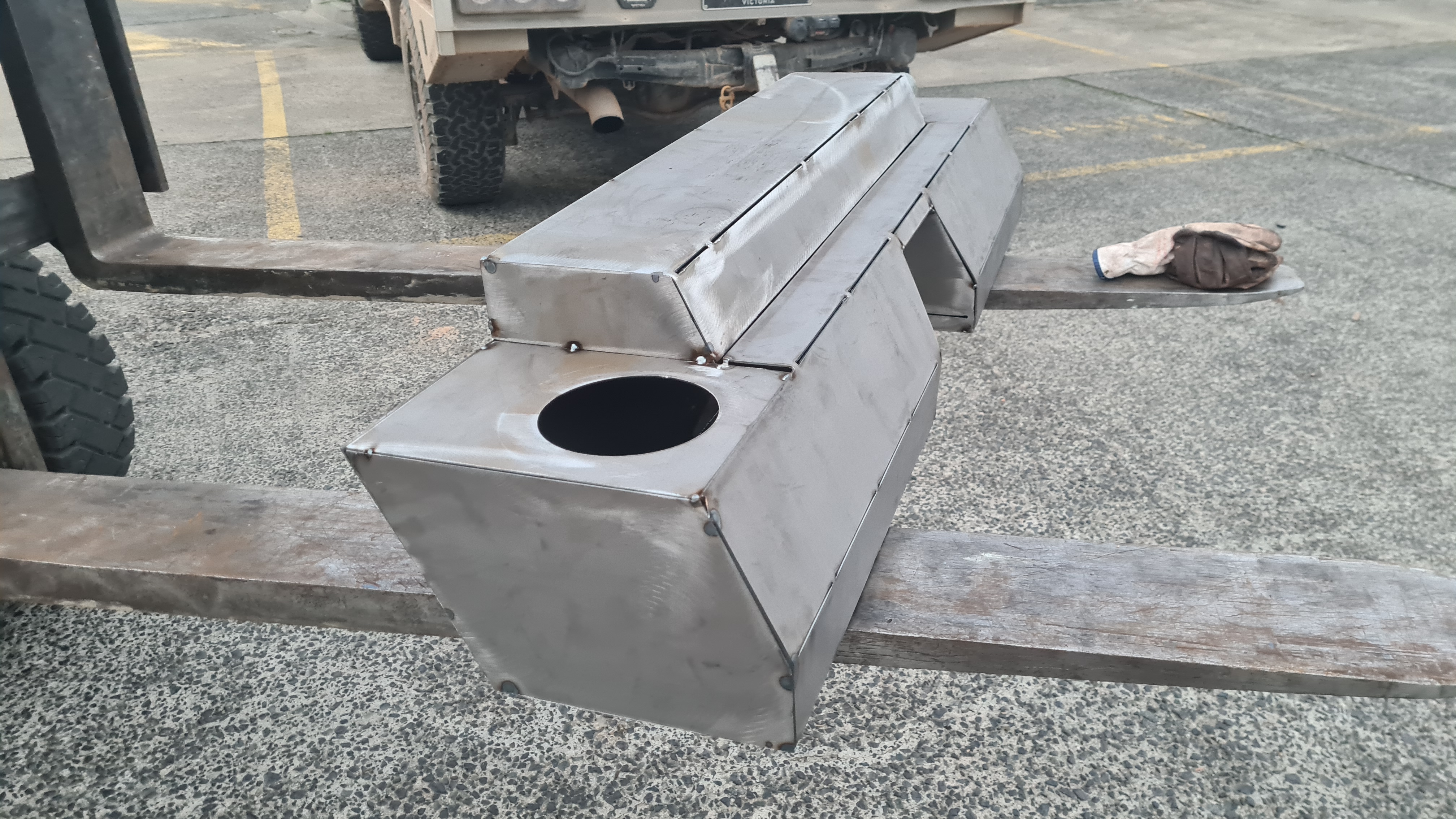

Prototype Fuel tank to sit in the void under the ute floor behind the rear firewall. I estimate about 70 litres.VE fuel pump from EFI hardware has 2 pickups so can pull fuel from both sides of the hump.
