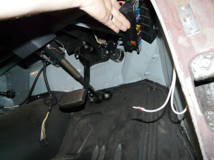

this is the steering column/dash strengthening, which ties everything together nicely.
this is the commodore brake booster on the original pedal box, it uses the centre of the pin to hold the pedal, there are shims either side to keep it in the right spot and then the brake switch and bump stop are relocated to the centre.
this is the mounting point for the bottom of the VR commodore steering column, uses the original mount from the commodore with a bearing in it but has been cut down and modded to fit better and then the hole in the floor has been welded up to just leave the area for the steering shaft to go through.

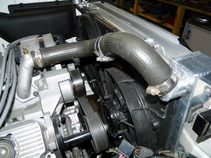

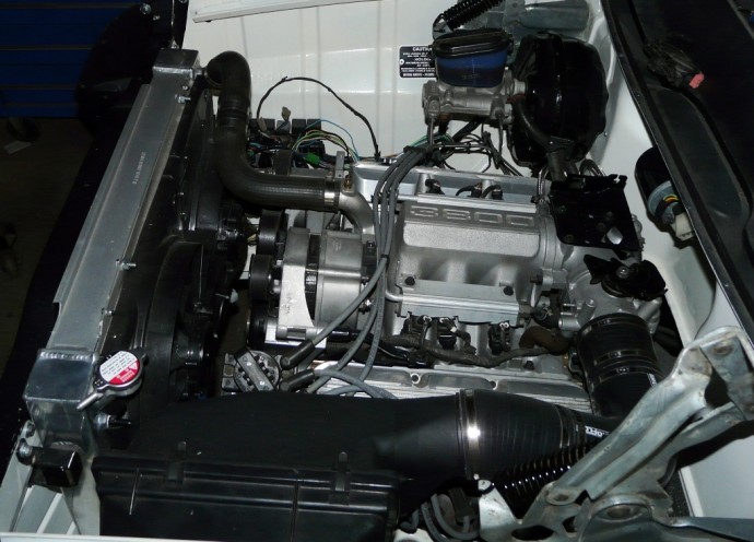

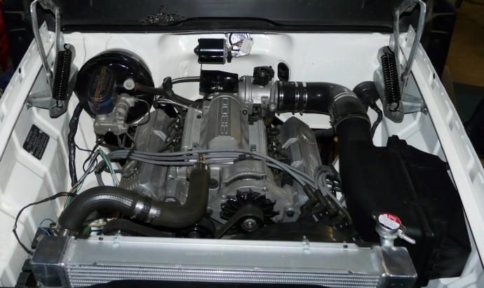

Thermo fan is from &*#@ mondeo, nice very narrow twin fan setup which fits the commodore radiators with minimal trimming.
the air box is made from a V8 item which happens to have the right angle outlet to suit this location.

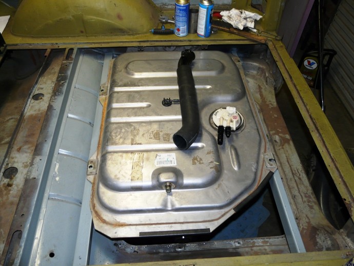

This is a VY SS Ute fuel tank I believe, fits in pretty well and the filler is in the side which lines up perfectly for the original fuel filler hole.

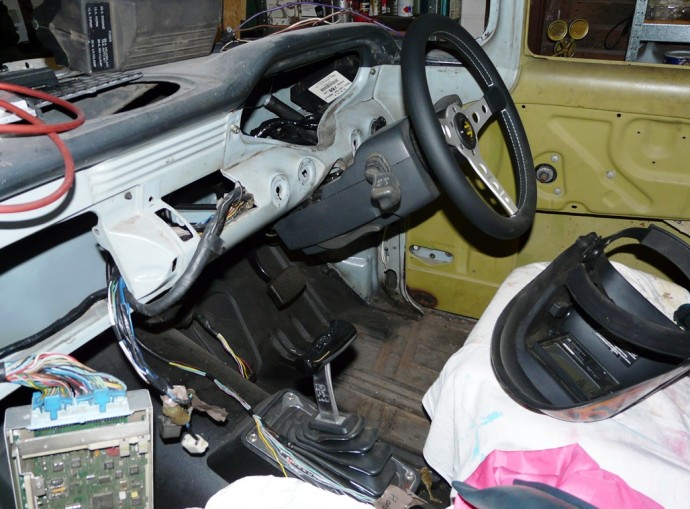

still some wiring stuff to do and tidy up, but the commodore steering column looks at home, and the steering wheel and gear shifter is right for the period I reckon!

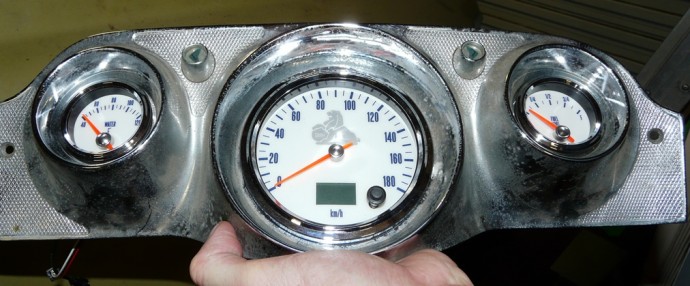

all new electronic gauges that will accept all the commodore wiring and still retain mostly the old dash look.
commodore column fitted into the floor hole from the original steering.

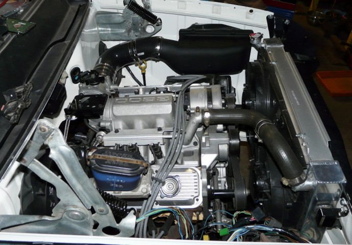

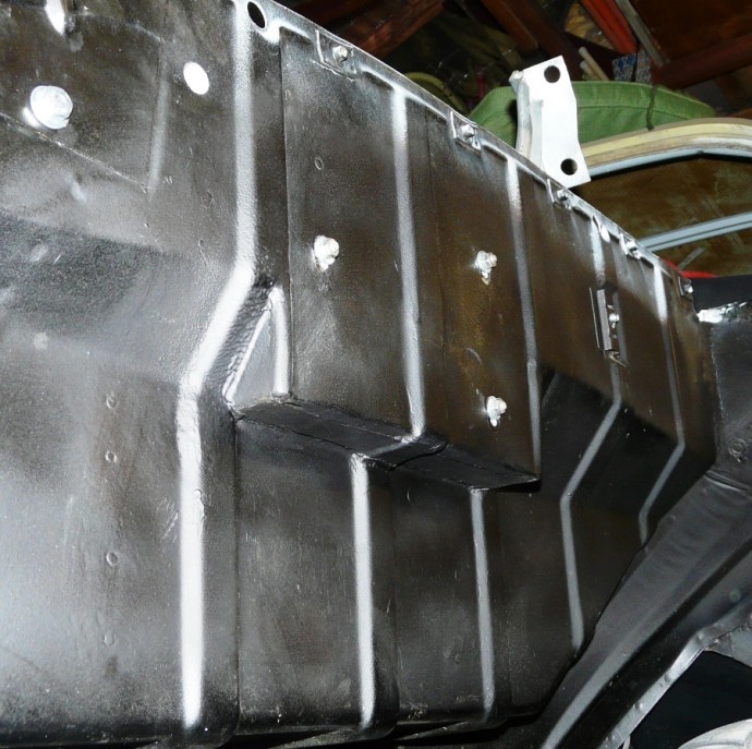

modifications needed to fit the commodore air box in
