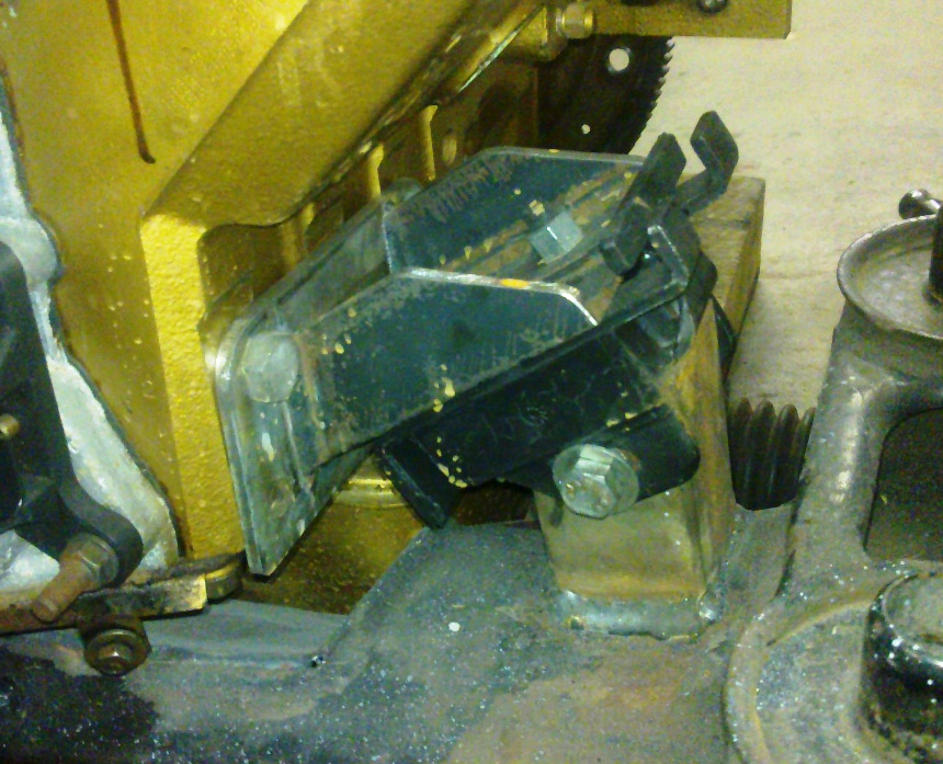

hes also finished off the enhine mount brackets to work with v8 holden mounts, bit of work going on to make the sump a bit larger.

custom engine mounts, these normally are in a slightly different spot, aswell as the crossmember mounts which normally have the motor sit further forward in the bay, this setup gets the motor back a good inch or so further than v6 conversions.

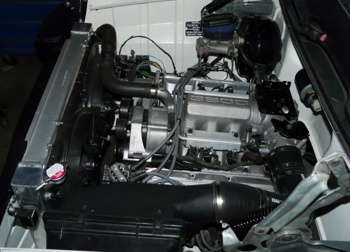

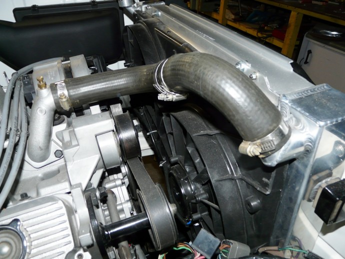

Thermo fan is from &*#@ mondeo, nice very narrow twin fan setup which fits the commodore radiators with minimal trimming.
the air box is made from a V8 item which happens to have the right angle outlet to suit this location.

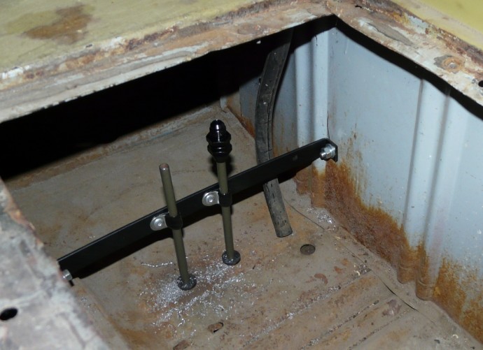

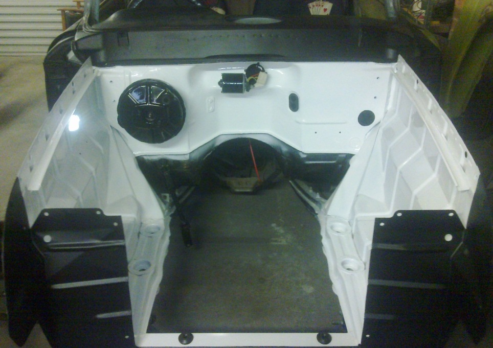

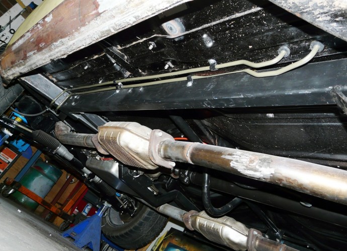

This is a VY SS Ute fuel tank I believe, fits in pretty well and the filler is in the side which lines up perfectly for the original fuel filler hole.

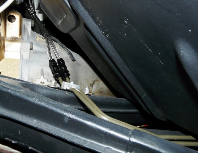

new fuel lines with speedflow adaptors, nice and out of the way but easy enough to access for engine removal.
and this is the other end of the fuel lines in the front of the tray area, they will then go under the tray boards to the fuel tank.
fuel lines almost look factory other than being so nice looking :P

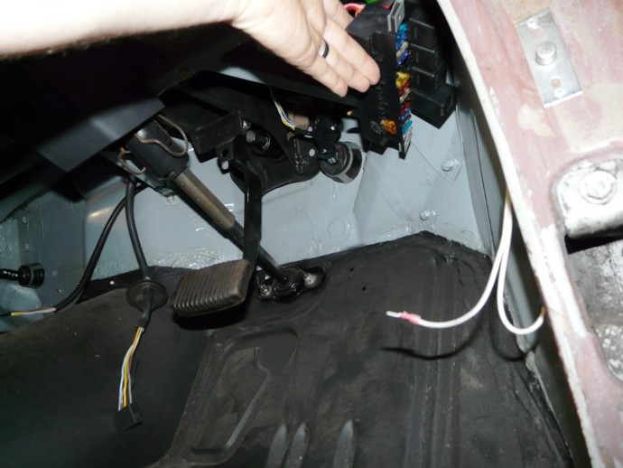

Posts: 664
Location: Tenambit, NSW.
Re: Project Modern FB
Post by Sammy »

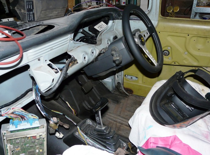

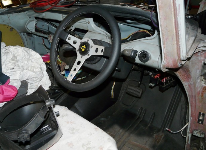

still some wiring stuff to do and tidy up, but the commodore steering column looks at home, and the steering wheel and gear shifter is right for the period I reckon!

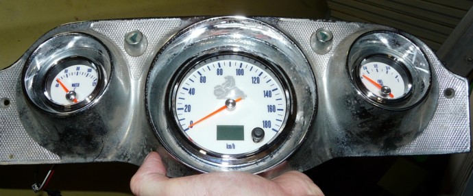

all new electronic gauges that will accept all the commodore wiring and still retain mostly the old dash look.
commodore column fitted into the floor hole from the original steering.

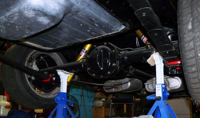

commodore 3.08 diff all rebuilt and tidied up.

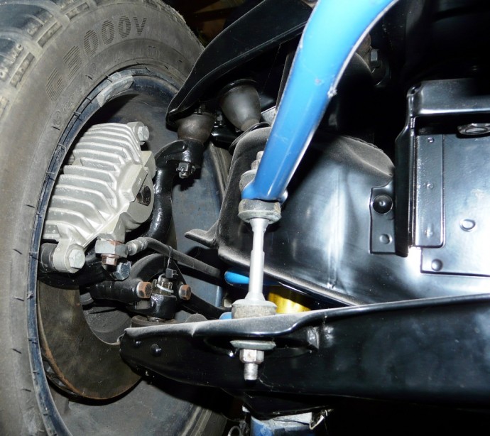

commodore rack and pinion steering, and the HR front end has been fully rebuilt and powder coated.
VP V8 front brakes, original oil line hole on the back has been blocked and a new one added in the side to allow the brakes to clear the front end on full lock.
