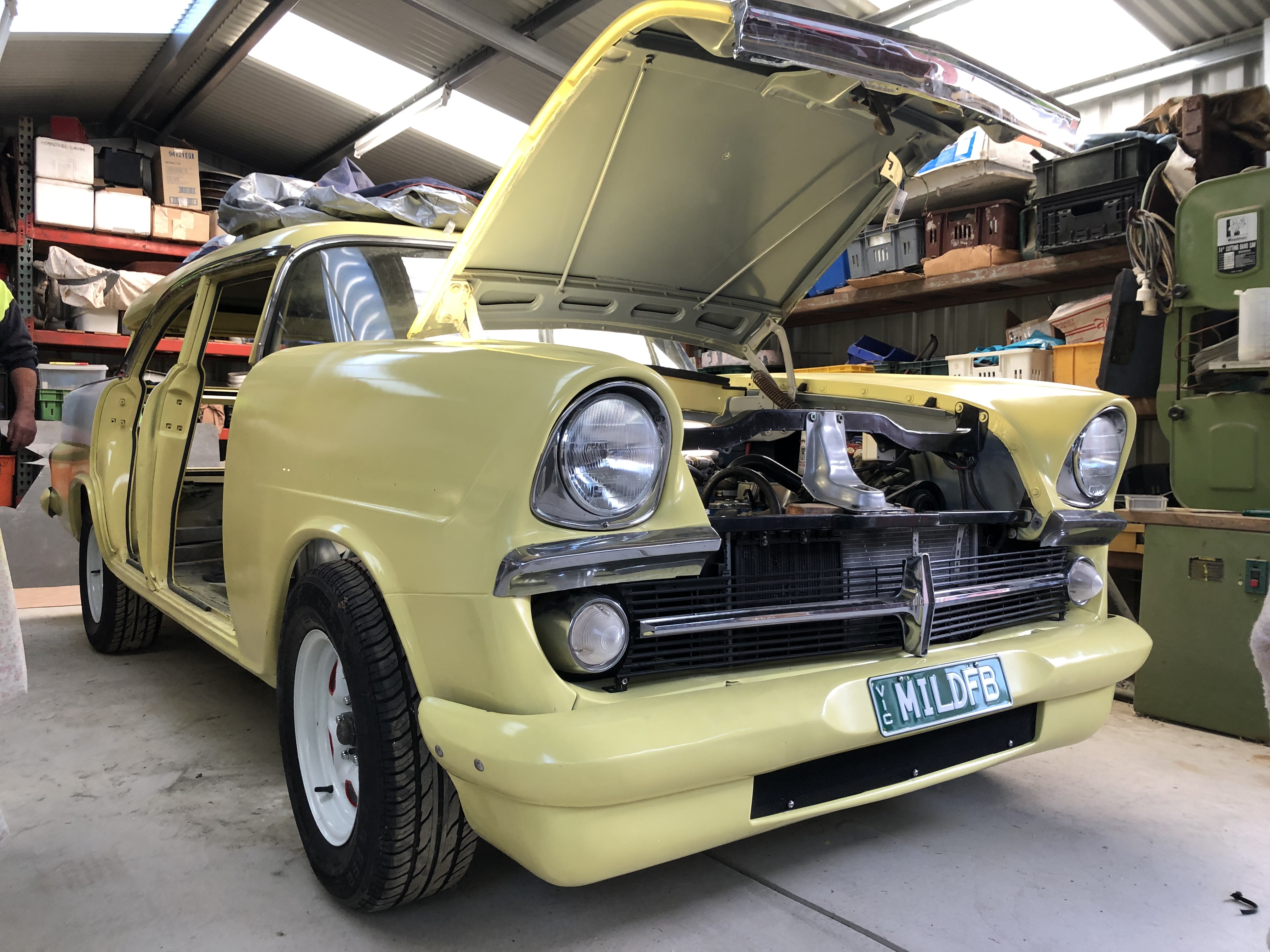

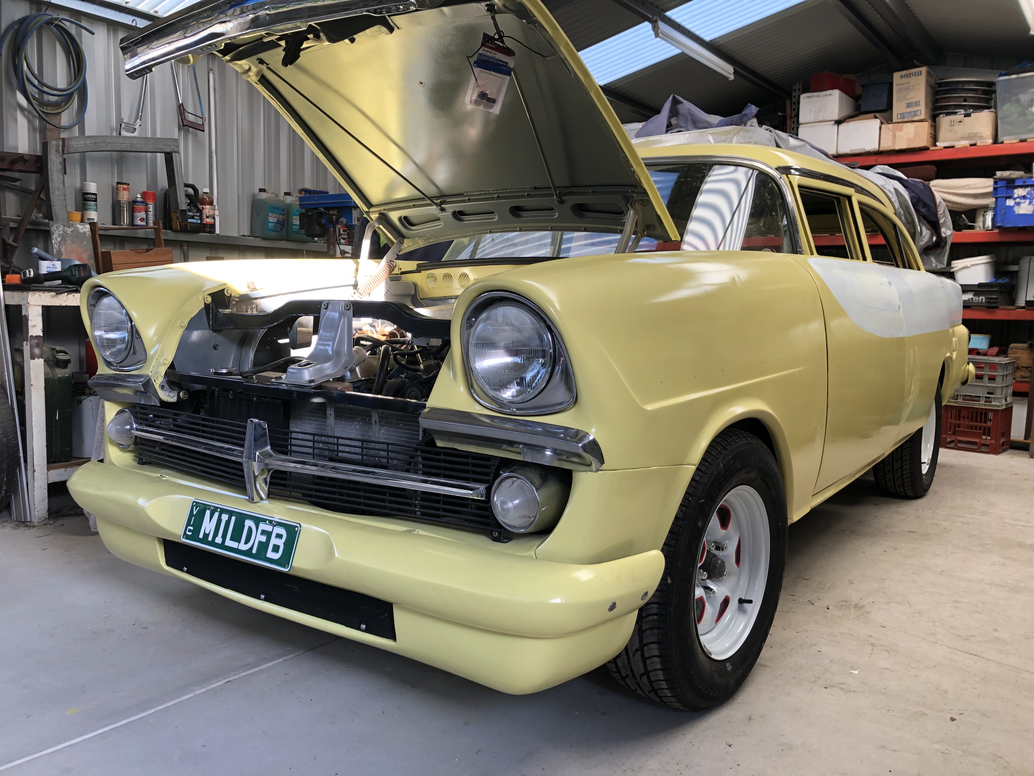

OK good one. it's changed since last time here...

Looking good!
