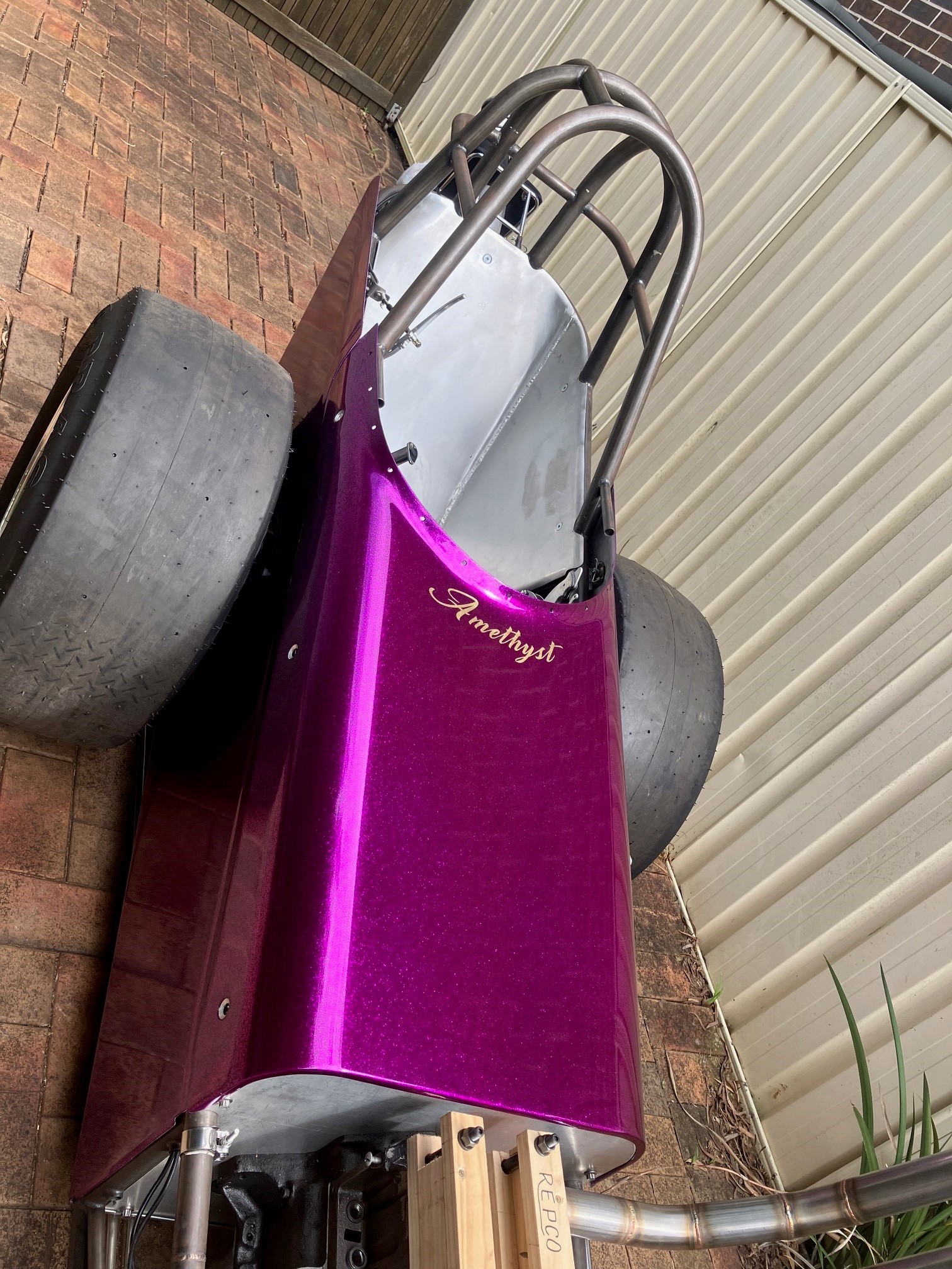

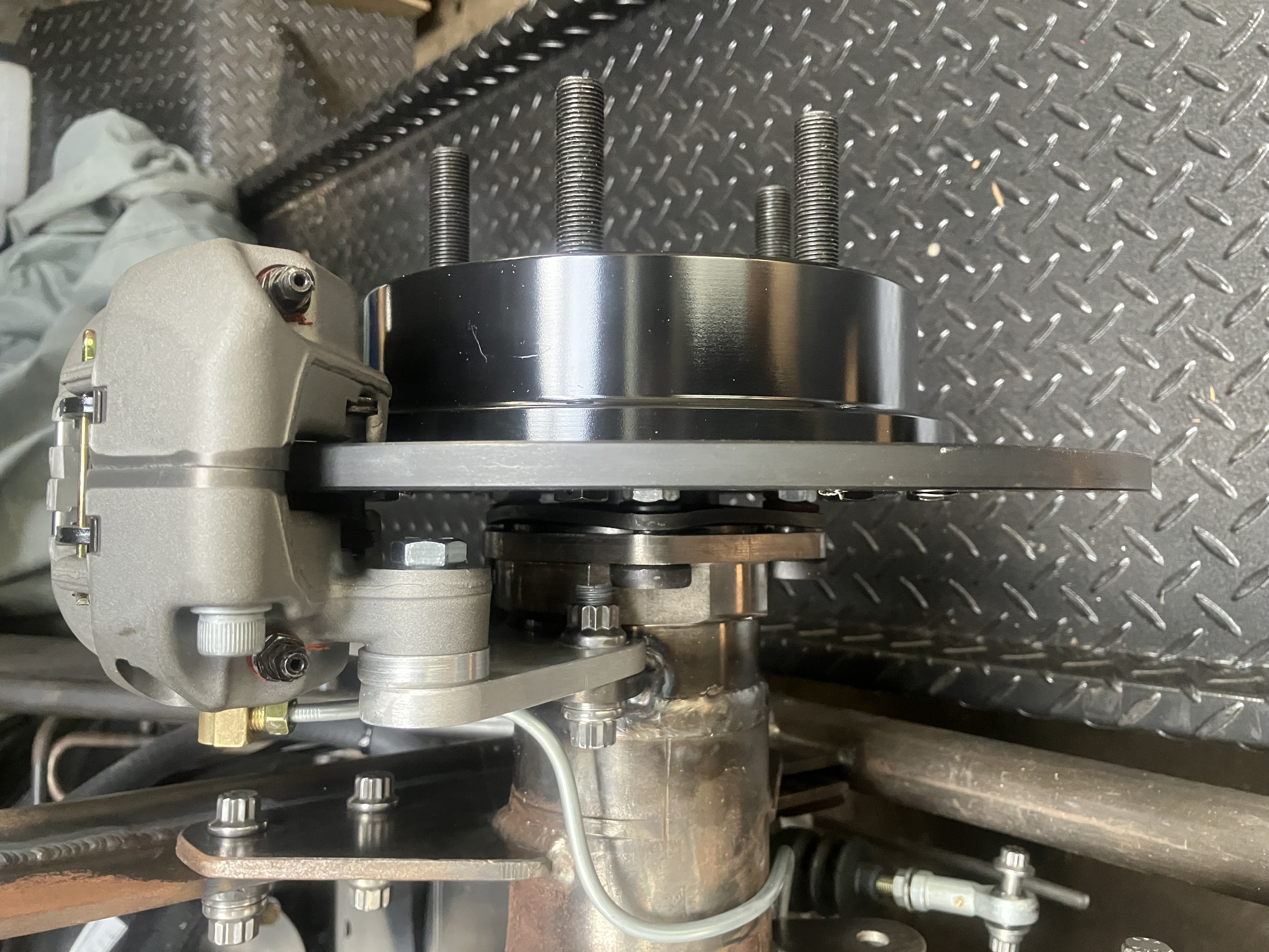

There’s no doubt this working away from home deal slows things down… took seven months to sort out the brakes. Diff was set up for VN/P/R/S Commodore rear calipers, but they wanted to sit an inch inside the bodywork. After much reverse engineering, and some neat fabrication by the chassis builder, the Willwood calipers now fit.

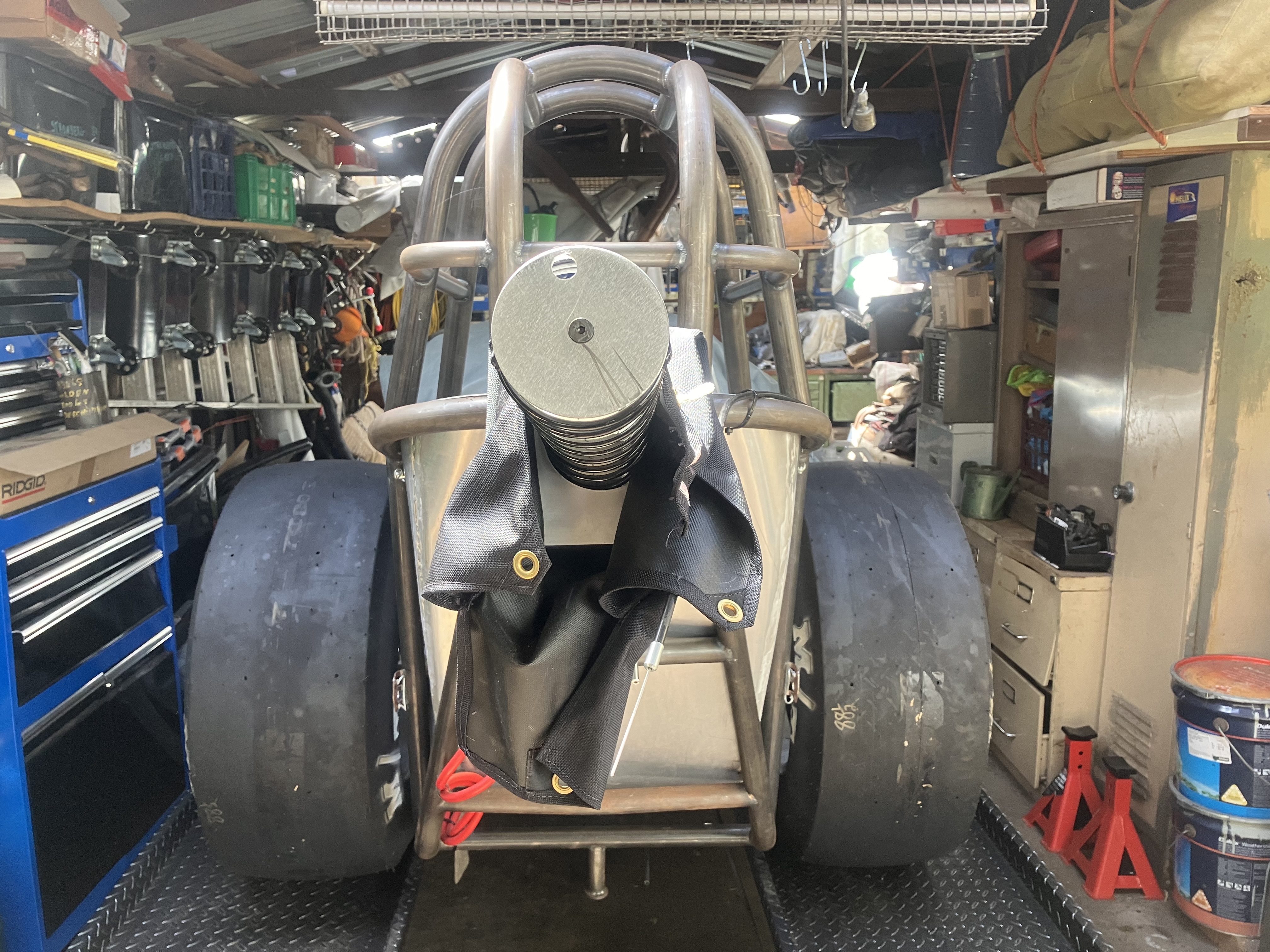

There is not much room between your ears and the burnout.
… or the diff and your vitals.
(note use of OSHA approved safety-socks).

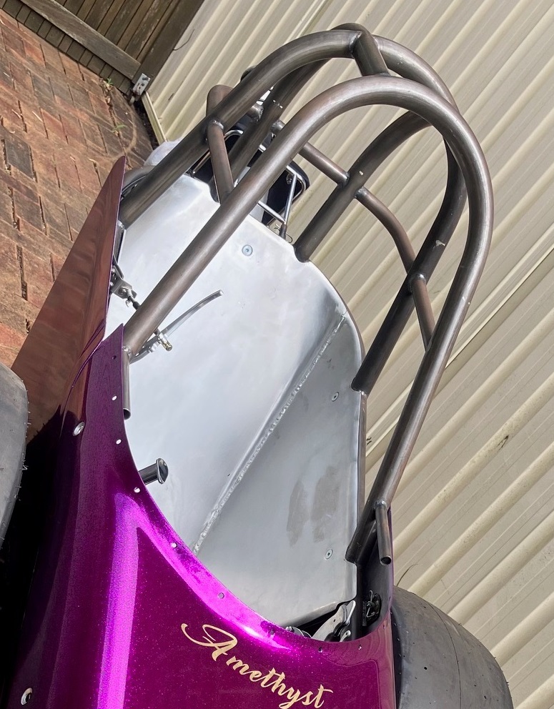

Got the wiring done, and instrument panel mocked up in ply (6mm offcuts from gasket shipping… to be replaced in 6mm ally).
Starter momentary switch on the left, steering butterfly, magneto kill switch and red fuel cutoff cable. If things go pear-shaped, your left hand holds onto the butterfly for dear life. Your right hand pulls the chute, pushes fuel off, turns off the magneto and checks undies.

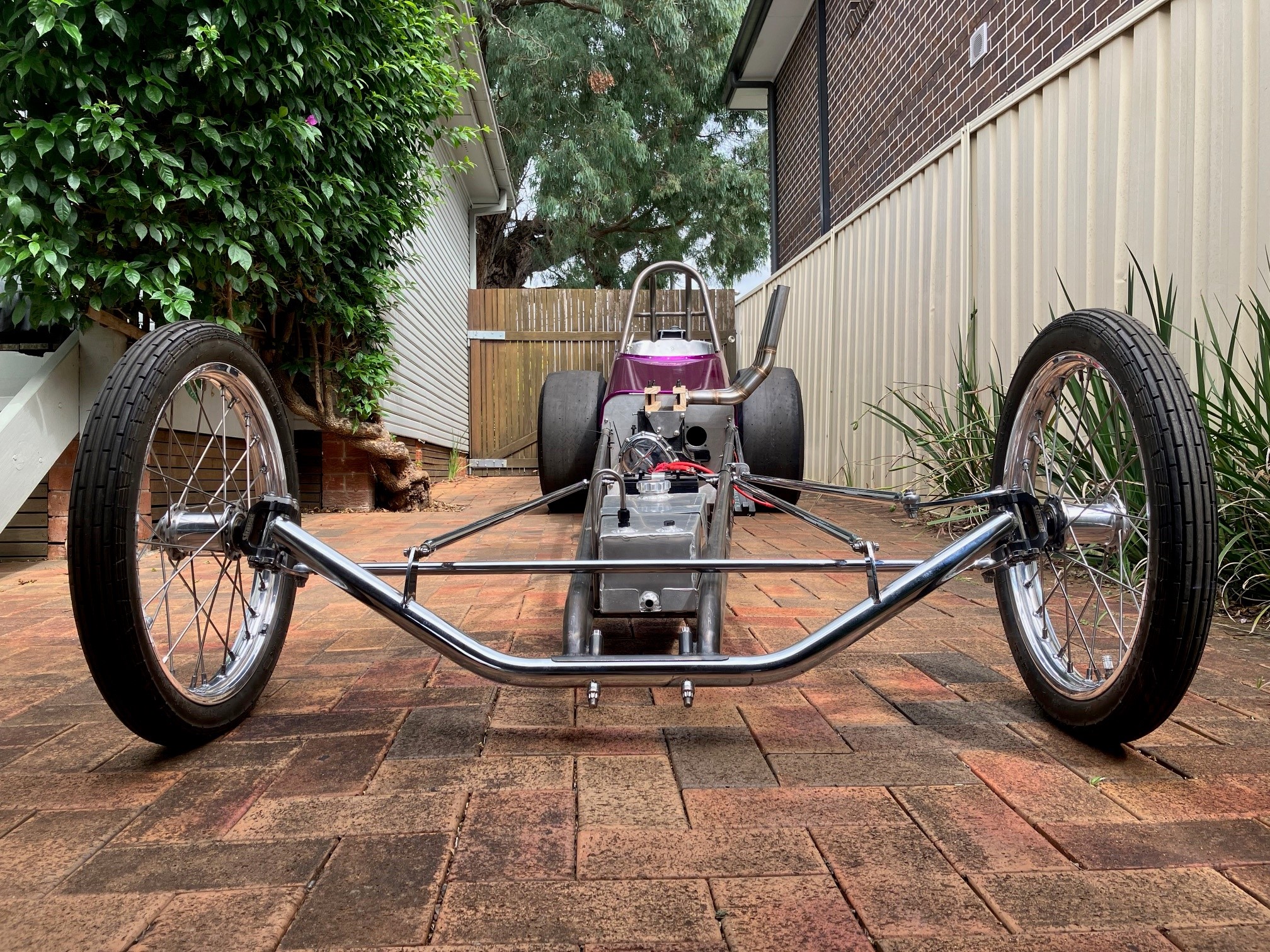

Those wheels look sick Harv

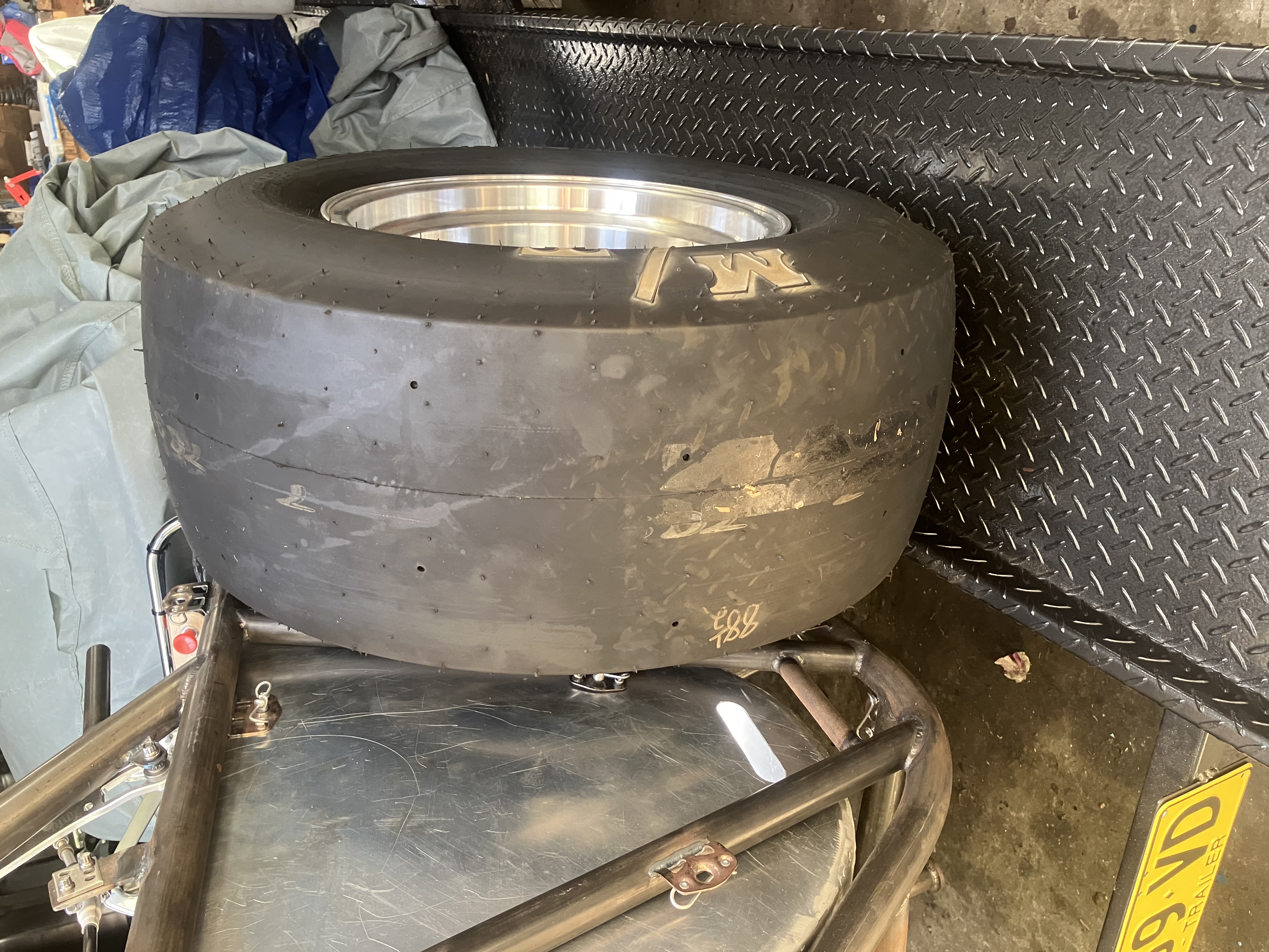

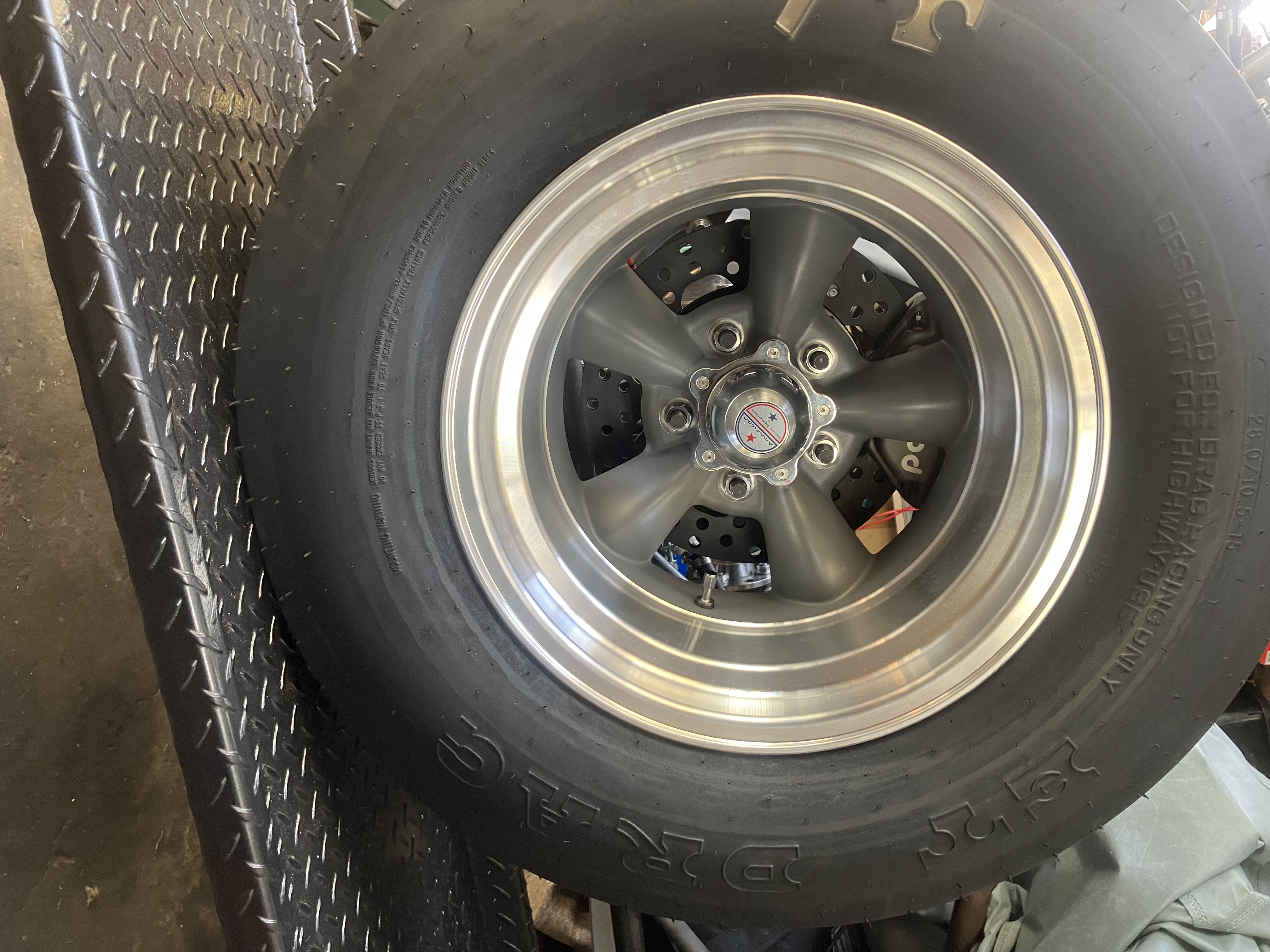

The only class I can run this thing in is Modified. It has a 10.99 second cut-off. I only know of one grey motor that has ever run that fast, and he only did it once (Dennis Paul in a FED, 10.83s). I effectively need to build and campaign the world's quickest grey.Blacky wrote: Sun Feb 11, 2024 10:32 pm Still spins me out that a grey powered anything needs a parachute![]()
We can rebuild him. We have the technology. We can make him better, than he was. Better, stronger, faster.
American Racing Torque-Thrust Ds, in 15x10. As close as I can get to a Halibrand without selling both kidneys. 10" may be a touch wide... I will have no problem with traction, but may well lift the nose of this thing. At some stage I want to put this thing on the dyno, but cannot run slicks on the rolling road. Will need to find some crappy 15", 16" or 17" wheels in Chev pattern to run radials on temporarily.

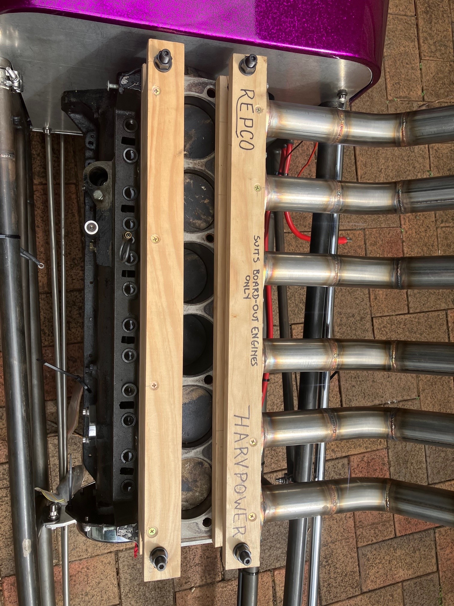

Needed to make some space in the driveway and shed for Number One Son's VL turbo upgrade project. It's an engine-out deal, so took the speedway engine off the stand and threw it into the FED. It's still sleeping, but will help with some layout work. FED took it's first roll on and off the tilt trailer. Need to be careful... the transmission sump clears, but not by much, and not if the trailer tilts a little back again.

I wooden trust that head if I were you Harv - it does knot look kosher

I should have measured the head before I sent it our for a freshen up... had to get one of the Taswegian lumpy humpy boys to measure up one for me. Wait until I tek-screw the blower on the other sideBlacky wrote: Tue Mar 05, 2024 9:28 am I wooden trust that head if I were you Harv - it does knot look kosher![]()
