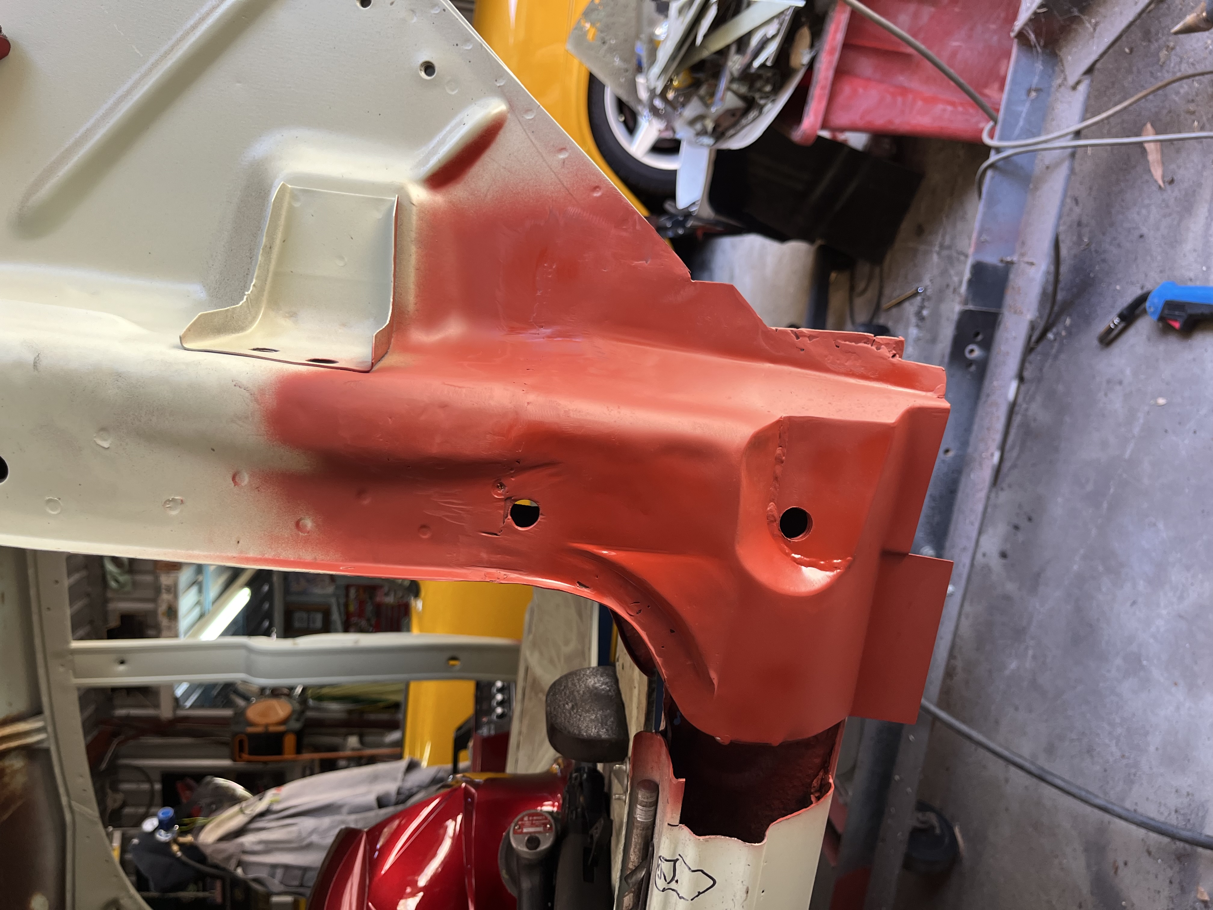

Driver side A pillar finished, have to trim a couple of places but basically sound

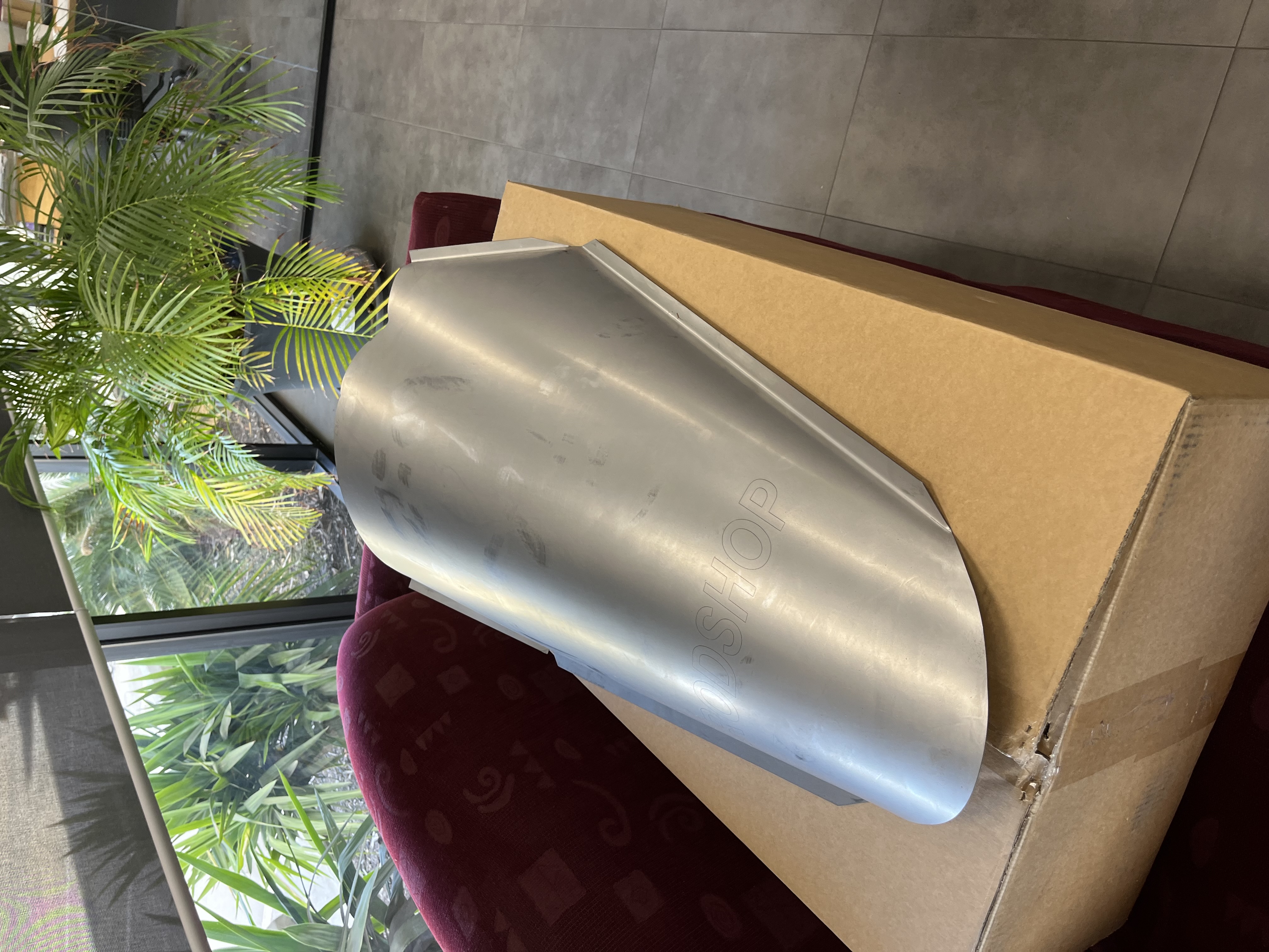

New floor hump just arrived, see how we go this weekend

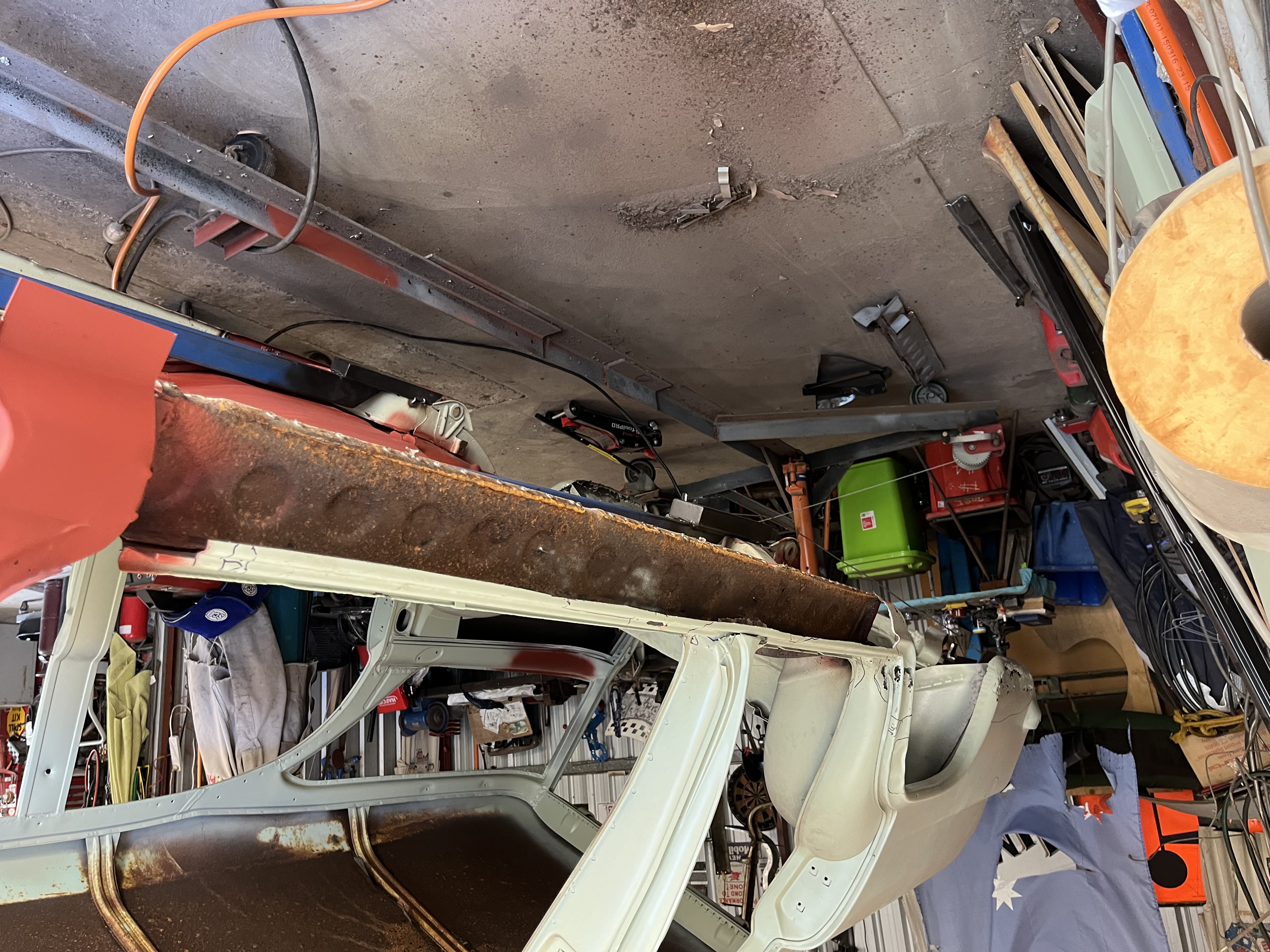

Does anybody dislike spot welds as much as I do :lol: :lol: unfortunately I think I still have lots more to deal with.
Removed the driver side outer sill just as bad as the passenger side but at least the inner is intact.
Posts: 11672
Re: Neil's FB Station Wagon
Not bad. Yeah fuching bastards. Not as bad if you are sacrificing one of the panels. I cut and twist off the sacrificial panel, then grind the remaining weld.

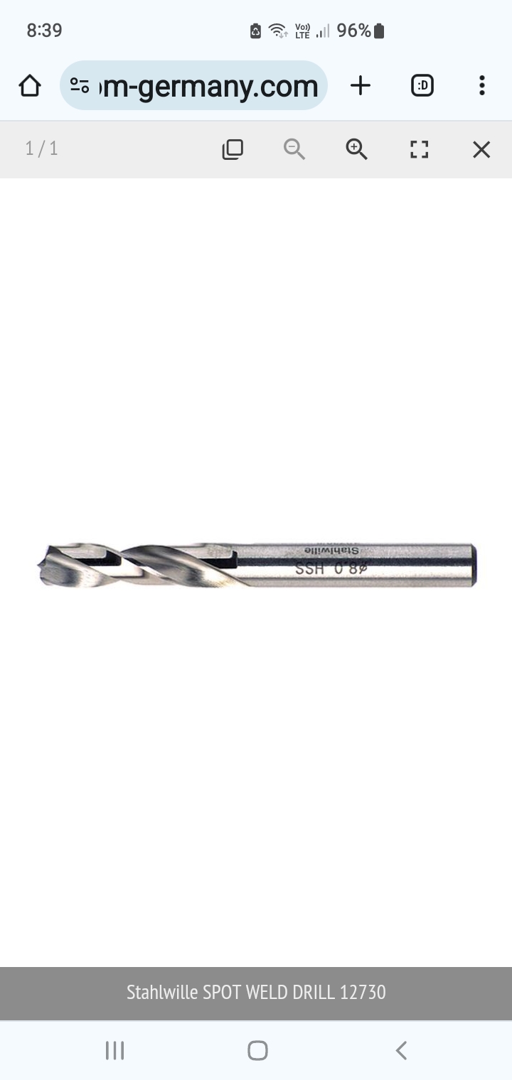

I use a German brand spot weld drill that is relatively easy (picture in Wilma build from memory). Cuts through tendons too.

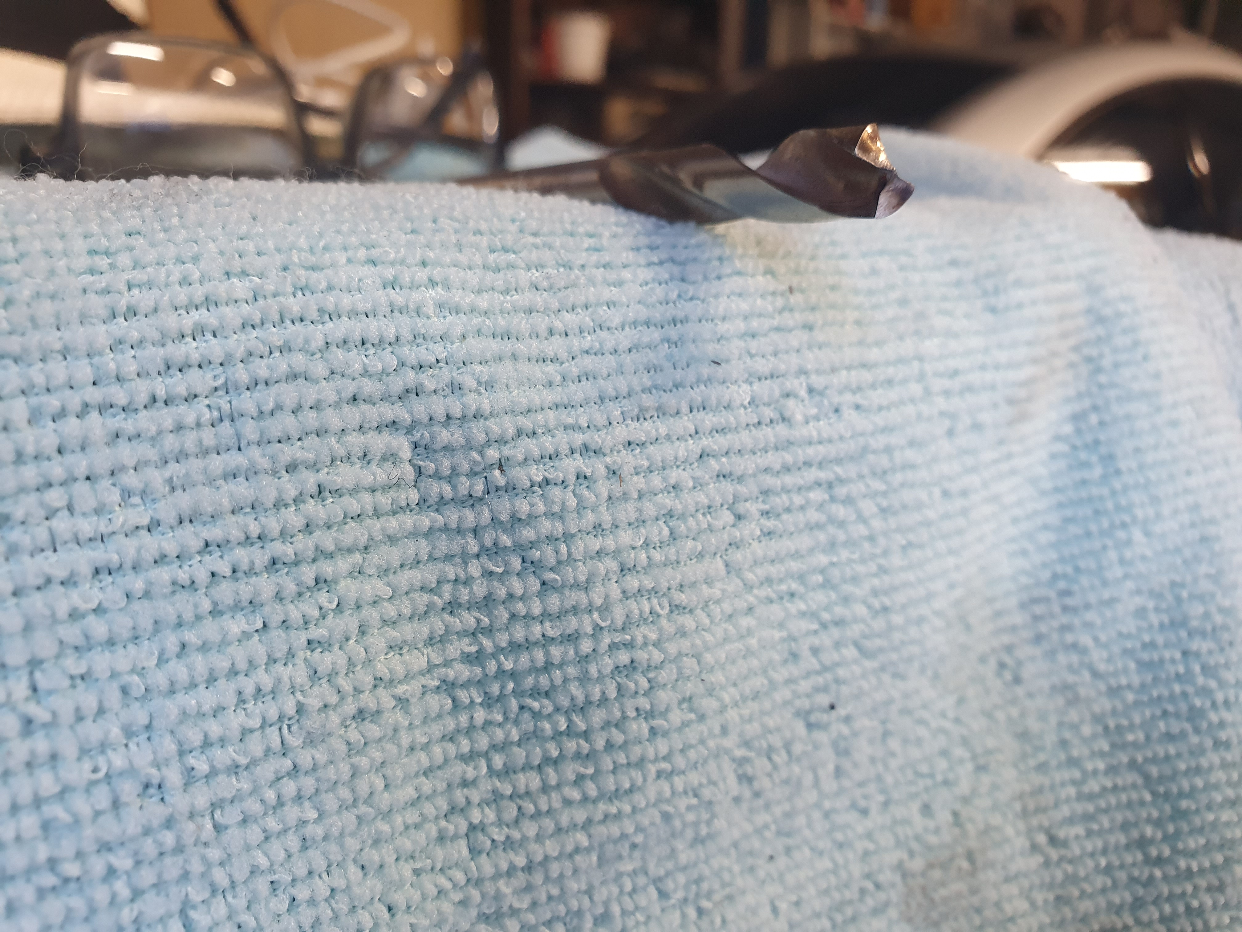

Post by funkyscooter »
Think my dill bit is a sutton - came in a two pack, so that pretty much sums up their faith in it.
Thanks Brett for your thoughts, going to invest in an air hammer me thinks.

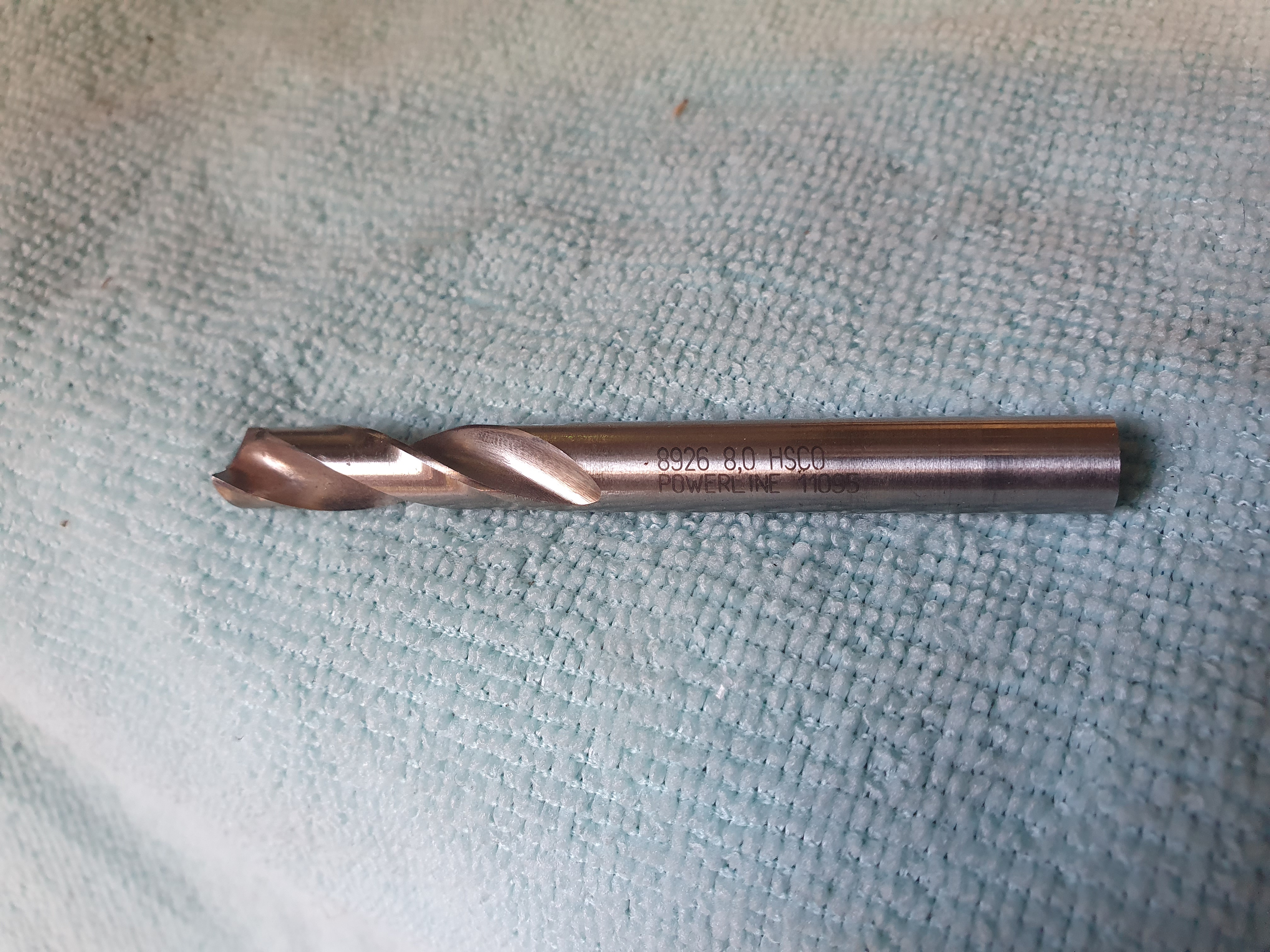

This is what I use. You can sharpen them again with a file. Powerline brand 8mm.
