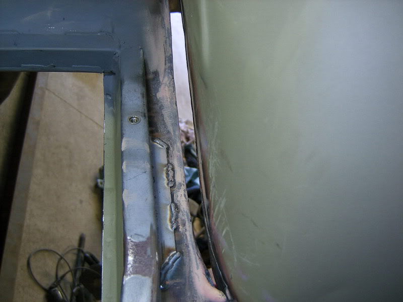

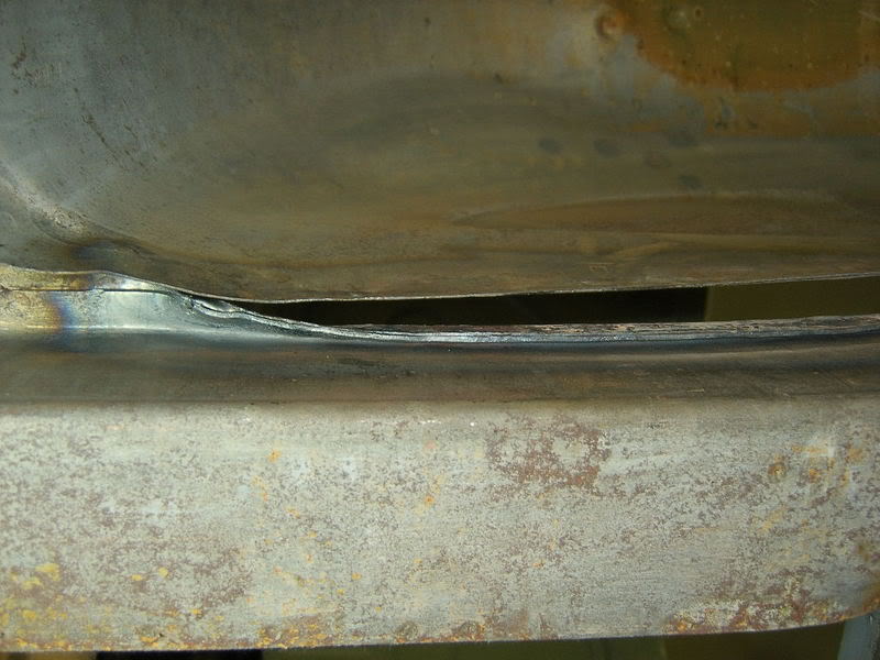

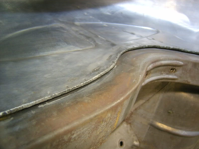

Good time for some mini tubs while rhe rear panels are off
Re: Red Rattler Revamp
Posted: Tue Feb 04, 2020 2:06 pm
mph wrote: Tue Feb 04, 2020 1:00 pm Good time for some mini tubs while rhe rear panels are off Image
already done sir 8) 8) just across to the rails
Posted: Tue Feb 04, 2020 2:10 pm
by mph
Was there any pics or details or to busy with the hammer.
Posted: Tue Feb 04, 2020 2:23 pm
no pics, while the diff was out I cut the strip between the rail and the inner out, belted it across and welded it back together again, pretty easy job did them in a night.
Posted: Tue Feb 04, 2020 3:03 pm
by mph
Are they double skinned inner gaurd with an air gap ?
Posted: Tue Feb 04, 2020 3:07 pm
no - not double skinned, once the cut is made the inner guard will push across to the rail , only gives you another half an inch or so
Posted: Tue Feb 04, 2020 5:44 pm
by mph
No complaints on gaining half an inch.
I'm intrigued would love to see this done close up or pics.
Posted: Tue Feb 04, 2020 5:47 pm
Blacky,
A lot of people seem to cut and shut the whole tub inner wall across, which is quite a bit more work. Seems to me your method be just as effective. As you say the gain is not great, although I've noticed that any rubbing tends to occur above the lip with body roll. Increasing clearance slightly beyond the rail could have some extra benefit.

by EK283
A picture tells a thousand words !!!!
