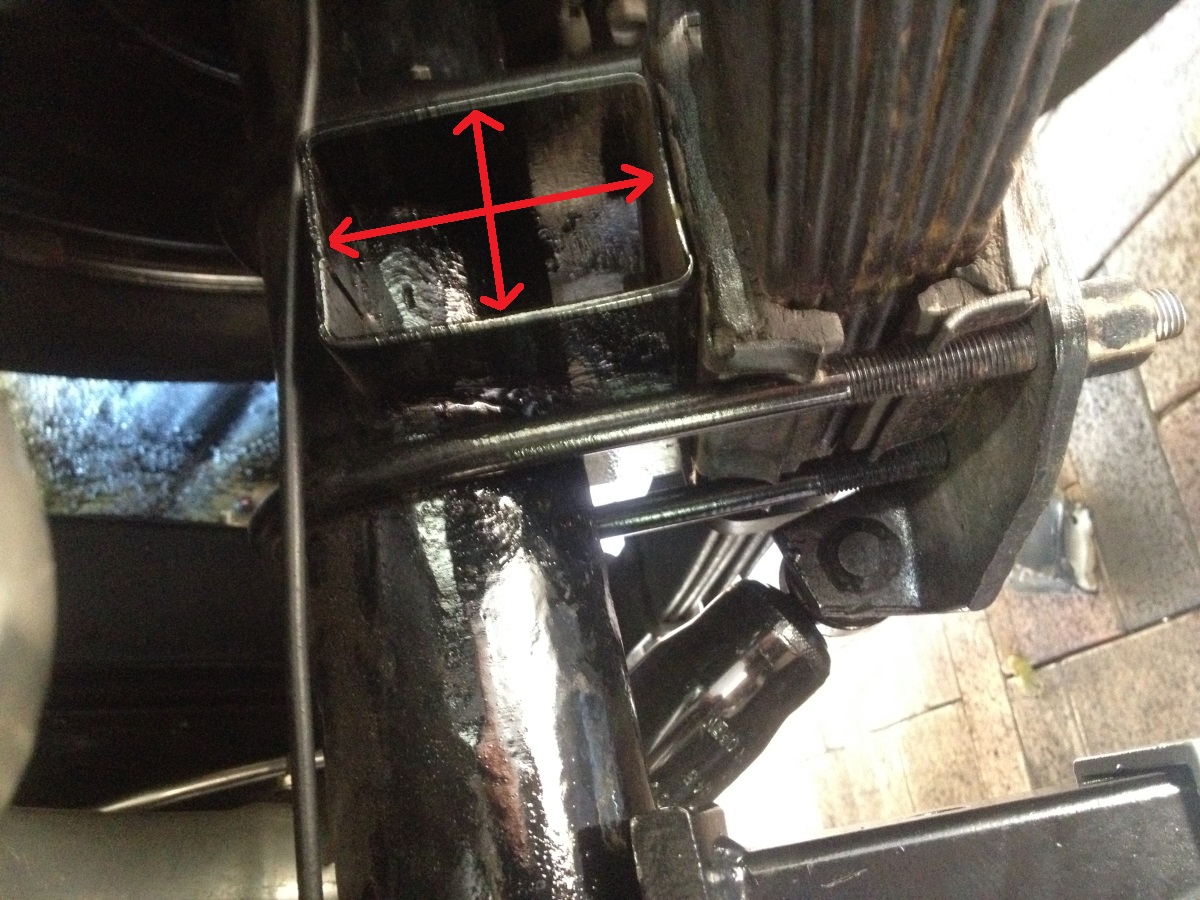

Managed to take a photo of the rear axle spring mounts. These were supplied by V6 Conversions when they narrowed the VP Commodore diff. I can now see why the engineer was not happy, and wanted them boxed by welding a rectangle of plate where the red arrows are. The RHS used for the spring mounts is only 1.6mm wall thickness, and likely to squirm quite a bit under load.

1.6 may have been ok if not for the 1 1/2" lowering incorporated in the mount. The extra height would require boxing even with 3mm. Looks like you have eight leaves in your springs. You won't be charging the speed bumps in the supermarket car park.

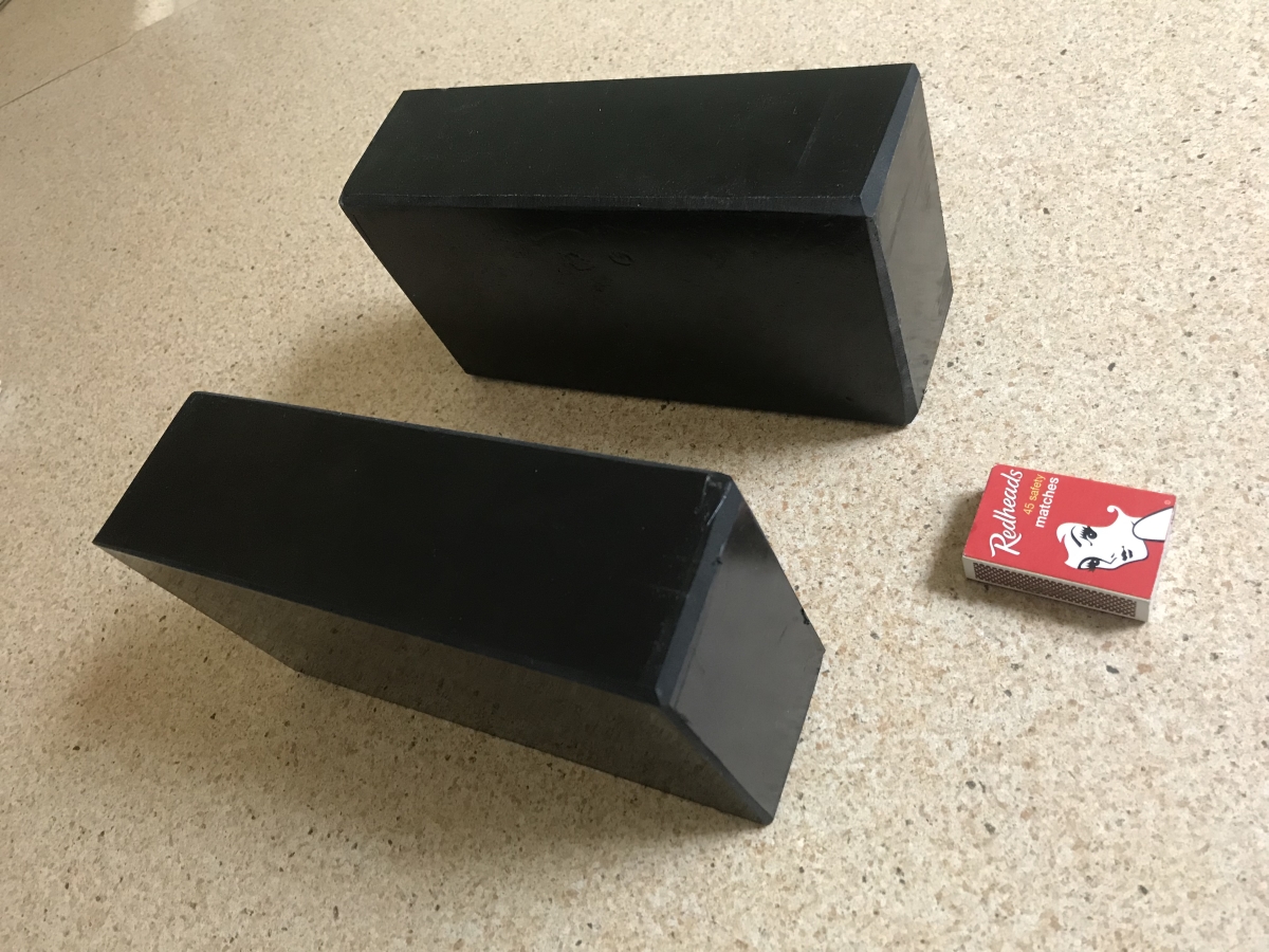

The material arrived for the rear bumpstops though.
Optimized-bump stops.JPG (720.07 KiB) Viewed 1161 times
I need to shift the bumpstops rearward, and need to limit suspension travel. Had a good conversation a few weeks back with Graham White Urethane, who consults for Whiteline Suspension. Plan is to replace the factory rubber stops/plates with polyurethane blocks. Attach the blocks using bolts and washers, recessed into the blocks. Will have to curve the bottom surface of the blocks to match the subframe arch. Graham cast me up some blocks. The height is good, though I have erred on the side of caution with the length - easier to cut some off than buy new blocks.

see how you go with the urethane Harv but they may be as rough as guts if you hit them often - I run Timbren bumpstops on my 4x4 as they are a progressive compound and allow the axle to slow before coming to sudden stop.

Graham was similarly worried that the urethane can be a little harsh. The drama I have is that I need to provide an absolute suspension limit (to prevent the diff pumpkin coming through the floor). Too much squish, and the diff will bottom out - I need to be pretty confident of the maximum travel. Graham's recommendation was to trial the solid blocks, and if it is too harsh then to begin drilling relief holes in the blocks to allow some room to squish. Need to go gently adding holes though.

If you have to weld the diff saddles why don't you just weld on stop bump stop brackets as well, might safe you a whole lot of mucking around ?????

Thought about it, though the main drama is the need to restrict suspension travel. If I use bump stop brackets, I still can't use the standard rubber bump stops, as they let the diff travel too far (i.e. they are too short). I could sit spacer plates underneath the original bump stops, or make new rubbers (with urethane), or make the weld-on brackets 4" thick, but figured that it would be just as easy to change the mounting slightly with the urethane blocks.

You need to know how much your bump stops compress also as even the harsh holden bumps will compress more than you think under a bump load - having only 10mm difference between diff to floor and axle tube to bump would mean you will have contact at some point I reckon as 10mm for rubber compression is not much at all. - I would be putting some rubber on the floor to dampen any impact - something with a soft compression rather than stiff
Maybe some airbags on top of the hangers would both improve your ride and give you more control over travel.
