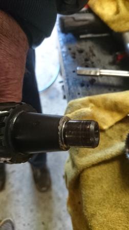

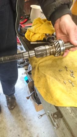

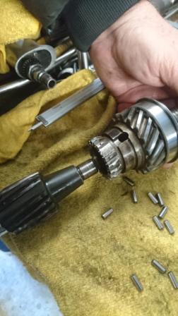

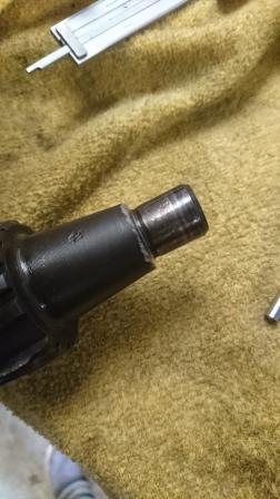

Out again. Stripped box down and not happy. Needle rollers between Main and input shaft have failed (Brinelled). Both shafts are stuffed.
NOS mainshaft I have looks to be EJ/EH as is too long by an inch. Now scrounging 5 spare boxes. Pictures tomorrow.

Sounds exactly like what happened to mine Craig - apparently there are a few bearing kits out there that are close but not quite the right size and have been sold off as EK. Cost me a main shaft as well.

Well its all back in today and running. Scrounged a good mainshaft from a spare box. Interestingly I thought I'd start with checking later boxes first thinking they had done less work. Both "B" serial number boxes were damaged much the same way. My "L" number box was in good nick. So to me it seems it could have load related or bad parts that caused the failure. I have to say that the rollers are in a bad spot as they would see very little oil due to being stuck inside the input shaft and having only two holes to allow some splash to get in the area. The shafts also sit above the oil level which wouldn't help.
While it was out I decided to run it with the side plate off to see why I was having a bit of oil leakge from the draft tube. My thought was oil was being sprayed up from No2 conrod squirter via the oil return hole above the camshaft. Not much oil appeared in the area. Did a small mod to the side plate to allow a little better oil drainage behind the baffle plate. Hope fully thats it.
Wally I measured up the old rollers and some originals and I could see much difference although I'd reckon the failed ones had worn a bit )apart from the brinelling. I guess and extra .001 in diameter on each roller would add up over all 13 of them. Not much room for error there.
