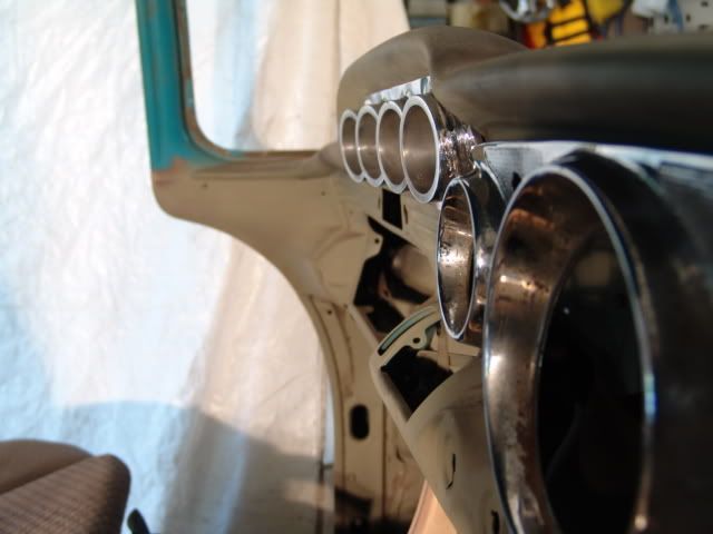

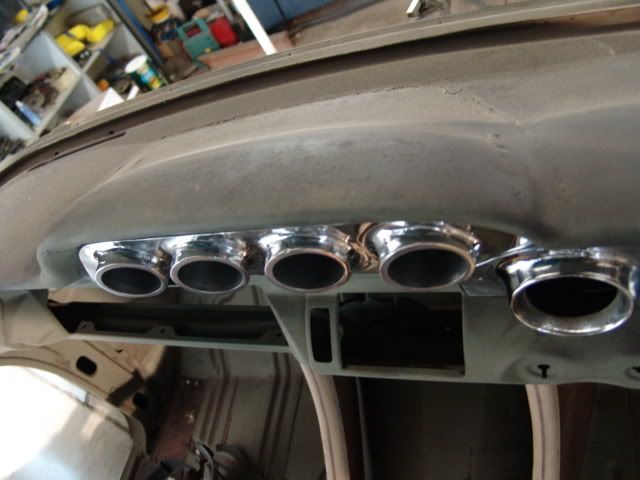

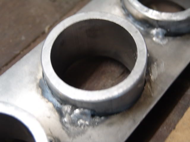

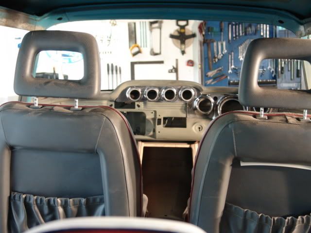

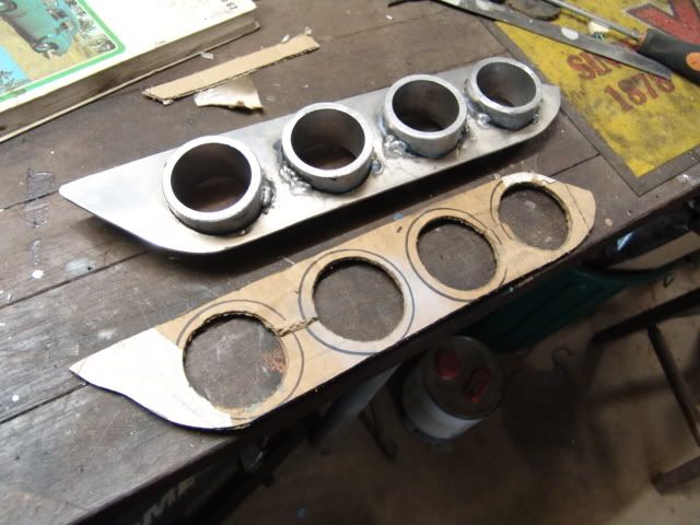

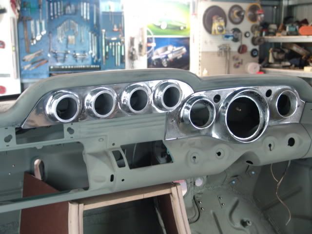

Here is the update on the dash mod...... I used aluminium, 4mm plate and 63.5mm x 6.5mm alloy tube (cut to 40mm lengths). Firstly I marked and drilled the holes in the 4mm plate the cut and welded the 40mm lengths of tube in place prior to cutting the plate to shape, this helps reduce twist and buckling in the alloy plate as aluminium has a bit of a mind of its own. Very happy with the way it polished up, used the Jabsco buff and the "green" polish stick.
Tubes tacked in place.
Fully welded and polished.
I tried to make it look "original fitment", pretty happy with the way it turned out ...... needs a bit more polishing as there are still some marks in it that don't show up in the photos.

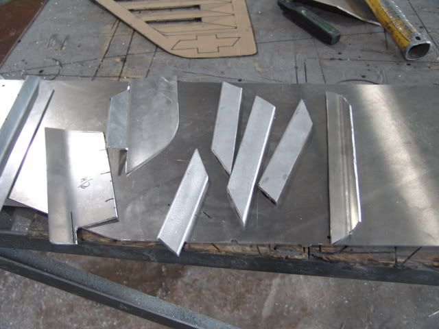

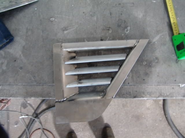

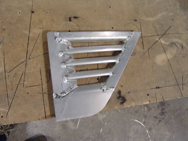

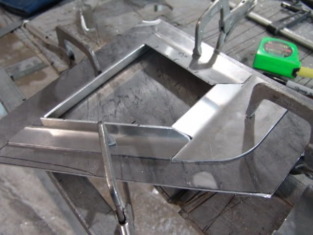

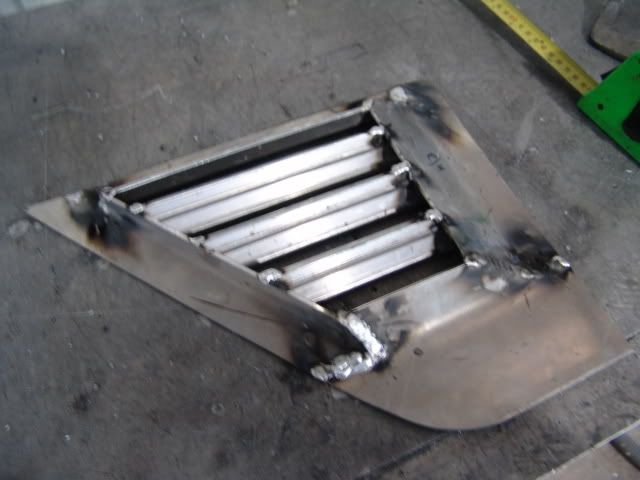

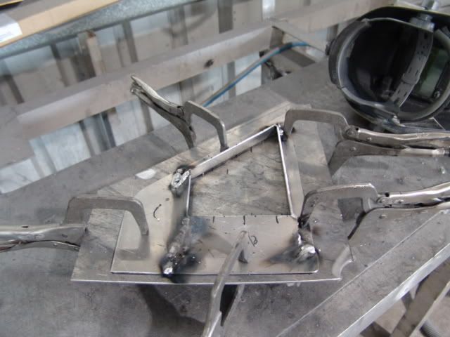

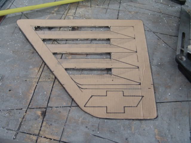

Had a go at the alloy guard flutes, still some finishing touches ie; trimming edges and final polish to do.
Did a rough mock up of it in the guard (spray can black paint :lol: ).
Cardboard template:
Parts cut and bent from 3mm plate
Clamped down to pre-curved 5mm plate to match the curve in the guard then tacked together:
Fit and tack weld angled flutes:
Turned over to check what it will look like :)
Fully weld:
Grind, sand, sand, grind and sand again and again:

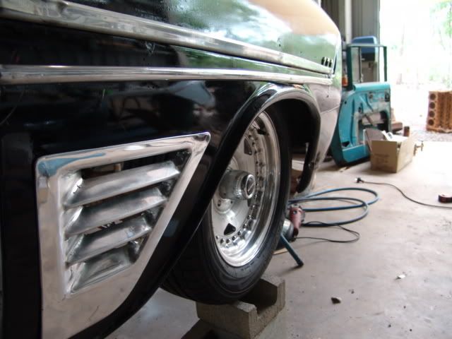

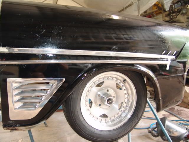

Polished and fitted into very rough mock up guard :oops:

Bloody great new years present!

man i was a bit worried when you said ally flutes . but after seeing them finished and in the guards, id have to say they set of the guards very nicely are you still putting in the bowtie at the bottom?

axeman wrote:man i was a bit worried when you said ally flutes . but after seeing them finished and in the guards, id have to say they set of the guards very nicely are you still putting in the bowtie at the bottom?
Cheers Axeman
Thanks Axeman, yes to the bowtie, just not decided on which way to do it .... my thoughts are:
1/ Bowtie badge in Black, red or gold.
2/ Bowtie Billet badge
3/ Bowtie engraved into flute and painted in the engraved area to match the car colour.
Originally was going to get "HOLDEN" engraved at the bottom and paint it.
Any other ideas/comments welcome.
