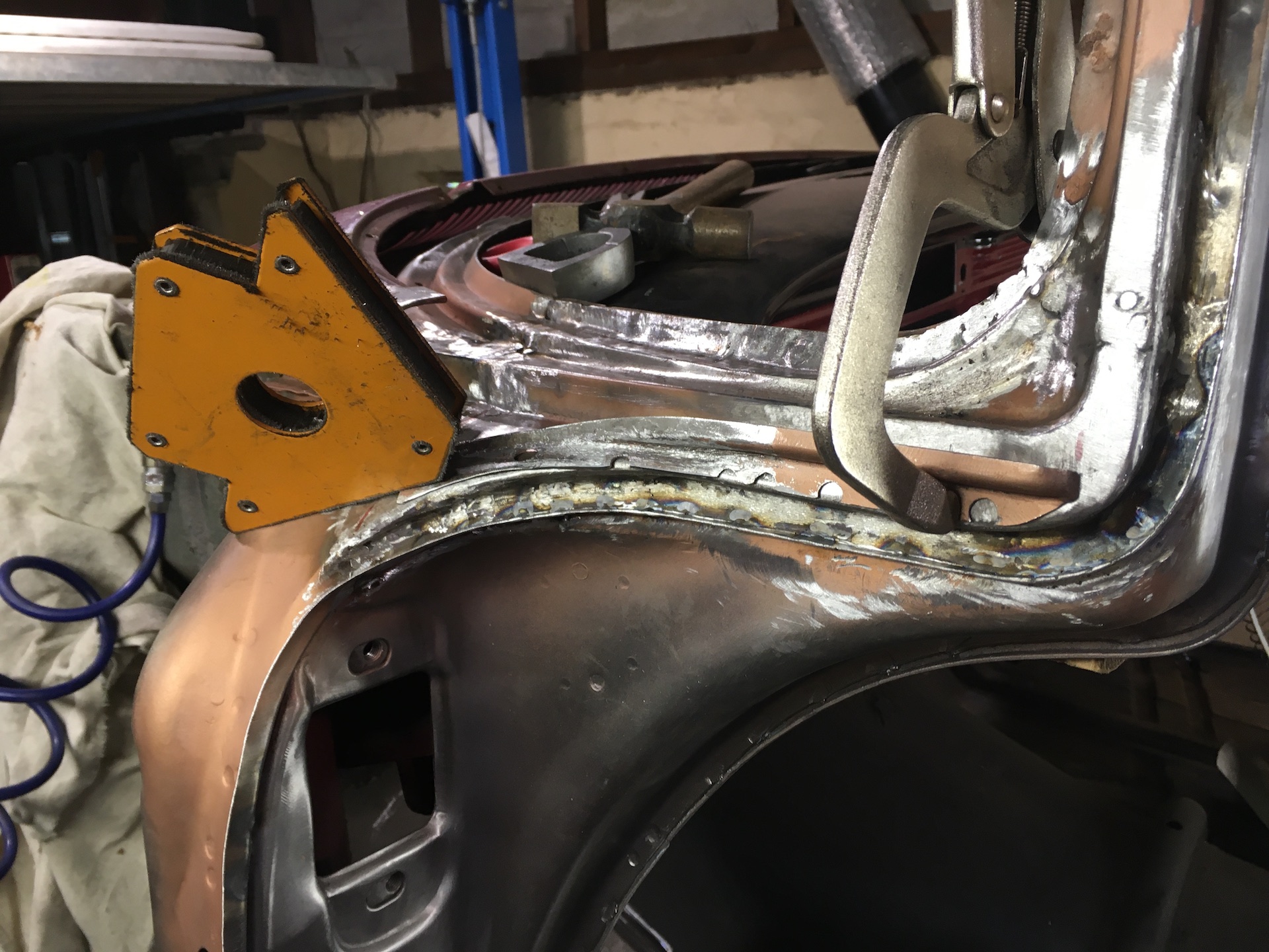

And got a bit more done.
Covered all the hidden areas in copper weld through primer. I’ll squirt cavity wax in there too later. Drilled more holes to plug weld this piece on. Image
Final checks to make sure it all lines up, don’t want to cock this up after how many hours have gone into it. Image
Tack all corners and start filling in the gaps. Had a small bit of copper in behind the gap to help bridge it with weldImage
And here’s the first round of welding done. Plug welding work really well on most holes. Grinding and welding etc to follow. ImageI’ve also got to re form and weld the channel for the door rubber. That won’t be fun.
Scott

Finally got around to finishing this little rust repair. I managed to re use the old 'gutter'. Was meant to be easy, but wasn't. Should have just fit as I copied the metal around it but clearly it was not. Much hammering, twisting and swearing. Gave up and threw it in the corner. Nearly cut it in two but decided to give it one more try yesterday and managed to find a line that matched the curve of the car (sort of). Its behind the passenger door so I'll never see it :wink34:
And so I started with this in November
And ended up here.
Haven't test fit the door. Fingers crossed. Gutter looks a little high.
Time to move on and find some more. Time flies.
