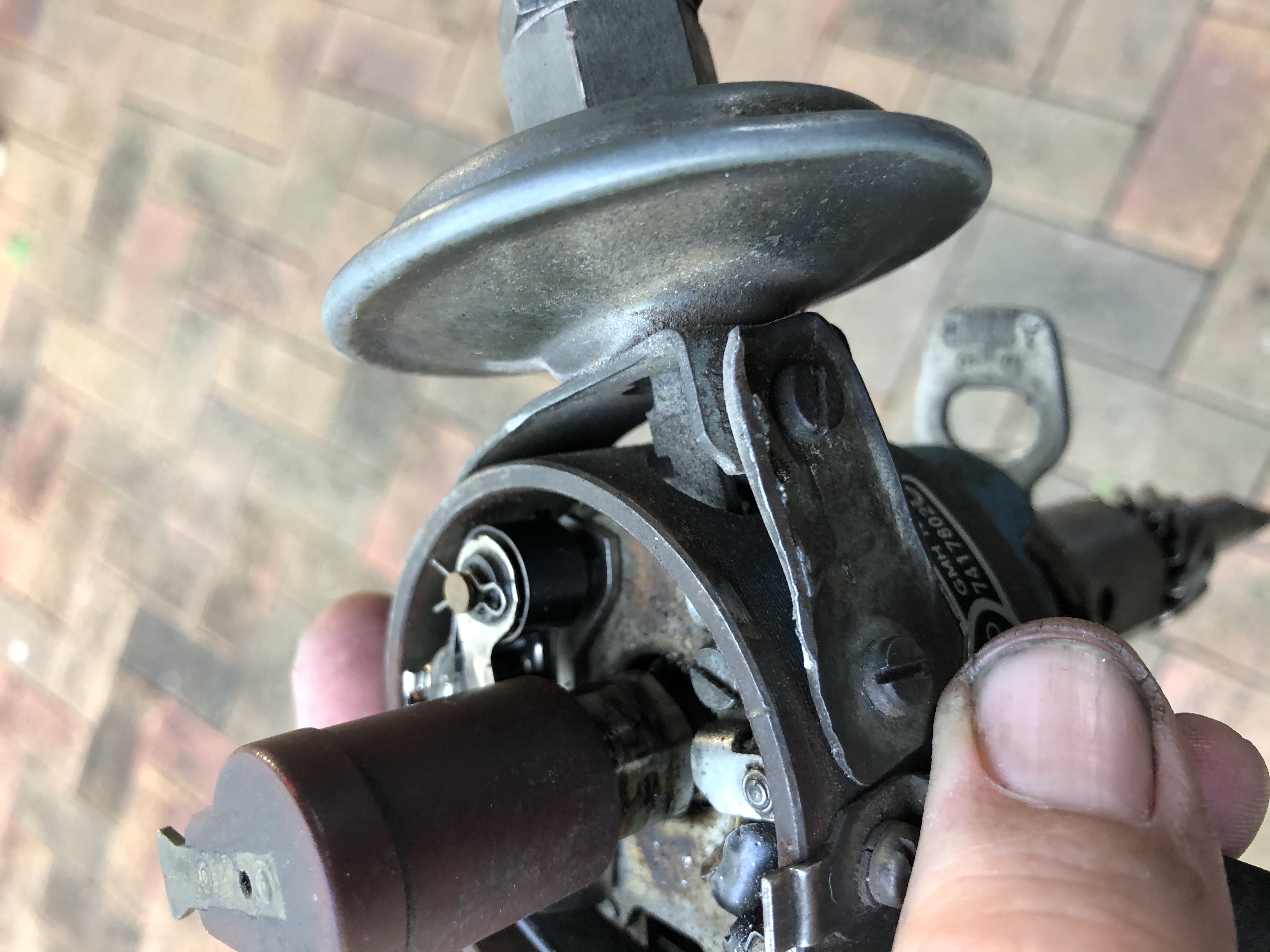

With the old dizzy out, Rob also spotted the likely cause of the rotor eating (queue CSI music.... Whoooo are you? Who who who who?ā€). The vac advance is a later unit, and had been cobbled on with homemade brackets. I’d never noticed the funky advance unit as it is similar in shape to my FB one.
One of the dodgy brackets was holding the cap askew... just, but just enough to flog out the rotor over time.

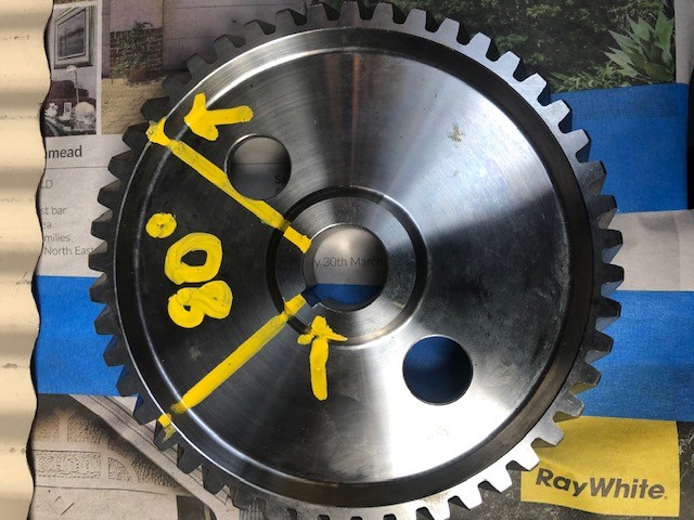

Took a lot closer look at the old fibre timing gear, and compared it to the new shiny steel one. Compared the location of the keyway with the dot. The nice shiny new one has about 80 degrees between the keyway and dot:
Should look like this.jpg (97.14 KiB) Viewed 5584 times

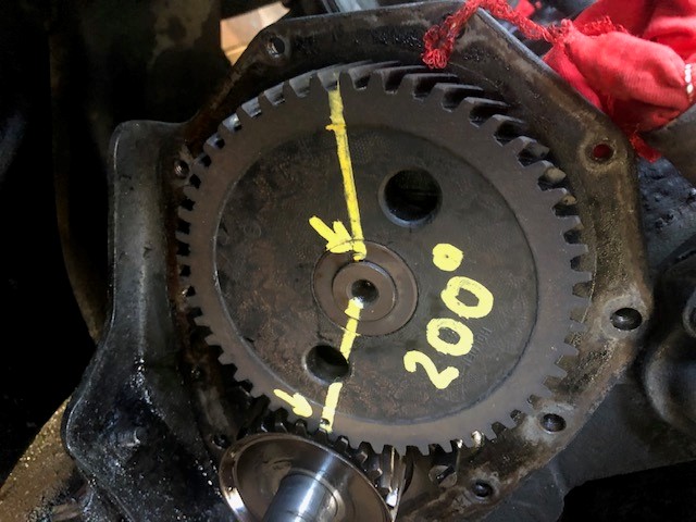

The old fibre gear has 200 degrees between the keyway and the dot:
Should not look like this.jpg (79.36 KiB) Viewed 5584 times
Eureka! Got you, you !@#$*$&. The old fibre timing gear has spun the fibre outer on the steel inner. It's spun it by 120 degrees... exactly what the previous work with paint markers and protactor showed the crank and valve train were out by. Double checked the keyway/dot on another steel timing gear (matched iron crank/cam set destined for the meth monster) and it agrees.
Theory now is that the timing gear was slipping around, and the slippage did not help the dizzy rotor (sudden load changes). The cap being on an angle would not have helped, and the rotor copped the damage. Unusual though. I've heard of the aluminium timing gears spinning on the steel inner, but not the fibre ones. Anyone seen this before?
