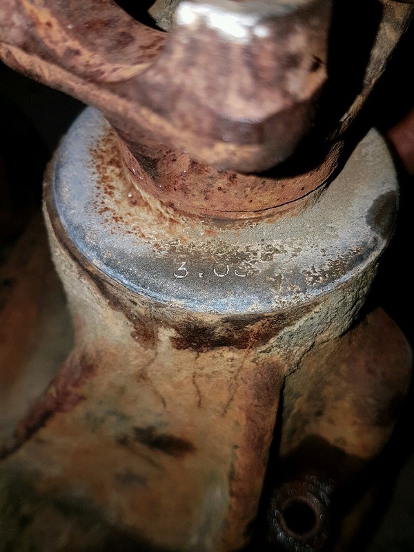

Any ideas how to remove this last nut on the hg bango diff , its spinning the nut and the thread rod together but not removing itself.

by ekstevo
I gather you haven't got a gas axe? If you have an oxy acetylene put the cutting torch on and blow it away .

by oz_ek
mph wrote:Image
I'm guessing your only interested in the diff centre?.....If so, I would cut open the back of the housing, find another nut of similar size to the knackered one, tack weld it on top of the knackered one, stick your hand in the newly cut hole, spin the bolt, put some more weld on the new nut, now put some weld on the bolt from the inside, done!
Re: WA fb special
Posted: Wed Jan 18, 2017 8:06 am
Centre punch the stud and drill out so the nut comes off would be tidiest. Hard part will be getting the bit aligned due to drill body fouling carrier and pinion flange.
This can happen when an early housing is converted to take later 3.08 or 2.78 carrier. A longer stud is required which can be achieved by means of inserting a bolt of the desired length but needs to be tack welded to the inside of the housing to prevent this problem.

by mph
Yea im just after the center out of it . the center put in the lj diff in my fb is no good.
With the tyres size, trimatic and 3.55 ratio i wasnt to keen on having a longer ratio, but are these diff centers with longer lower bolts 3.08. The diff from a 6cyl manual hg panel van
im going to try drill the nut off

by oz_ek
[quote="mph"]Yea im just after the center out of it . the center put in the lj diff in my fb is no good.
im going to try drill the nut off[/quote
The long bolt housing will have either a 3.08 or 2.78 centre, the ratio should be stamp on the pinion flange/cover.
Re: WA fb special
Posted: Wed Jan 18, 2017 10:27 pm
That ratio is probably out of a Torana auto so welcome home to your LJ housing. HG 6 van would have been 3:55 or 3:36 originally. I've run 3:08 behind 192 Aussie 4spd and 3.3 trimatic in my sedan very happily. EK and torana about the same weight and wheel size.
