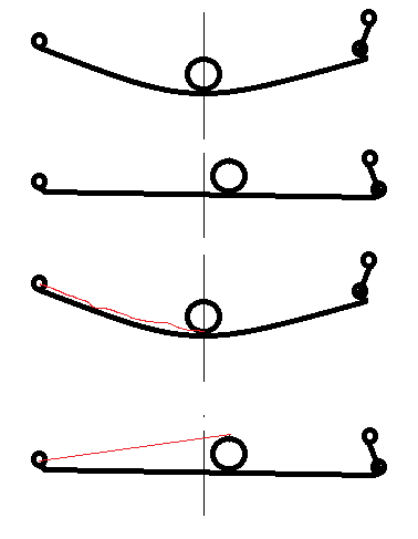

Not claiming to be an expert but I think it would be reasonable to assume that the front portion of the spring won’t deform significantly with changes in load. Therefore the contact points can be assumed to be in the same radial arc. In other words the distance from the front bush centre pin to the centre of plate and top of bump rubber should be the same. That’s my theory.

This is what I think happens (I could be wrong though).Errol62 wrote: Wed Oct 25, 2017 12:27 pmHarv

The spring has an eye one end (on the left in the diagrams below), and a shackle on the other (on the right). As you compress the spring (like the 2nd image), the spring straightens out. The distance along the top of the spring doesn't change. As the spring goes over a bump, it tries to flatten. To allow the curve to flatten, the shackle moves backwards, like in the 2nd image. This makes the diff move slightly backwards as the suspension goes over a bump.
To simulate this without mooshing the suspension, you run a length of string from the eye, along the top of the spring (like the red line in the 3rd image). This distance never changes. You then pull the spring tight, and arc it up (like in the 4th image, though wihout moving the suspension like the 4th image). The end of the string show you where the bottom of the diff will move to.
