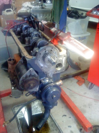

Pulled its pants and checked all bearings, clearances, and end float all ok.
