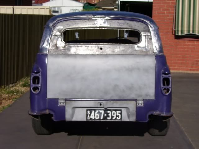

Last night we did the upper tailgate.
It had already been cut into three peices, &, an additional top section, &
two bottom of the window corner peices, come with the car.
So we had all the bits we needed.

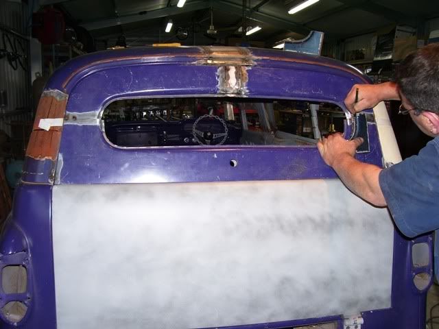

This shows the misalignment of the window on either side when chopped to fit.
Len is seen here eyeballing the additional corner bits that were added to the
bottom half, to realign the window frame

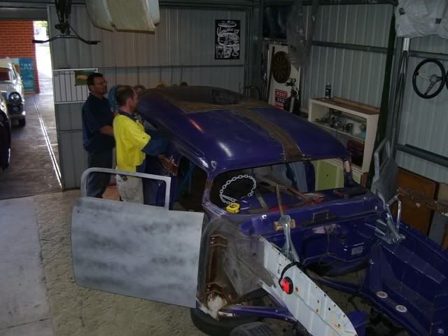

We got to a point in the roof where it wasn't behaveing how Len liked it,
so he got onto the blower to his good mate Grant Robinson.
Grant is a whizz with sheet metal.
In three hours of dolly work, the roof is shaped & tight.
We have 3 roof bows propped under the roof skin for support.
These will all be widened and welded in next step.

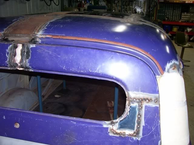

welds
Post by ekdave1962 »
hi there a neat job was looking through posts did u spot weld with mig then hammer oxy later ?
D
Yes Dave, plenty of mig spot welds help keep the panels flat to each other. :wink:

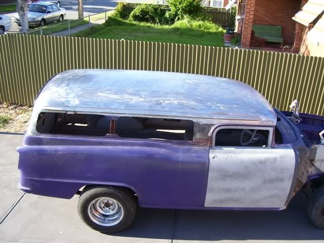

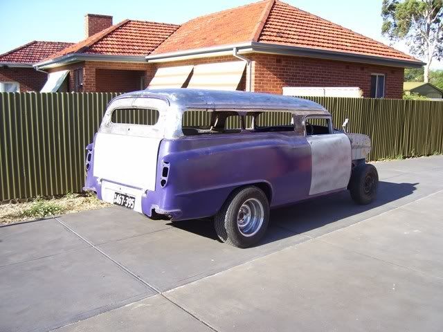

I have been a bit quiet on the updates lately,
but Len and I have still been moving along with it.
The roof panel has been fully welded, hammered into shape,
seams ground down, 3 hood bows modified & fitted,
its all been polished clean, & covered in metal conditioner.
We pushed the car out into the sun, & snapped of these pics for you all.
Thats Lens Early 50's Chev Custom parked out front, which is
a rolling testament to his skills in itself 8) 8) 8)
I consider myself very fortunate to have Len come and work on my humble holden,
which he's doing as a favour for a mutal friend of ours,
And he just loves doing it anyway.
There is the money shot.
How good does that look compared to the early build pics.
Len has done an awesome job to turn what was in the too hard basket,
back into a living breathing project. Thanks Len :wink:
