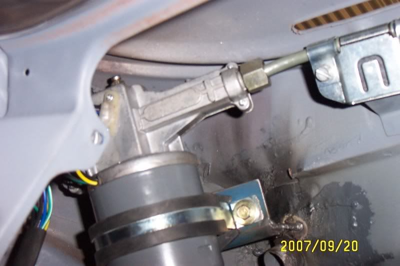

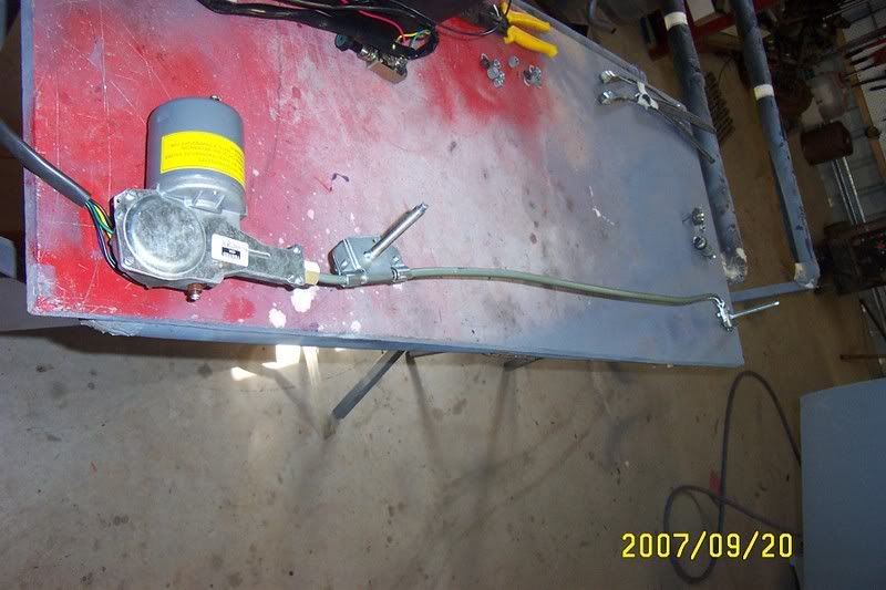

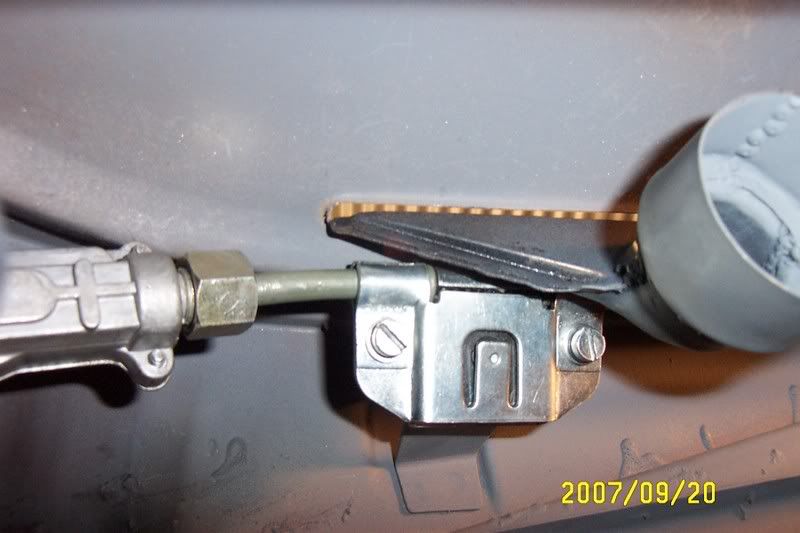

OK guys, 2 speed wipers are finally all sorted.
Here are the cable wiper pickies as promised.
The first one is how it all looks prior to being fitted to the car :D
(after half a dozen trial fits of corse) :evil:

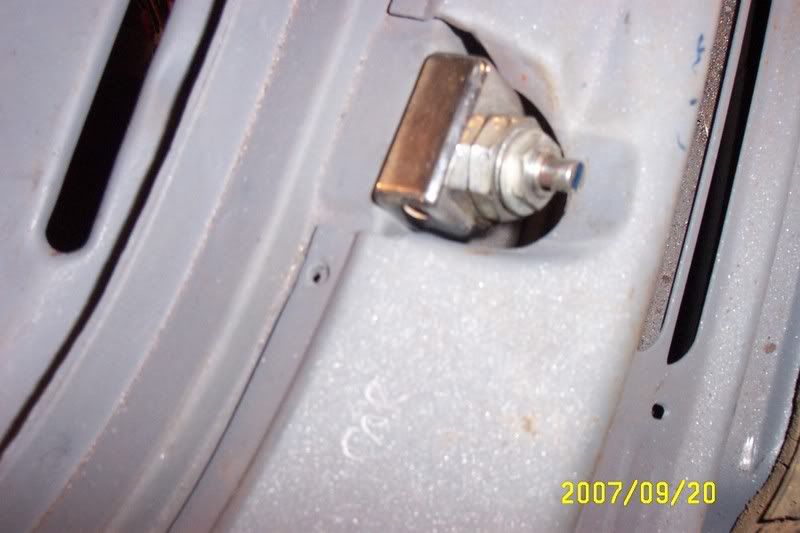

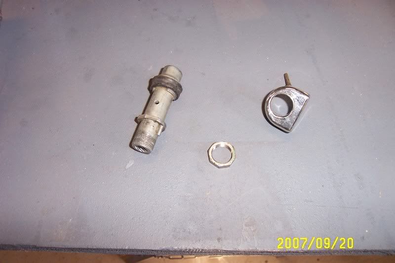

I used the original FB wiper pivot housing as a sleeve for the
new wiper shafts to go through. This just had to have the outer
bush removed and the inner part of the housing shortened. This
way they fit nicely into the original position and don't appear that
different to original, except for only having a smaller nut on the
outside as well as the original nut :wink:

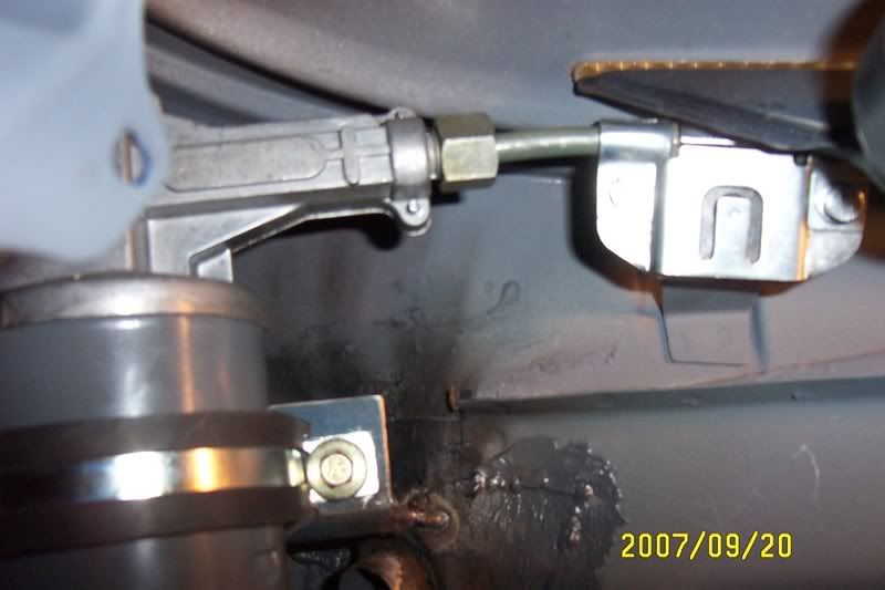

The wiper motor is mounted up under the dash on the passenger
side beside the glove box. This just needed a bracket welding on
for the motor to mount to.

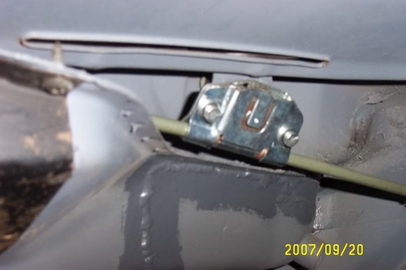

The pipe that links the left wiper to the right one runs over the top
of the plenum chamber where the fresh air comes into the car. This
was a tight fit :idea: and I ended up having to lift the center of the top
of the dash a fly shit (about 3 to 4 mm). Looking at the top of the dash
you can't even tell its been lifted.
All in all it was pretty easy, :D the kit comes with all wiring and switch,
so all you have to do is hook up power and earth. The pipes that
the flex cable runs through just have to be shortenen and reflanged
to suit the length you need.
O yeh, I did have to do a small modification to the demist ducts as
they also were a bit tight. Nothing a hit with the grinder in a few places didn't fix.
Next and last to fit up is seatbelts.
Mal
Malcolm W.

Mal, is there adjustment with those wipers, or trial and error thing untill you get them working. Its such a neat looking setup I might go with that idea next time. Great job 8) 8) 8)
Regards John
Malcolm
Posts: 709
Location: Gympie
Progress
Post by Malcolm »
Hey John,
The wiper pivots themselves (where the wiper arm fits to) is a full threaded piece so you can adjust that in or out to where ever you want. The kit comes with 2 long tubes for the flex drive to run through, these have a flange on each end (same as a break pipe flange). These you just cut to the length you need and reflange the end you cut. The tube is alloy an easy to work with so you can bend it to where you want without any problems.
If you do it using the original wiper pivot body as a sleeve like I did its very easy. With these kits you can make the wipers work with an in ward sweep as per the original FB/EK or you can make them wipe to one side like EH/HR, just by turning on pivot body up side down (as per left and right pictures of mine).
I probably spent a week setting up the first 2 speed wiper motor that I was going to use from another car and getting the swing an timing right.
This just made it all to easy.
Malcolm W.
