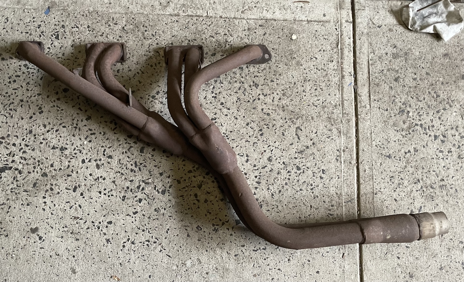

as they were handy I grabbed a picture of the extractors that were on my 202.
Quick measurement and conversion to inches - 1 3/8" primaries, 1 3/4 secondaries, 2" exhaust.
Search on google - Wildcat Headers (WILD022) seem to be close but have a slightly larger 1.5" primary. Then if you like to throw money at it there is Pacemaker PH5004 Kit EH-WB. Interesting too (well I thought it was as I have never really looked too deeply into tuned extractors), check out PH 5013 HK-HZ Red Motor Competition Header. It won't fit in a EK/FB engine bay, but those are some long primary pipes.

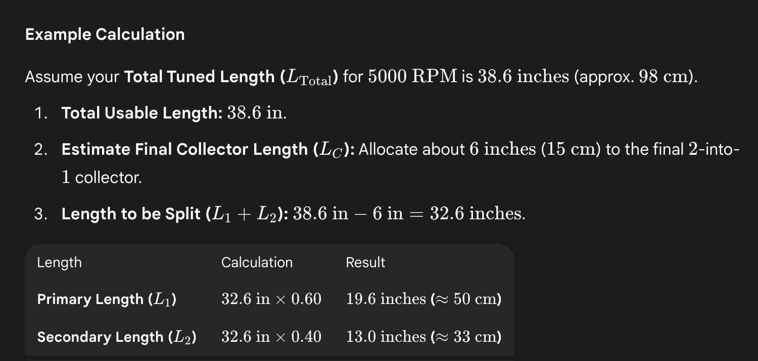

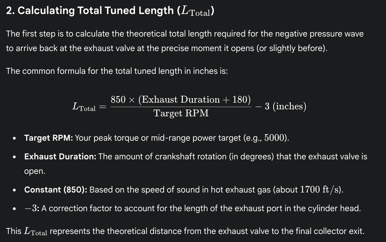

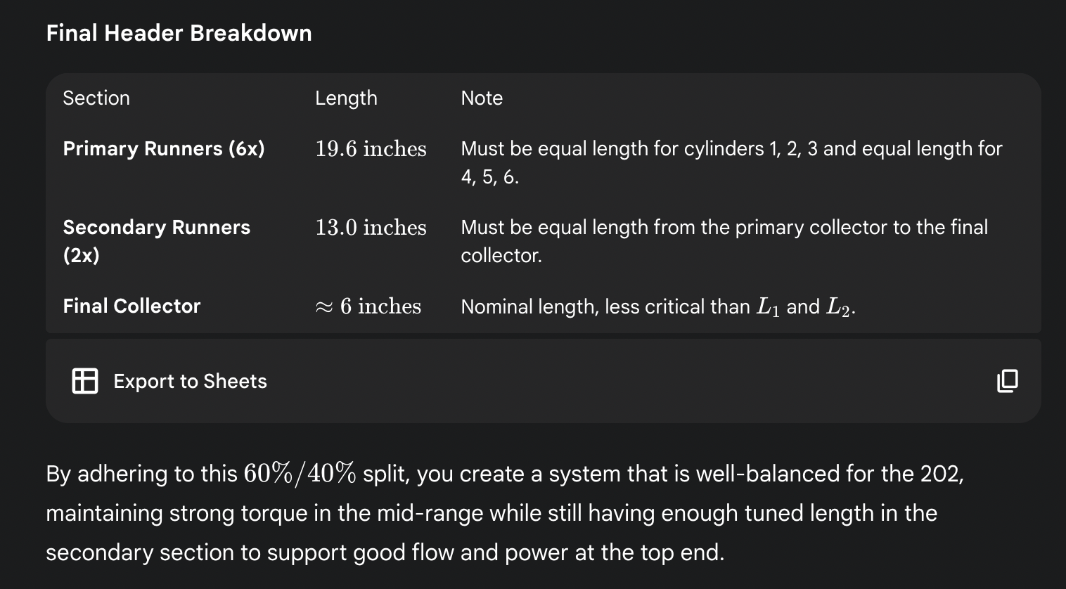

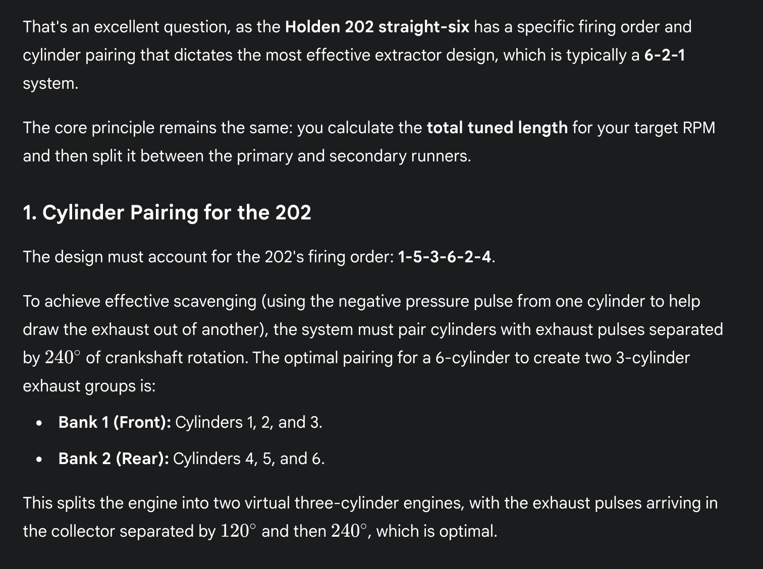

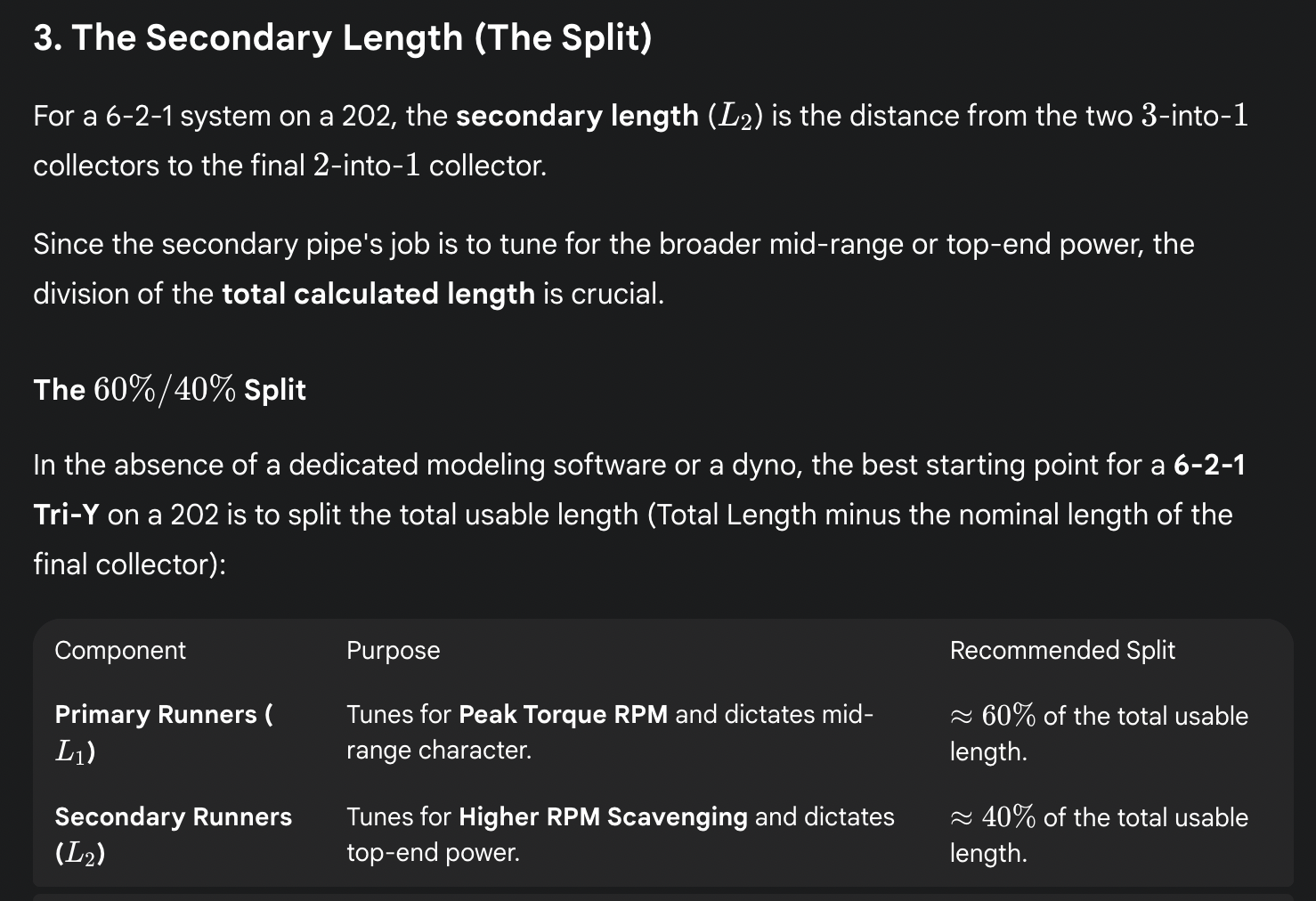

Errol62 wrote: Tue Oct 28, 2025 9:04 am I’ve seen a formula somewhere also, for the optimum length and size of the secondaries.
Asked Gemini and got the following. Have not verified the info with proper research, just sharing as it might jog memories and further the conversation.
