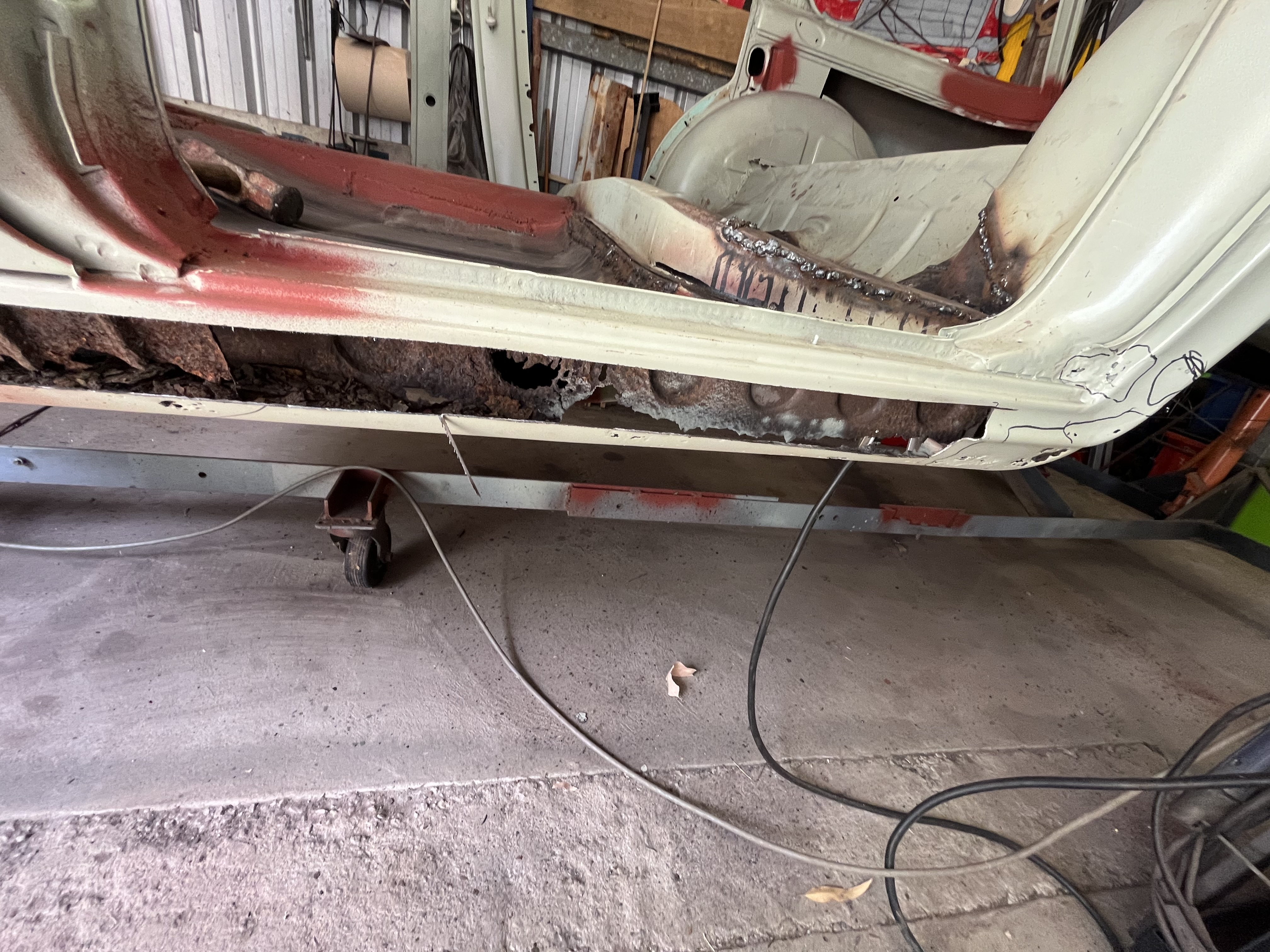

More metal worm removal this weekend :roll:
Opened up the passenger side sill, I knew I had to repair the inner sill under the back door and the outer sill on this side was probably not worth saving.
Plenty of rust and crap laying in there.
Cut away the rear section that I need to replace, I have a piece with the dimples in it to put back in there.
Cleaned the rest up and put some rust converter on .
More fun next weekend. :wtf: :wtf: :crazy:

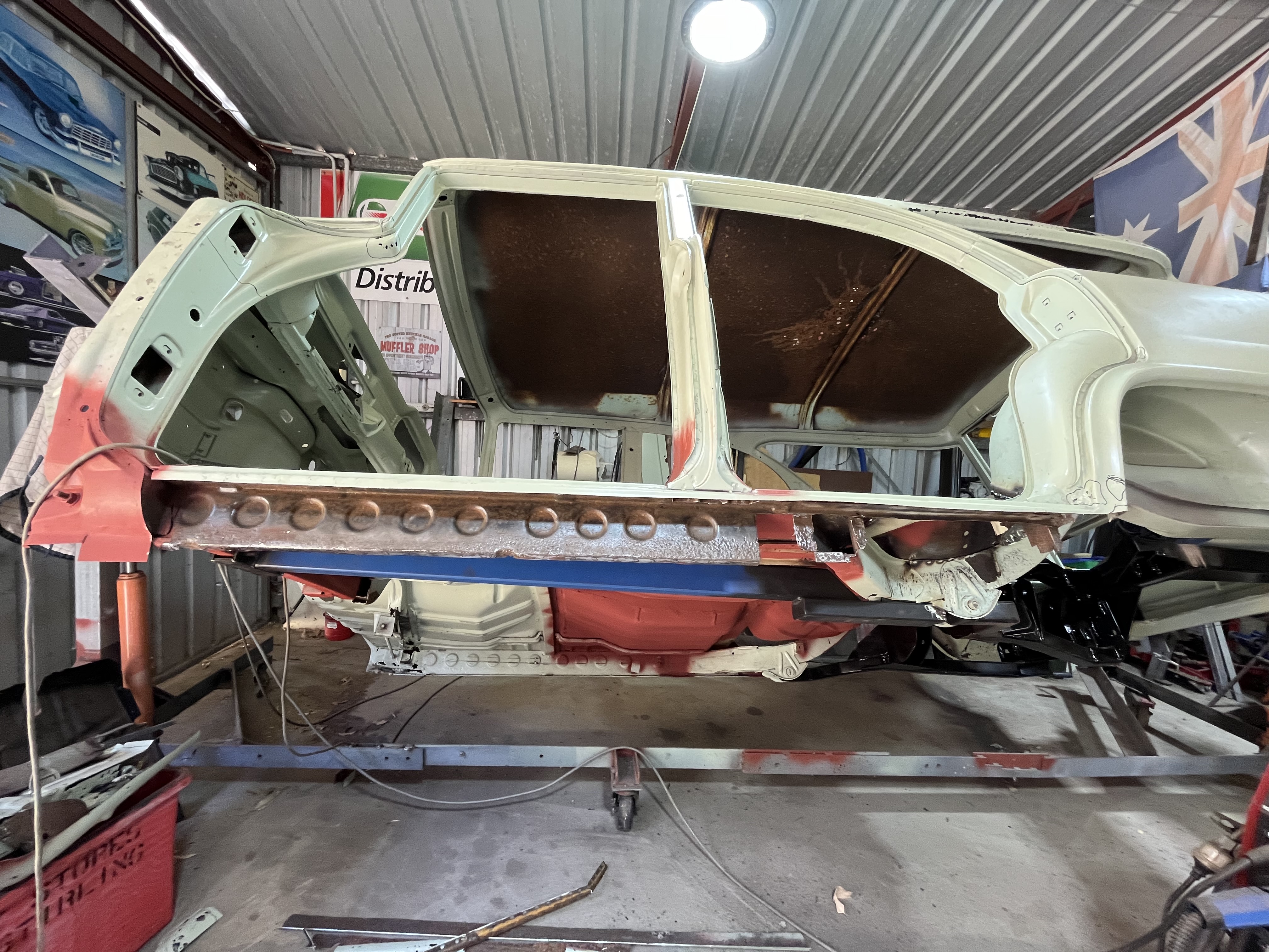

Finished the inner sill repair and chassis brace
