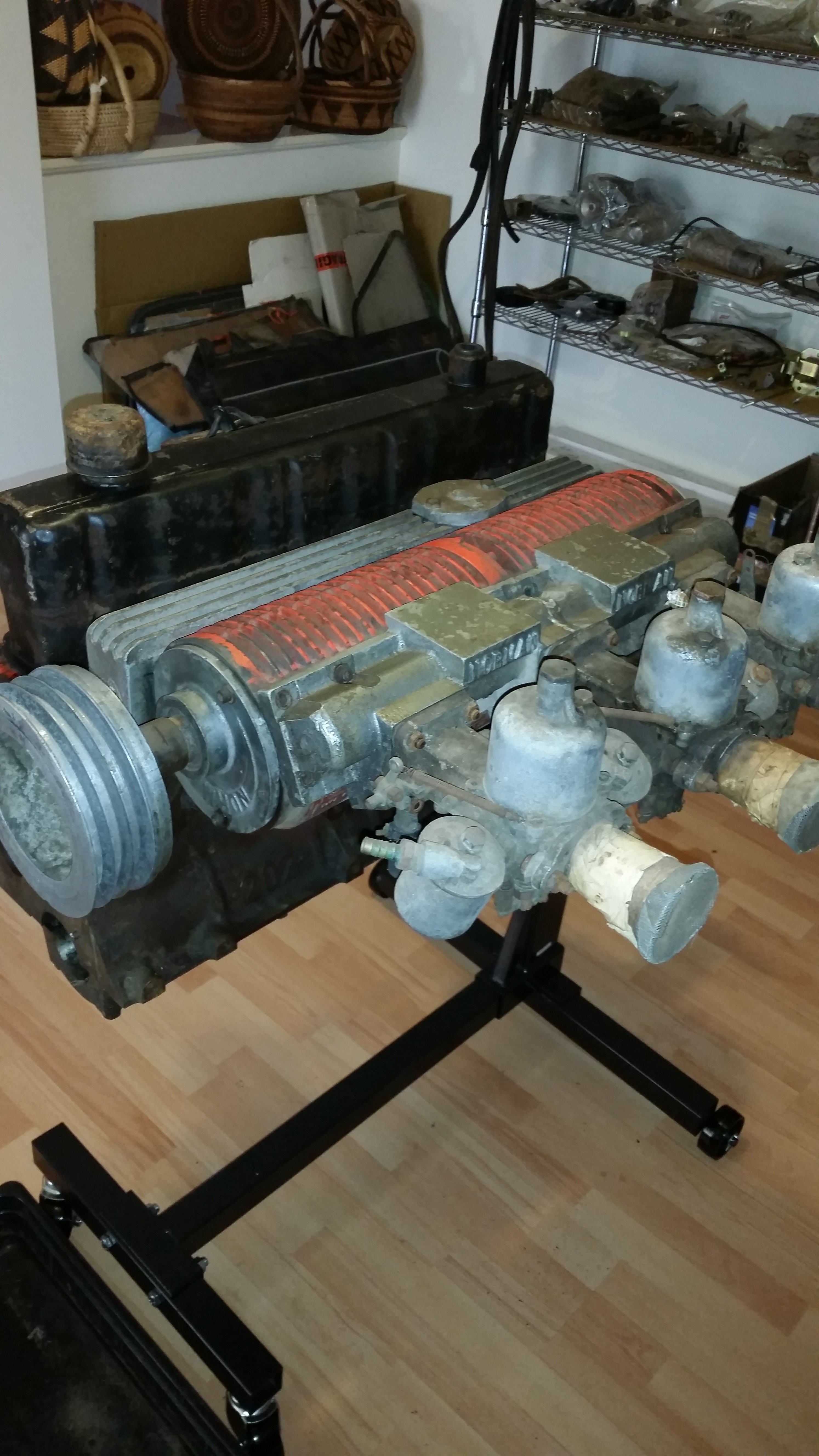

An interesting machine has appeared in recent weeks – one of Eldred’s Type 265 Normans. The machine was purchased by Peter from a mate in the late 70’s. The mate in turn had purchased the machine from a gentlemen west of Toowoomba, Queensland. The machine has seen some use, having wear on the belt tensioner pulley and some minor marking inside. The Type 265 has since sat idle, though Peter has been taking a look at it over recent weeks.
Front corner on stand.jpg (1.97 MiB) Viewed 6746 times
The Type 265 was manufactured by Eldred by bolting together two Type 65s. Peter’s machine is mounted on a red motor supercharger to cylinder head manifold. The carburetor to cylinder head manifolds are cast in two piece, and then welded together. The manifolds have bosses that can be milled/tapped to suit different carburetor combinations, either twin carbs or triples. It is possible that the configurations were
a) manifolds run separately (no welding), with one downdraught carburettor per supercharger bank, and
b) manifolds welded together, with three sidedraught carburetors into a common plenum.
Peter’s Type 265 is a water cooled unit, with the standard “Casting Number 22” cast into it. The serial number (535) is stamped under the front of the unit. This is the highest serial number I have seen on a Type 65. The supercharger weighs 118.4 pounds (less carburettors). The rotor is solid steel, weighing near 50 pounds on its own. The rotors bear two-piece vanes, 9.921" long (standard Type 65 vanes are 10”). The Norman is fitted with triple H6 SU carbies, though these were not on the unit when purchased. The unit has no relief valve.
This is a pretty unique unit - I know of only one other survivor (a Type 270), owned by Mike Norman.

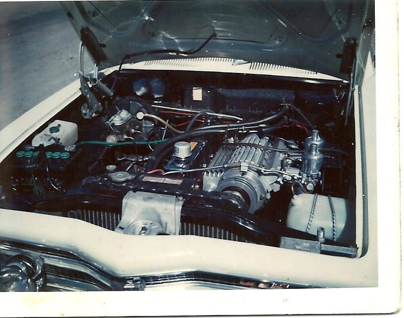

Richard Lock, based in Melbourne owned an LC GTR Torana, with a port and polished head, 20/60 cam and extractors. Richard contacted Eldred Norman to enquire about a supercharger to suit. Elded indicated that he had several people waiting for new units, though he did have one used unit (a Type 110 Lightweight which had seen service on his son Bill’s LC Torana) that he could sell. This is the same vehicle that Bill was punting around Australian race tracks that has been discussed in the thread above:
Richard agreed, and travelled to Noosa to have the supercharger fitted. During his visit, Richard took a ride in Eldred’s Norman-blown HD ute, watching the front end rise several inches as Eldred engaged the supercharger clutch from inside the cabin. The Type 110 supercharger came complete with twin 1¾” SU carburettors and a water injection system, and was run at 9psi boost. The water injection system was supplied by the plastic bottle seen in the passenger front end of the engine bay, and used vacuum to automatically draw water into a box on the SU’s via brass nozzles. The supercharger’s twin SUs would not fit under the Torana’s bonnet, and a hole needed to be cut. Richard drove the completed car back to Melbourne, terrorising local GT Falcon owners for a number of years. The car made the occasional run at Calder Park, returning a time around 15.3 seconds. The car was taken to the Firth Motors workshop at Queens Avenue, Auburn (Melbourne) for a tune. Harry was not impressed with the water injection, and disconnected it. The engine began to suffer from pinging, and ended up blowing the ring lands from the pistons around Christmas 1971. The GTR engine was rebuilt and swapped into Richard’s early Holden, with a new GM parts XU1 engine going into the Torana. The Type 110 sat for some time before being sold around in the early 2000’s to a gentleman from Werribee who was aiming to put it into his HR Holden.
