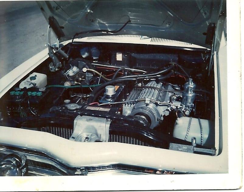

It is a very, very small world.
Richard Lock, based in Melbourne owned an LC GTR Torana, with a port and polished head, 20/60 cam and extractors. Richard contacted Eldred Norman to enquire about a supercharger to suit. Elded indicated that he had several people waiting for new units, though he did have one used unit (a Type 110 Lightweight which had seen service on his son Bill’s LC Torana) that he could sell. This is the same vehicle that Bill was punting around Australian race tracks that has been discussed in the thread above:
Richard agreed, and travelled to Noosa to have the supercharger fitted. During his visit, Richard took a ride in Eldred’s Norman-blown HD ute, watching the front end rise several inches as Eldred engaged the supercharger clutch from inside the cabin. The Type 110 supercharger came complete with twin 1¾” SU carburettors and a water injection system, and was run at 9psi boost. The water injection system was supplied by the plastic bottle seen in the passenger front end of the engine bay, and used vacuum to automatically draw water into a box on the SU’s via brass nozzles. The supercharger’s twin SUs would not fit under the Torana’s bonnet, and a hole needed to be cut. Richard drove the completed car back to Melbourne, terrorising local GT Falcon owners for a number of years. The car made the occasional run at Calder Park, returning a time around 15.3 seconds. The car was taken to the Firth Motors workshop at Queens Avenue, Auburn (Melbourne) for a tune. Harry was not impressed with the water injection, and disconnected it. The engine began to suffer from pinging, and ended up blowing the ring lands from the pistons around Christmas 1971. The GTR engine was rebuilt and swapped into Richard’s early Holden, with a new GM parts XU1 engine going into the Torana. The Type 110 sat for some time before being sold around in the early 2000’s to a gentleman from Werribee who was aiming to put it into his HR Holden.

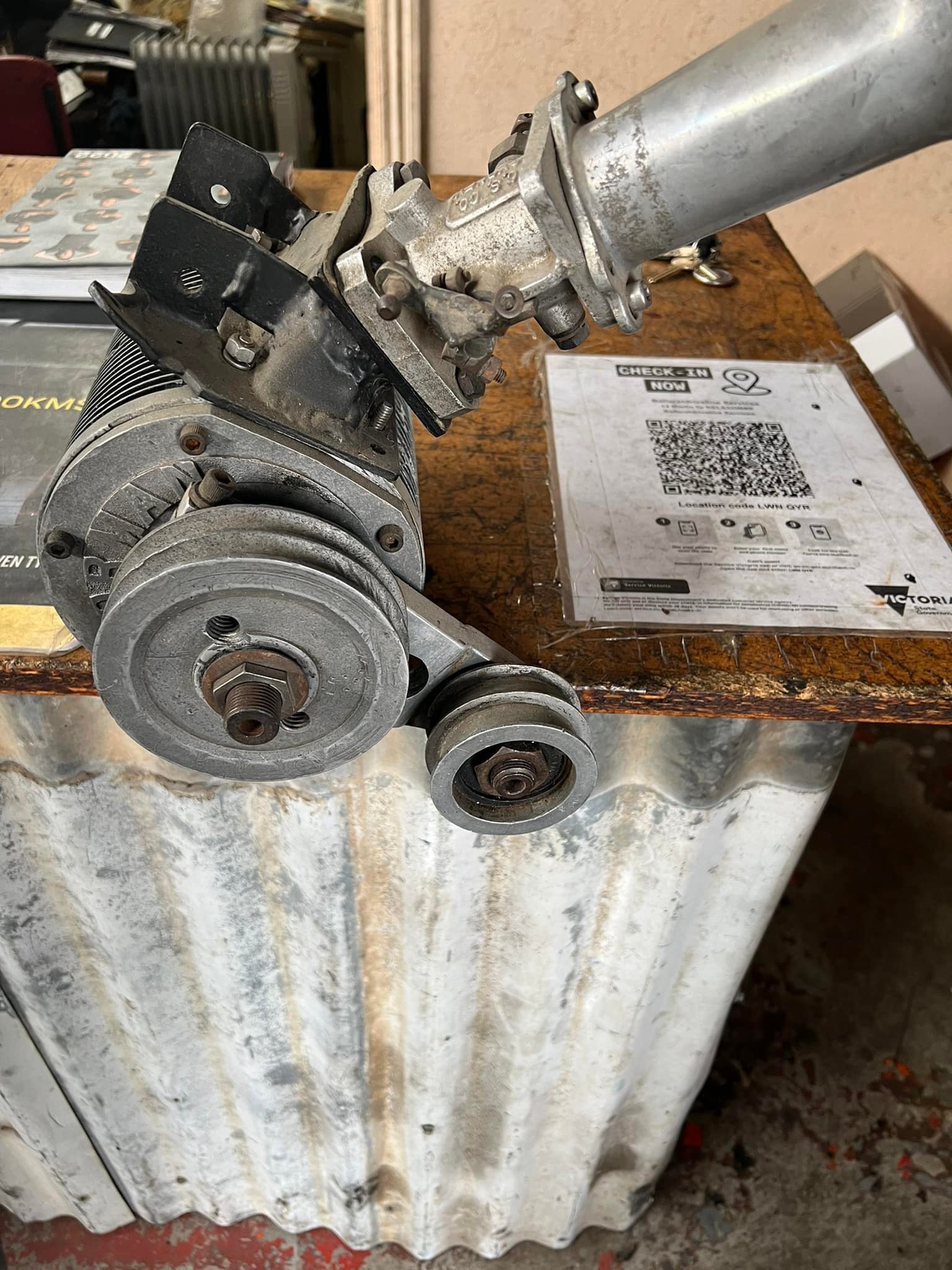

Saw a bit of Norman porn today - albeit a red setup
Twin type 65’s set up to fit a 9 port with SU induction
