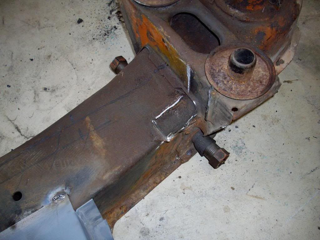

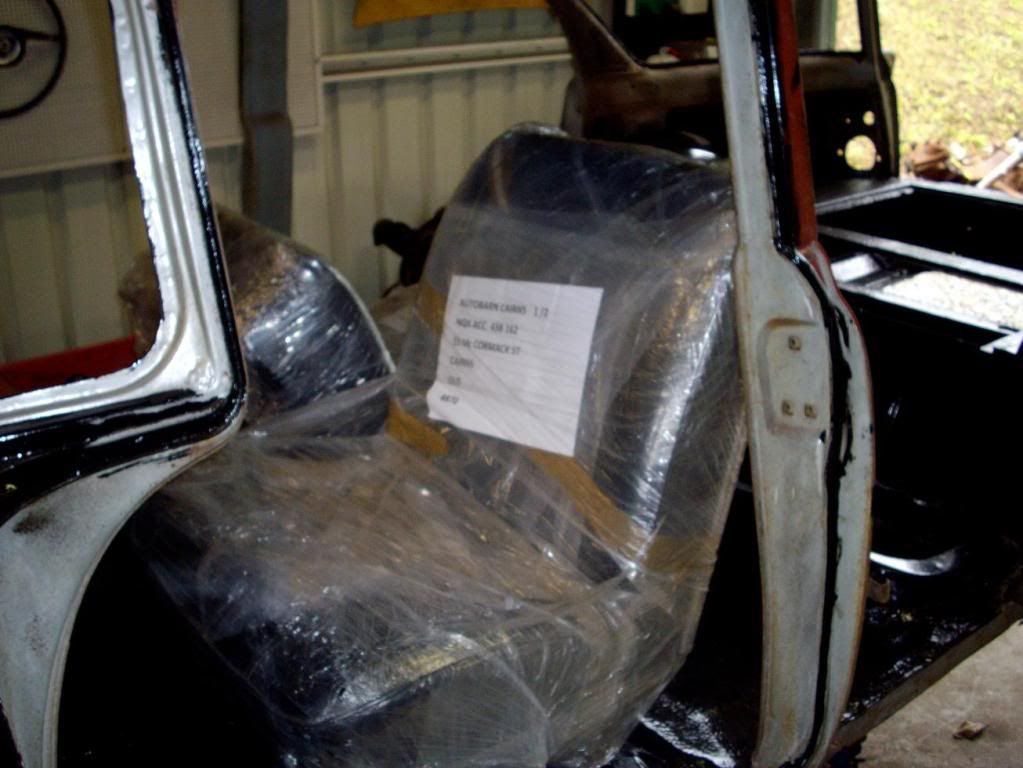

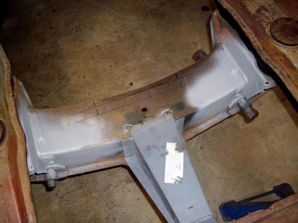

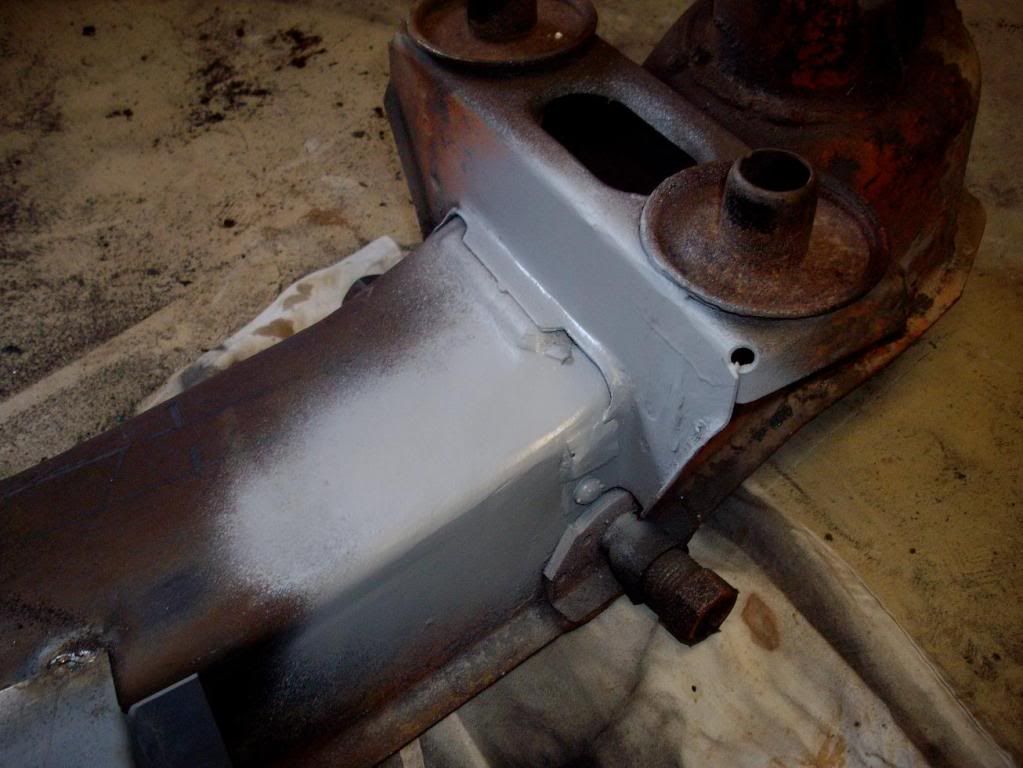

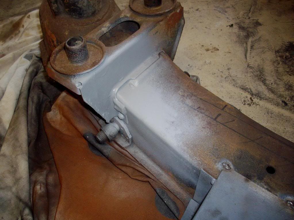

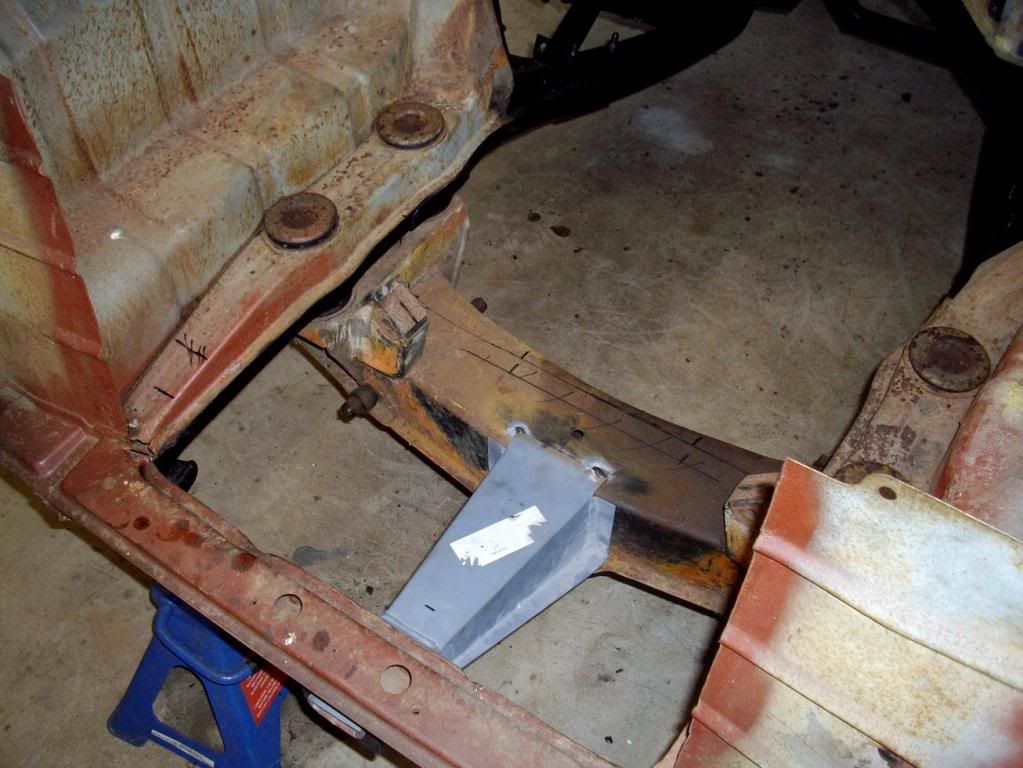

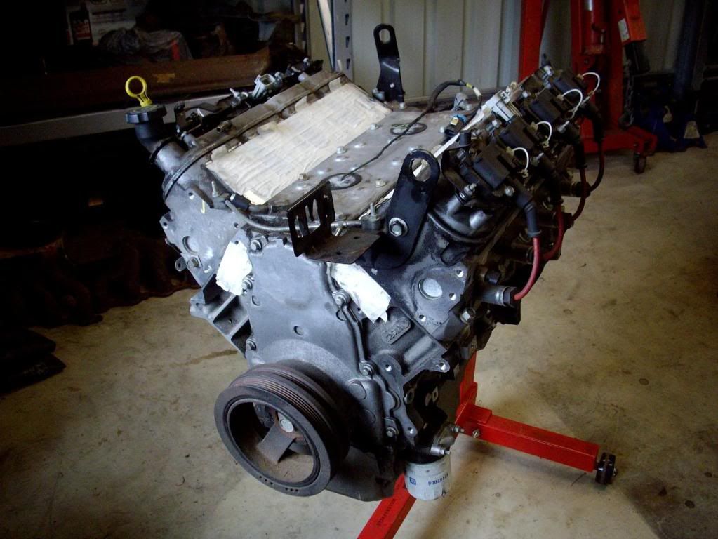

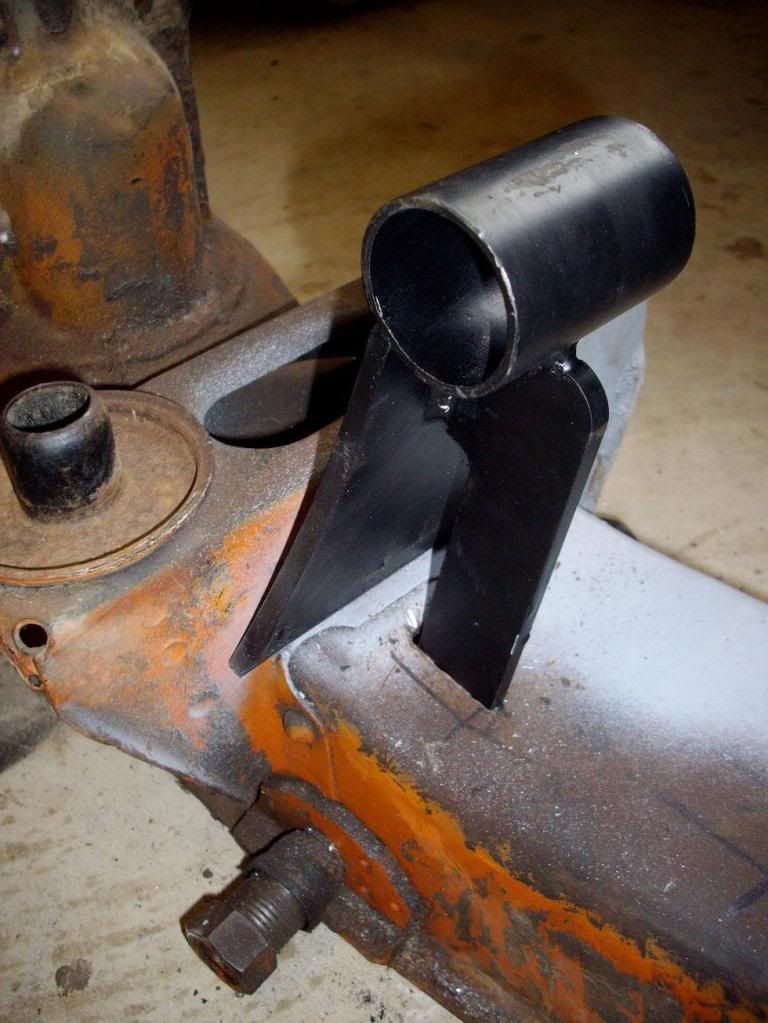

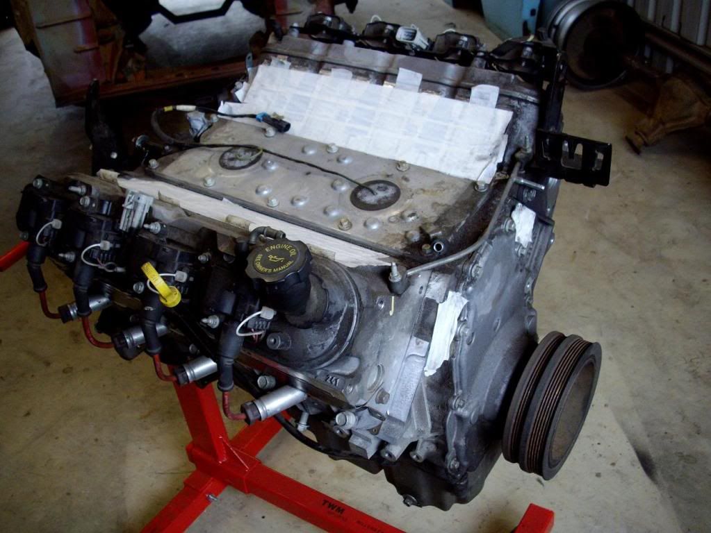

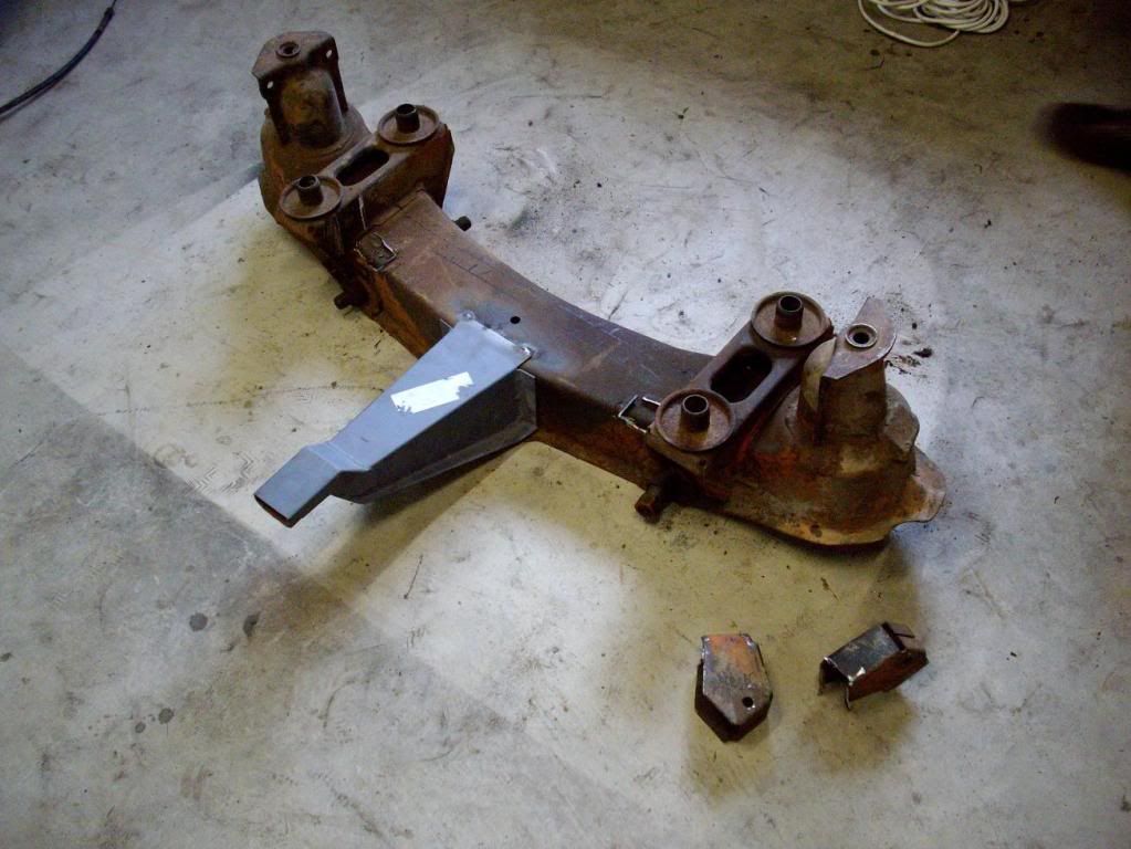

Thanks for the support guys! Old man got busy and stripped the motor down some more, also go onto some bucket seets for the front and fitted up the HR front end and tacked on the outrigger. Then today we dropped her back out and removed the engine mounts to make way for the new ones: ImageImageImageImageImageImageImageImageImage

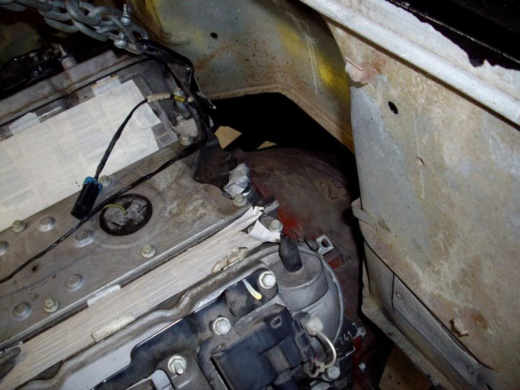

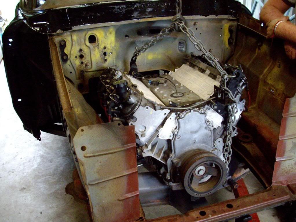

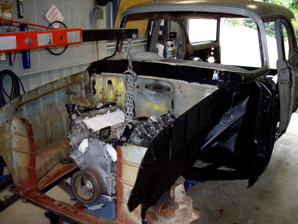

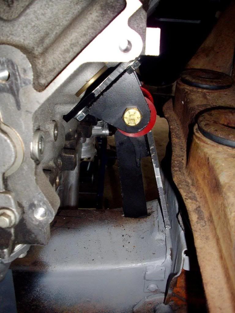

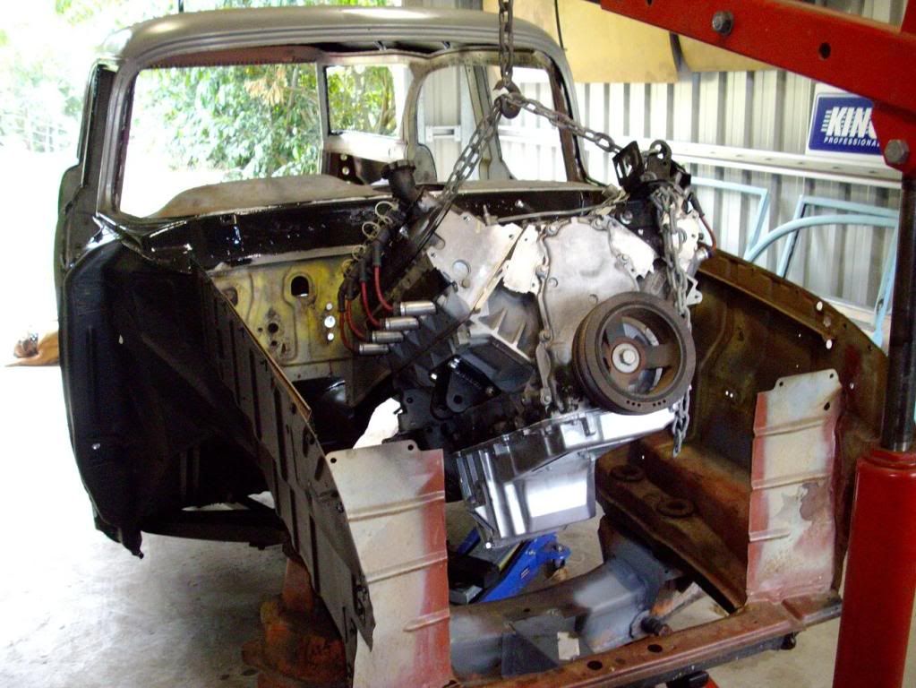

Well now the fun really begins. Did a dummy fit of the engine & trans today to see if it's all going to fit. So far so good. Put the new sump on - it's not really sitting on the crossmember as the photo's look like - we've got about 15 mm clearance. Good clearance with the firewall too, although we'll have to fit a front mounted rack & pinion and the radiator will mount on the front of the support panel, not behind as stock. Got the engine mounts tacked in, all ready for a professional with better welding skills than me to weld in properly. All in all a productive day. Cheers :D

coming along nicely :D 8) the sump looks pretty cool, pity its going to be hidden so much, lets you get the engine nice and low.

Those mounts are a beautiful piece of work, they make the engine sitting less cluttered than the traditional way of mount fabrication. 8)
