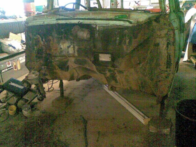

Hi All, Got the subframe off today..Them bolts i ended up just smashing a 12mm socket on to them and got them of that way.(wasted two 12mm sockets in the process)
Any way the body where the sub frame was has no rust at all and the subframe has a lot less than i was expecting it to have.....which made me very happy :P :P :P ....
Cheers Mark
P.S i really should use a camera instead of my phone :oops: :oops: :oops: :oops:
