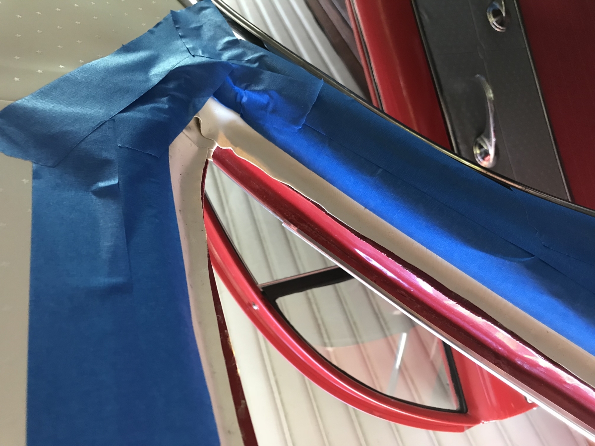

c) When fitting the screens, the black mastic that ends up on the hoodlining will clean up perfectly with turps. If you get the turps on the window rubber, do not wipe it onto the hoodlining. The carbon "black" from the rubber rubs onto the hoodlining, and refuses to come out. One turpy rag for the rubber, and another turpy rag for the hoodlining. If you are fumble-fingered like me, it helps to mask the hoodlining with blue painters tape before fitting the windows to stop the mastic accidently getting everywhere.

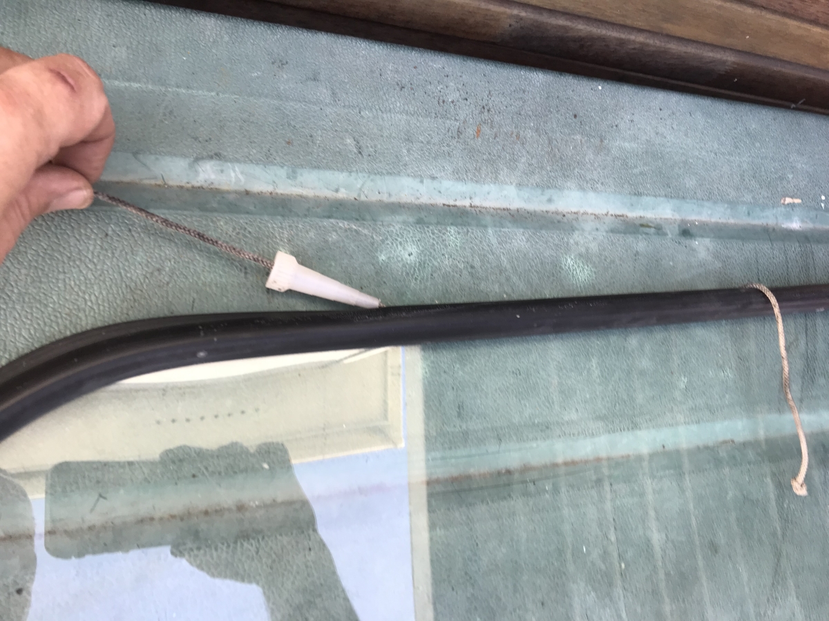

d) When fitting the installation string into the window rubbers, put an old silastic tube nozzle on the string. The nozzle lets you run the string easily into the slot in the rubber... much easier than pushing it in by hand an inch at a time.
nozzle on string.jpg (657.53 KiB) Viewed 10991 times
