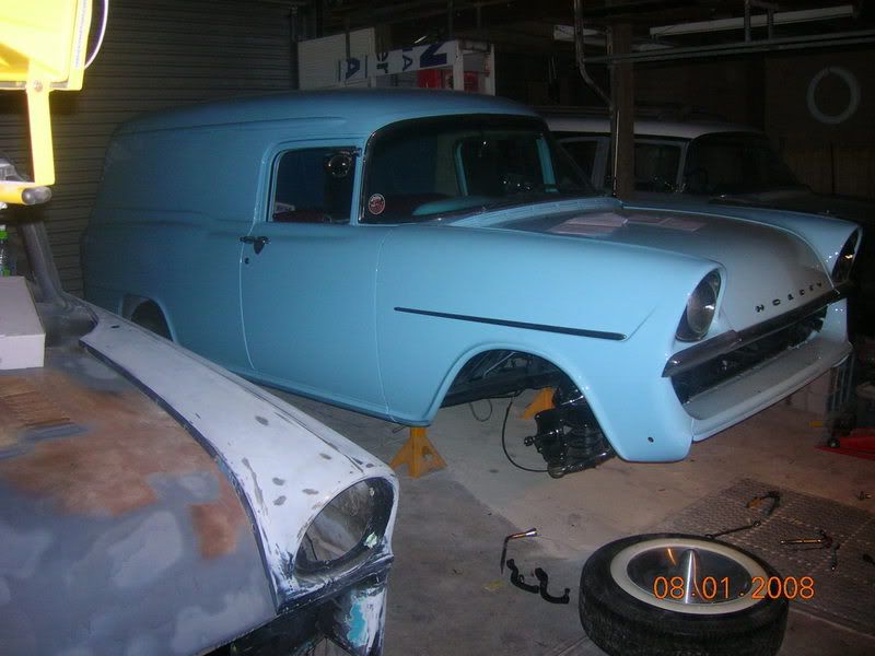

drop spindles and brakes in...
wheels and tyres on...
getting close now.... :twisted:
SCK 8)

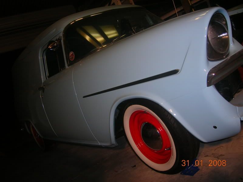

SCK,
ride height looks spot on 8)
I assume you have the CRS HR 2'' drop spindles fitted ?
If so what springs did you put back into front end, standard or lowered type ?
As i will be fitting some crs drop spindles that i bought i was just wondering what you'd used.
What rim / tyre width are you running? Any clearance issue's on guards?
Ian B
KISS- Keep It Simple Stupid.
southcoastkustom
Posts: 537
Joined: Tue Nov 28, 2006 11:20 pm
Location: Adelaide, SA
Post by southcoastkustom »
Hi Ian,
They are CRS 2" spindles running HQ brakes and 1" lowered heavy duty springs. Front rims are standard 14x5" HQ steel rims running 185/65/14 tyres with so much guard clearance its brilliant. Actually thinking of putting 2" lowered springs in to get her slightly lower, but will wait til I've driven it for a bit to see how much these 'settle' before I change them.
SCK 8)

Just be careful with the dropped spindles and lowered springs, my brothers Cusso had a similar setup It put the wheel up in the gaurd too far over big bumpscausing the wheel to hit and rub on the underneath of the inner gaurd! Unsettling the car a great deal and causing momentary loss of steering, NOT FUN!!!!
Van looks awesome, can't wait to see a shot all together and outside.
Post by mrs ratbox »
re: the caps, what holds them on?
what DR said about guards hitting my '64 SS did the same, another note is the front cross member hits the ground before the bump stops make contact :shock:
