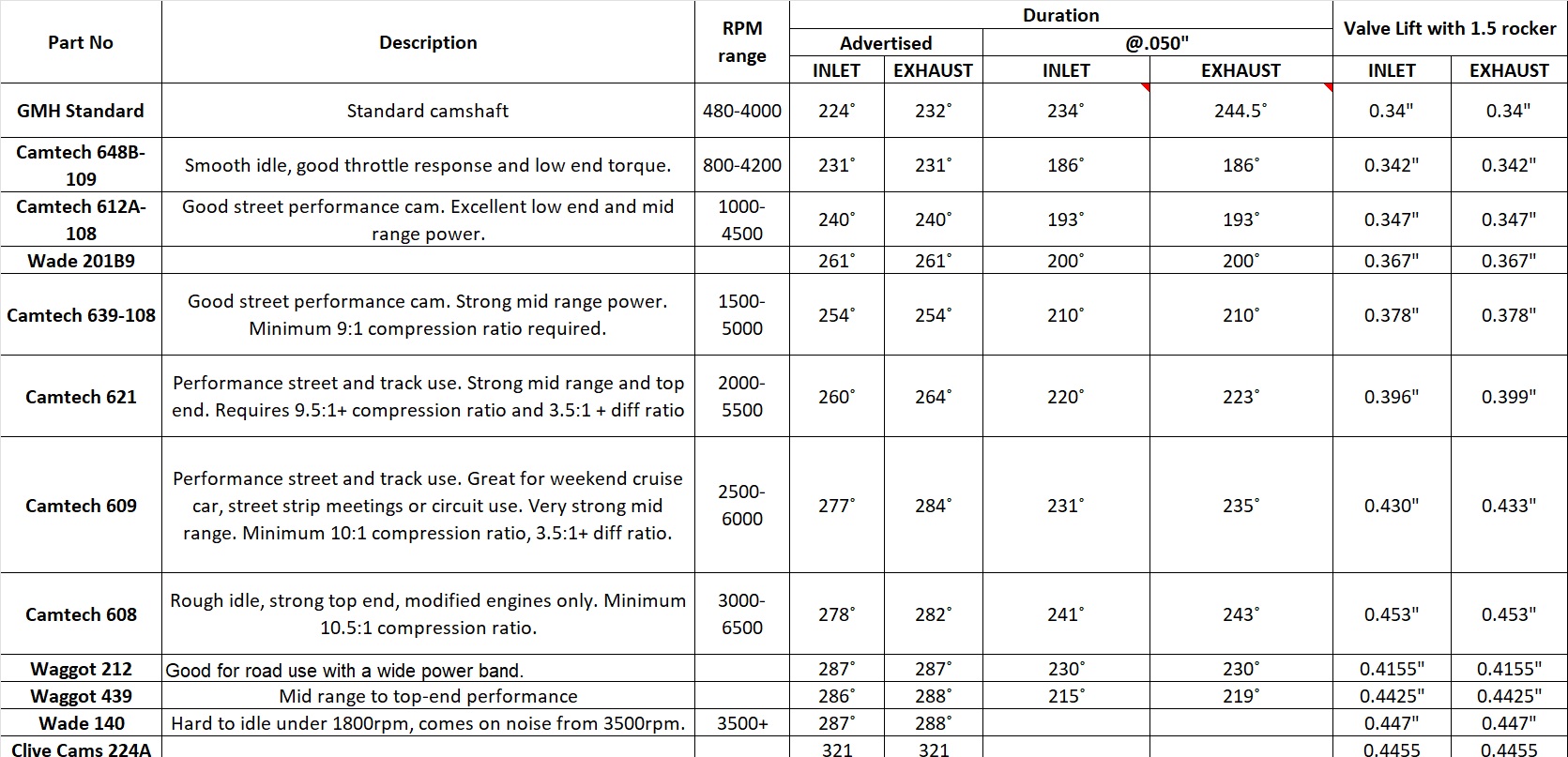

ed.harris wrote: Fri Jan 23, 2026 5:56 pm Any other Cam suggestions?
Grey cams.jpg (374.53 KiB) Viewed 7698 times

Thanks Harv I am thinking something similar to the Camtech 639 108 cam. Will that Cam make 125HP?

The table is useful as it is written in order of duration. As duration increases (going down the table) the cams get lumpier, make more power... and are harder to live with in traffic. The descriptions in the second column give you a rough idea of what behaviour you can expect at a given duration range. This will vary a bit from cam-to-cam, but is not a bad guide. Just like you have done, choose a behavior that suits what you want. You can then discuss that behaviour and approximate duration range with a cam grinder. They will then find one of their grinds to suit.
For grey motor cam grinders:
Burt Jones closed in the early 2000's. I spoke to his niece a few years back, but have since lost the contact :(
Camtech folded around 2020. The business was purchased by Crow.
Crow are still trading.
AFAIK, Tighe closed in December 2025 and the equipment was sold on.
Wade closed in 2014, with the gear sold to Clive. I've got a full list of Wade grinds here somewhere, but the table above shows the grey motor ones.
Clive was bought by M&W engines in 2023 and is still trading.
Waggot is still operating.

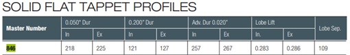

Anyway, I also dropped off the Cam as an Exchange, David uses Crow Cams and recommended Grind number Crow 846??
David did not have any Specs on the Grind but did say previous builds did result in rear wheel horsepower of 100HP.

ed.harris wrote: Sat Jan 31, 2026 2:32 pm Anyway, I also dropped off the Cam as an Exchange, David uses Crow Cams and recommended Grind number Crow 846??
Crow Cams 846 profile.jpg (17.58 KiB) Viewed 7603 times
Close to a Camtech 639-108 from the table above.
