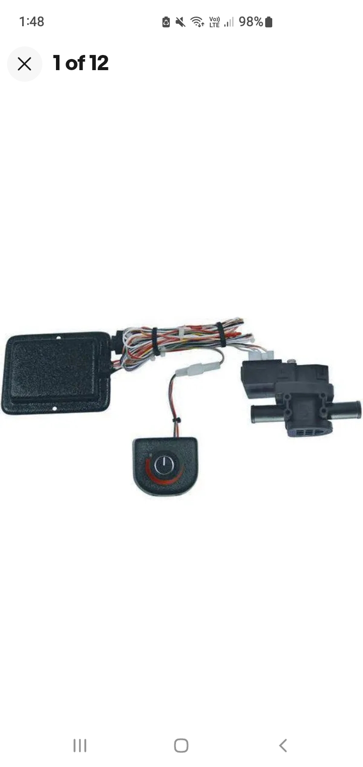

Hey Brett you got a photo or details on the electric tap :crazy:
Posts: 2536
Re: Family Affair Ek Ute
My one is part of my aircon stuff. If you do a search you can find the Vintage Air ones or other makes.the Vintage Air one is the lower photo.
Posts: 2816
Now that's a pretty neat little bit of kit most of the modern ones I've seen run on vacuum.
Thanks for posting Brett :thumbsup:

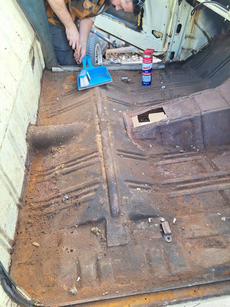

Well it's been a big job but it's at the blasters....
Sent from my SM-A546E using Tapatalk
Posts: 11670
Looks like a very good starting point. Great to see you are getting stuck in. Keep the updates coming.
Posts: 2536
Looks like a good one. Love the home-made transmission hump. Look forward to seeing the journey🙂
Posts: 14275
Here’s hoping there are not too many nasty surprises mate 👍👍
Posts: 2816
Great start point Sneezy, looking forward to seeing this come to life mate.
