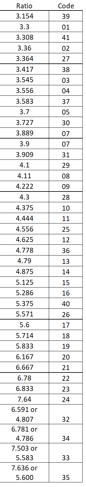

With the chassis being built, it won't be too long before it needs a diff to hold "the other end" up. The original bang-go diff from an FB/EK is not going to be up to the abuse I'm intending. Weight is going to be a challenge, so I need something that will handle 200-odd horsepower, but not something that will support 1000-odd. No need for a 9". Whatever diff I build though needs to be reliable... in a FED you sit over the top of the diff, with the wheels beside your ears. Not the place for flying parts :shock: .
The simplest solution is to go for a Toyota diff. I'll use a "G" diff (8" live axle) from a HiAce (very similar to a Hilux). They will handle 400-odd ponies with no problem. The awesome bit is that they have a hell of a lot of ratios, and a lot of those ratios are in the tall end (great for rock crawling, better still for drag racing):
Toyota G diff codes.png (31.77 KiB) Viewed 4438 times
When hunting down a diff at the wreckers, the VIN plate tells the story. You will find a diff code like G392. The G bit indicates the 8" diff, the first two digits the ratio (in this case 39 = 3.154:1) and the last digit indicates the centre:
2 = 2 pinion open centre
3 = 2 pinion limited slip centre
4 = 4 pinion open centre
5 = 4 pinion limited slip centre
The 2-pinion diffs were used in the 4-cylinders, and the 4-pinion centres in the V6s. A 4-pinion centre (bearings increased from 40 to 50mm and better spider gears) is a bit of overkill for what I am doing. In any case, the spider gears (in fact the whole carrier) will get replaced by a full spool, so no worries about de-toothing the spider gears. A spool is a simple bit of steel that is bolted to the ring gear instead of the carrier, and effectively locks the two axles together. Lighter and stronger than the carrier, and helps prevent wheel slip. Looks like Nitro Gear (https://nitro-gear.com.au/products) make a spool for both the 4-pinion (part number FSTV6-30) and 2-pinion diffs (FST8-30).

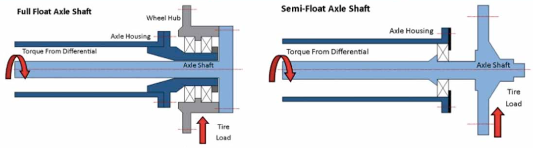

The diff will get shortened (it will be less than a metre flange-to-flange). I need to have a conversation with the IHRA tech inspectors, as opinions vary as to whether I will need to have fully floating axles or not. The floaters are stronger (and often mandated for the top classes), but waaaaay overkill for the grey. They are installed by a weld-in kit and axle changes, but hoping to avoid the drama.
floating axles.png (169.62 KiB) Viewed 4438 times

I didn't realise they had such a range of ratios. The 3.154 would work work for me.

I wouldn't have thought there would be a need for full floaters in such a low HP car ?
Mark Williams in USA will make a damn fine axle that will never break with what you are doing.

Checked with the IHRA techs, and no need for floaters :thumbsup:
Only needed if quicker than 7.5 seconds or over 2500lb. If would need to drop a grey motor out of a helicopter to get it to travel 400m in 7.5 seconds :lol:
