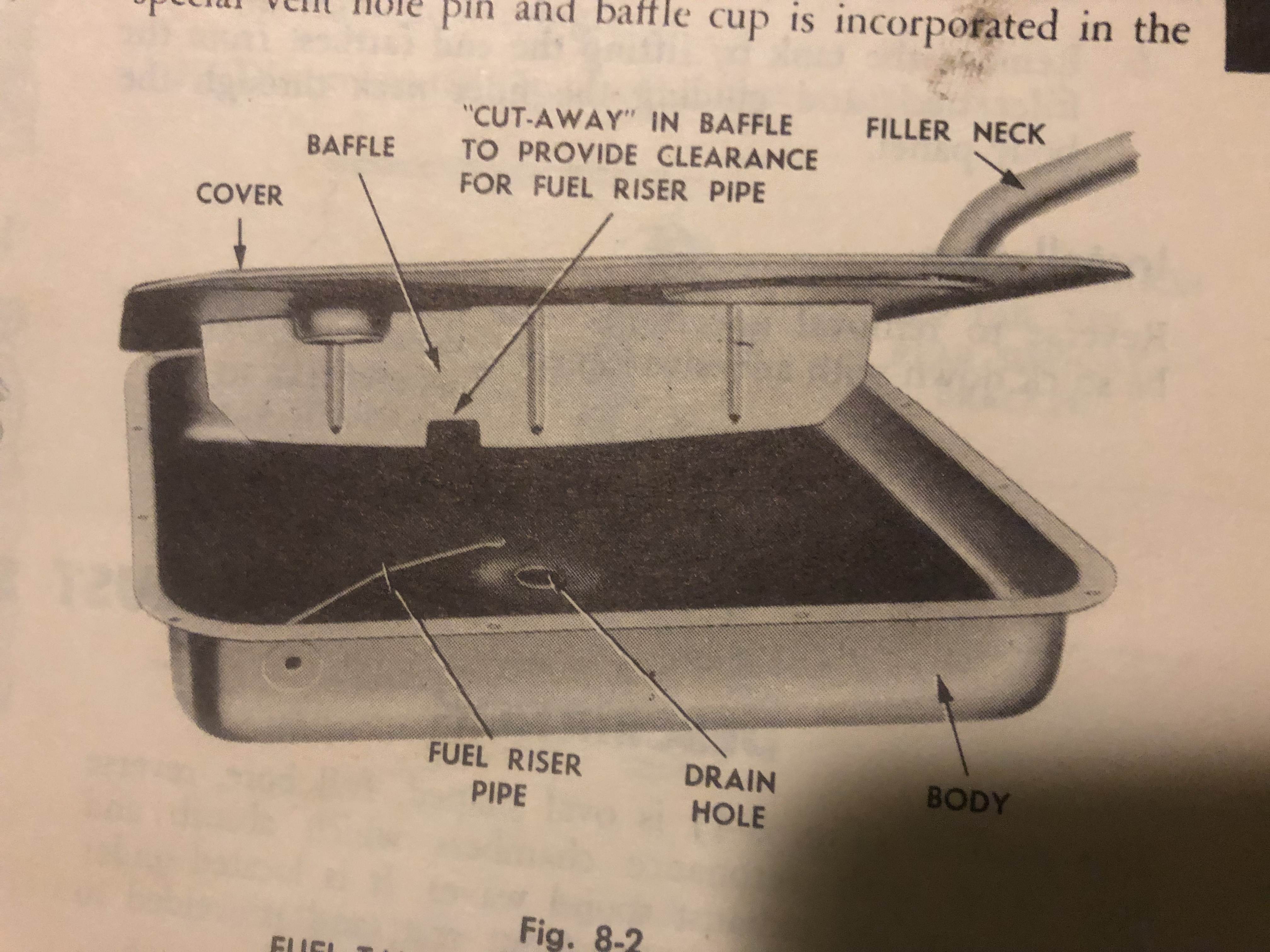

Gotta love a happy ending Pearo, if memory serves me correctly - and it is getting rarer and rarer these days , the fuel pickup had a screen on it inside the tank ? Maybe it was coated in crap and you have popped it off , or the other option - I am talking out of my rrrrs :lol:

Well if there was a screen on the end of the pick up line (and quite possible cause it took some force to get it off) I’m wondering if this screen floating around in the tank will cause any issue. If anyone has any info on this I would appreciate your thoughts. Oh by the way the car in question is an FC Holden with a grey motor.
Re: Fuel issue
Posted: Wed Jun 30, 2021 6:07 pm
No screen… just the open riser pipe. Soldered to the inlet hole and soldered to the tank floor. Runs down to near the drain plug.

Well….looks like it must have been just blocked. I must have punched through the blockage and when I siphoned the fuel through it brought all the crap with it. The first litre of fuel that came out was black and full of crap and smelt like varnish until the fresh fuel flowed through. I guess if you leave fuel in your tank for seven years that’s what happens. :roll:
