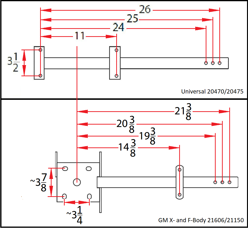

I managed to get hold of VPW, but sadly they do not have any of the Lakewood GM X- and F- body units in stock to measure for me. From some HAMB help, I've managed to get the rough dimensions of the shock absorber plate for these vehicles - assume the Lakewood units are similar. Using this and a bunch of published info gives the dimensions below:
Lakewood bar dimensions required.png (90.97 KiB) Viewed 5040 times
From what I can see, both the Universal and the GM units will come close to working on an FB/EK. They are a smidge long (the snubber would need to run on the shortest of the three holes provided), but OK to either live with the length or trim to suit. The GM unit mounting holes (that use the original u-bolts) may be problematic. The 3 1/8" distance is fine, but the 3 7/8" distance is painful. It requires the u-bolts to be moved out along the diff tube (no drama... the banjo diff does not locate the u-bolts), but you can afford to go to about 3 5/8" before the u-bolts will hit the rear brake hose bracket.
For the GM unit, the issues stack up for me - risk of hitting the brake hose bracket, overly long, only one of the three shock mounts will get used, and pricey (about $370 for the basic bar, and then another $180 if you want J-bolts :shock: ). Given these issues, I'm not going to pursue the GM unit any further.
Plan for now is to take a look at the Universal unit, and then detail out what an FB/EK specific unit looks like (using either the Universal unit as a starting point, or some RHS and fittings).

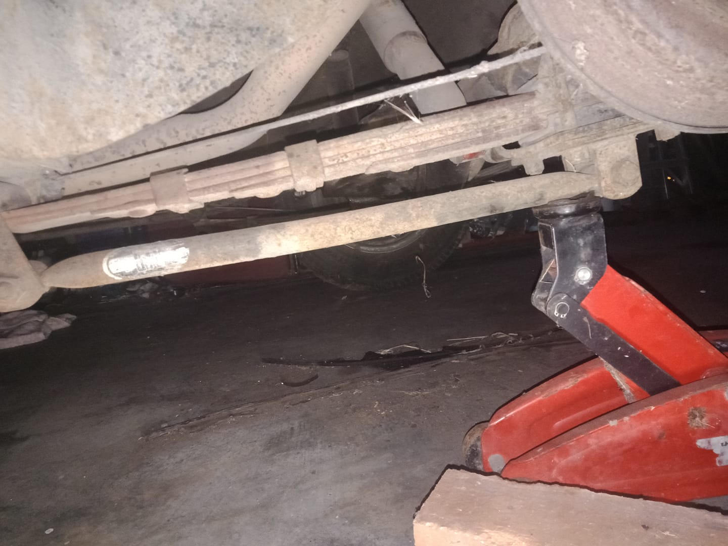

55-56 chev type wouldnt work harv? Length of bar may need “adjustment” but otherwise should be bolt on? Image

Posts: 5558
Re: Harv's traction bar thread
They probably would come close to fitting, but those look to be a Caltrac setup (I think the forward pivot is sitting on top of the leaf spring in the photo?)

Yes they are called Caltrac type - the forward pivot does look to be sitting on the leaf yes and rear pivot is connected to spring pivot - is that an issue?
I would have thought this type set up would be more effective than the unconnected rear pivot type.
Harv wrote: Fri Mar 05, 2021 7:08 am They probably would come close to fitting, but those look to be a Caltrac setup (I think the forward pivot is sitting on top of the leaf spring in the photo?)

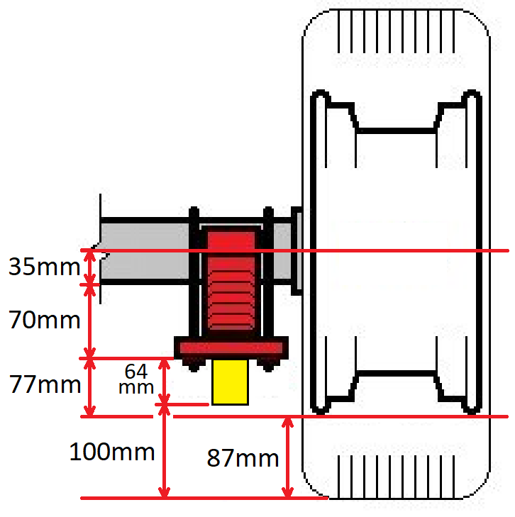

While I wait for the Lakewood Universal bar to show up, I’ll dig into the rules around installing traction bars. The guidance around traction bars is captured in NCOP Section LS Tyres, Rims, Suspension and Steering… but is not particularly clear. Section 1.1 indicates that "track rod" installation is a basic modification not requiring certification, with Section 4.6 clarifying that track rods may be fitted to control rear spring wind-up provided that they meet the minimum ground clearance requirements. This would indicate that I can bolt up some traction bars without an engineer… provided a “track rod” is a traction bar. Sadly, NCOP is silent on what a “track rod” is though, and the term has a lot of different meanings – for example, it can mean a panhard rod or a front suspension tie-rod depending on the author. The National Guidelines for the Construction and Modification of Street Rods in Australia (section 6.12) notes a difference between track rods (which it allows, subject to clearance as above) and traction/slapper bars (which it prohibits due to the traction bar nosing under brakes and limiting suspension movement under cornering). I suspect from the above that NCOP is referring to a radius rod, but cannot be confident.
So a bit uncertain whether traction bars can be installed on an FB/EK without certification (but pretty clear they cannot be installed on a street rod).
However, NCOP Rear Suspension Modification (Design) Code LS5 Section 3 allows for “Traction aids attached to a live rear axle near the spring mountings”, provided they are compatible with the geometry of the spring, do not cause any binding with suspension movement, and that under body clearances and ground clearance must be maintained and continue to meet regulation requirements. This sounds like I can install traction bars, though need certification. The regulation requirements mean that I need at least 100mm at any point within 1 metre of the axle (NCOP Section LS Section 2 General Requirements Section 2.1.4) and that the traction bars must hang no lower than the wheel rim (NCOP Section LS Section 2.1.6 Tyre Deflation). For my FB/EK, this gives the following:
Ground clearance.png (39.71 KiB) Viewed 4993 times
The traction bar can be 64mm deep, limited by the 100mm road clearance requirement. Note that this is using Sampson Magnum 13” rims (same rim diameter as standard FB/EK), but 205 tyres (different tyre profile will alter the above).
The Moroso traction bars are 2.5” (63.5mm) and thus would comply, but not sure about the Lakewood ones (suspect they are the same, but will see when they arrive). If you are making bars at home, 65mm RHS would probably be close enough to the 64mm to be compliant (you can probably squeak another 1mm by smooshing the diff u-bolt rubber mounting pad or inflating the tyres a little more).

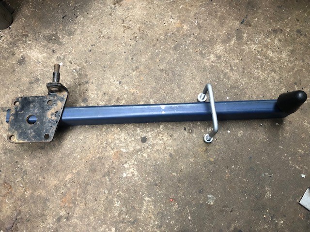

traction bar mockup.jpg (125.44 KiB) Viewed 4882 times

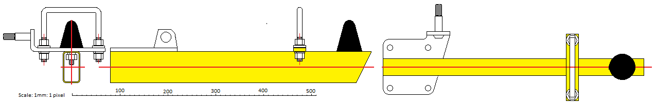

Should look closer to this (final dimensions to be checked to make sure the snubber hits the spring eye):
FBEK traction bars interim.png (6.5 KiB) Viewed 4882 times
