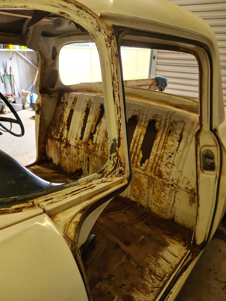

Rodents like to climb up through the a pillars and nest in the head lining.

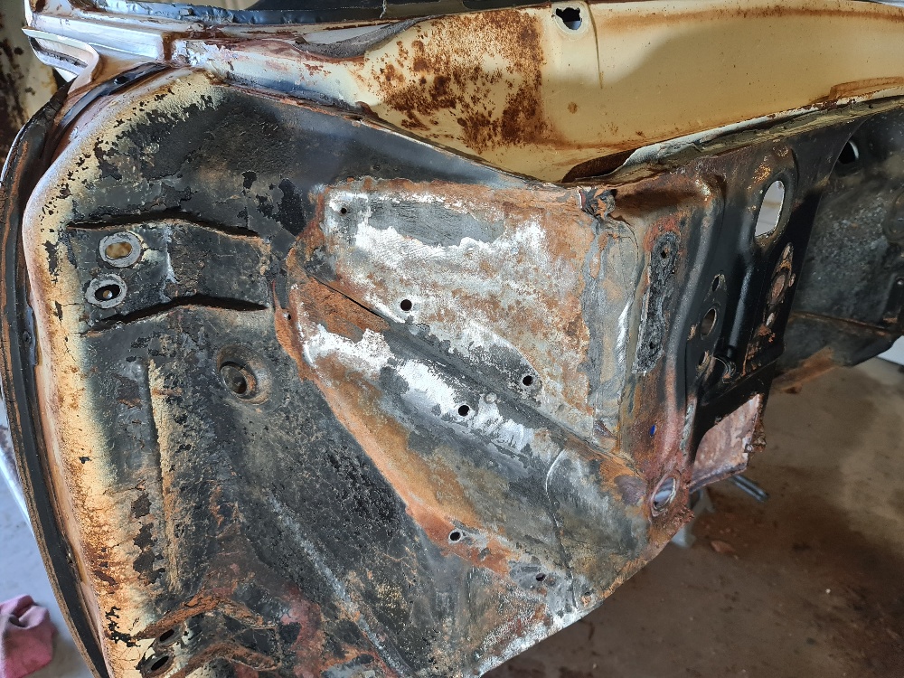

Hi Nick. Great looking ute you have there. Love the labels on the wiring- you're making it easy for reassembly, that's for sure. Definitely worth spending the time now pulling it all down and doing the restore to ensure it stays in top shape for another 60 years. Given how rust free this one is, it will be really interesting to see the bottom of A pillars and other notorious rust prone spots like the kframe/firewall joins etc. If you have none at all it must have gone from the factory straight to a dry outback farm! Thanks for making the effort to post your progress. I'm a bit jealous as you've almost started at the finish

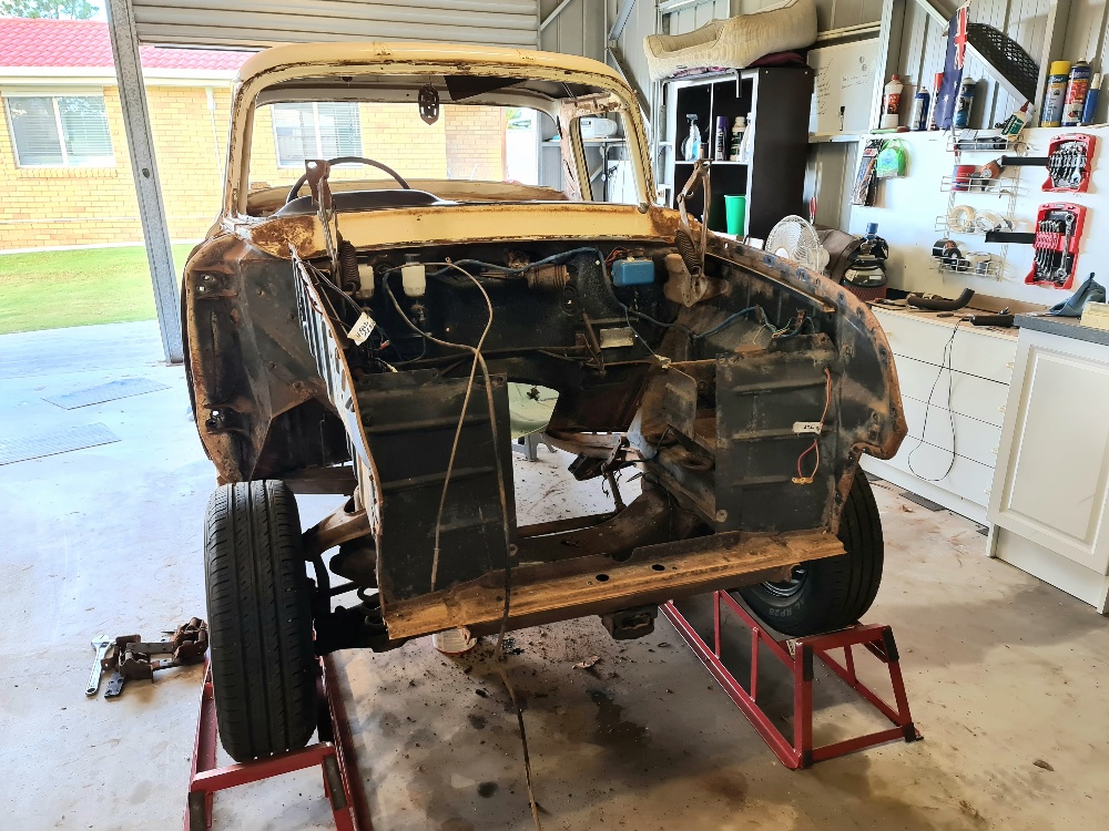

Rolled the Ute out of the shed and gave it a good gerni before pushing back in and remove a few more items.
Very happy with how everything came apart. Also started building a rotisserie.

Thanks for posting your progress Nick. Well worth taking apart and restoring it now given how pristine it is. That's the cleanest firewall ever!

Great photos Nick
Looks to be in remarkable condition. That rotisserie you are building looks pretty fancy. Bonnet hinge captive nuts are good pick up point at the front. Bumperettes captive nuts and a long bolt through rear spring shackle eye works well at rear. I haven't had a Ute on rotisserie but starting point for centre of gravity will be fairly low. On sedans the fuel filler hole is the benchmark but ute could be lower. Looking forward to progress updates.
