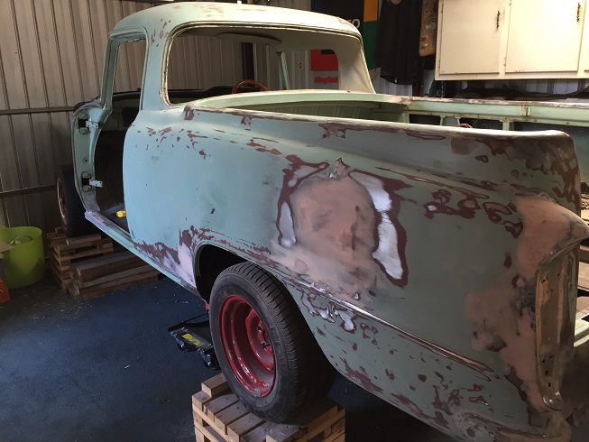

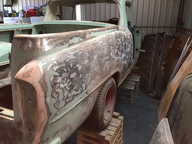

In hindsight, I should has dripped or grit blasted the entire ute.
Lots of sanding needed now to remove what appears to be a waxy filler or primer.
Some area are extremely heavy so the belt sander and 80 grit was used. I too cringed but kept the sander moving and did not allow any heat build-up.
RH side.JPG (132.17 KiB) Viewed 1792 times
LH side.JPG (114.66 KiB) Viewed 1792 times
Doors were fair but needed a good flat hand sand with 80 grit then 120 grit.
Blocking the body by hand with 120 grit as it cuts through the waxy filler.
Ground out heaps of bog used to shaped the sills and the half door skin fix would have made a blind man cringe.
Cut and pulled the sills into shape, opened up the drain holes then used the metalized filler to finish off.

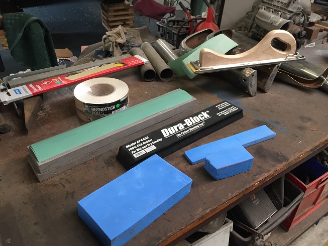

No more belt sander as I have most of the top coat paint and way filler off. Gentle hand blocking with the long board.
Purchase one long Dura block and picked up scrap urethane off cuts from Clark Rubber.
Cut and shaped a piece of the urethane into a half circle about 25 mm round
sand blocks.JPG (136.58 KiB) Viewed 1768 times
The wooden blocker is used for roughing down on 80 grit
Purchase new tub of filler which lays out nice and smooth. My old tub required fibreglass resin added to thin it down. I picked up the tip on YouTube when killing time.
