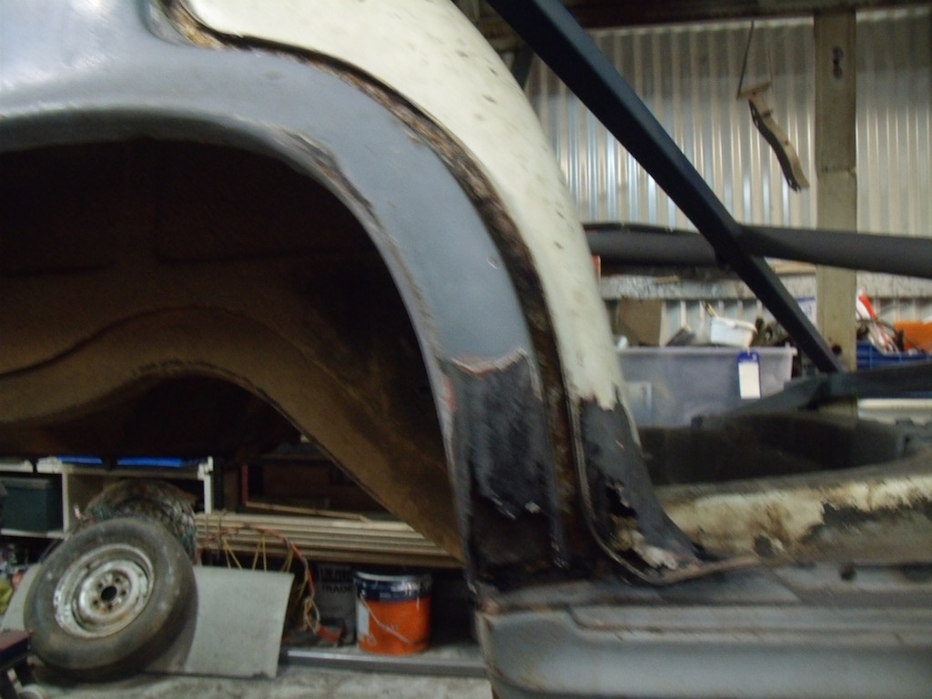

Q4 is what is a dog leg? Other than the leg of a dog...

Orange Betty wrote: Thu Jul 12, 2018 8:09 pm Thanks for the advice. I was planning on getting her blasted and thought I'd do a complete strip down including removing the front subframe, and everything under the rear and ship it off to the blasters that way including doors, bonnet, boot lid and fenders.
Wayne why wouldn't you blast the roof and large panels? Also I see that you shipped Milkshake to the blasters as a rolling unit, does that make it easier? :huhhh:
Definately tagging and bagging, including all the nuts and bolts - which leads me to Q3 - do you re-use / re-condition them or just get new ones? :huhhh:
Dave
The dog legs are in front of the rear wheels, they can rust badly from the inside out normally

EK283 wrote: Fri Jul 13, 2018 5:08 pm
Like this....

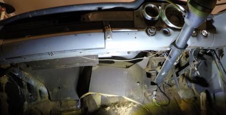

Also removed the "shroud upper outer panel" and am up to removing the "plenum chamber cover panel and door assembly" which I assume is this:
Under shroud grille.JPG (37.21 KiB) Viewed 1345 times
but the manual says it is located under the instrument panel?
Under Dash.JPG (36.05 KiB) Viewed 1345 times
Can any point me in the right direction?

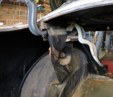

Also I assume this widget is something to do with the spare wheel?
Spare wheel thing.JPG (38.58 KiB) Viewed 1345 times
Dave,
Have a good look under the dash. Carefully remove the cardboard glovebox insert. You will see the plenum door and frame which is actuated by the chrome lever next to the ash tray. Can you see any evidence of rust holes in the panel it is mounted to? Is the plenum chamber full of pine needles or leaves? There are drain tubes either end of the chamber which allow any water to escape to the inner guard area. You can remove the door assembly if the seal needs replacing. Minor rust holes can be accessed under the dash rather than removing the cover panel but this is easier if the interior is out of the car and easier still if the car is on a rotisserie.
Yep, it's the spare wheel holder.

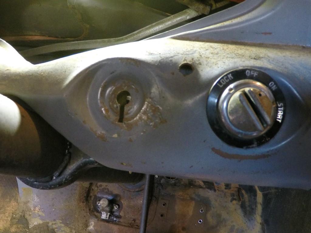

I managed to prise the cap off the fuel sender. The screw heads are very rusted and I don't like my chances of getting them out easily - any hints? There isn't a lot of room to work in there.
Have cleared out under the dash and although the windscreen wiper motor connection and all the wiring frustrated me no end, we got there. However I can't figure out how to get my ignition mechanism out and for which I don't have a key?
What is the spot next to the ignition for?

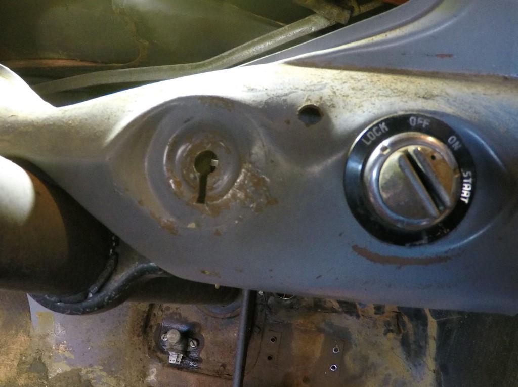

and what is this thing under the accelerator pedal and how do you remove it? The fastener on the underside is not something I recognise.
What was here.JPG (93.17 KiB) Viewed 1216 times

A good project you have there! Your going to need the ignition key to remove the ignition switch unless someone else on here has an alternative. You could see if another early Holden enthusiast has a key that might fit your lock as can sometimes be the case.
The opening in the dash to the left of the ignition lock is for the headlight switch.

by gledge
Hi Dave I had the same problem with the ignition Barrell and in the end I just used a pair of multi grips and I nice thick piece of rag and gently but forcefully wriggled and pulled on the chrome outer bezel until it clipped off and then the chrome retaining nut unscrews and you can remove the whole switch. Mine clips on and off no worries so I just do it that way every time even though I now have a key cut and can do it the correct way.. but even if it didn’t clip back on you can at least take it to the locksmith and get a key cut without paying for a home visit and use a dob of glue to hold the bezel on..

Posted: Sun Jul 29, 2018 12:19 am
The thing under the accelerator pedal is simply a spring fitted to hydramatic cars. Mounted on a captive nut welded to the floor. I believe the idea was to make full throttle application require extra pressure. Apply penetrant and marinate for 24 hours. Then attach point nosed multi grips between spring coils to centre shaft and simply unscrew.
