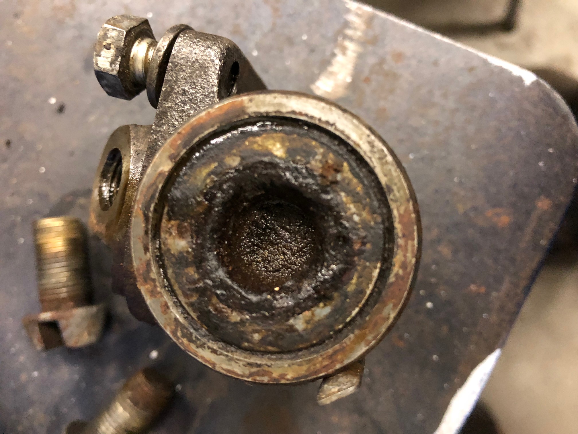

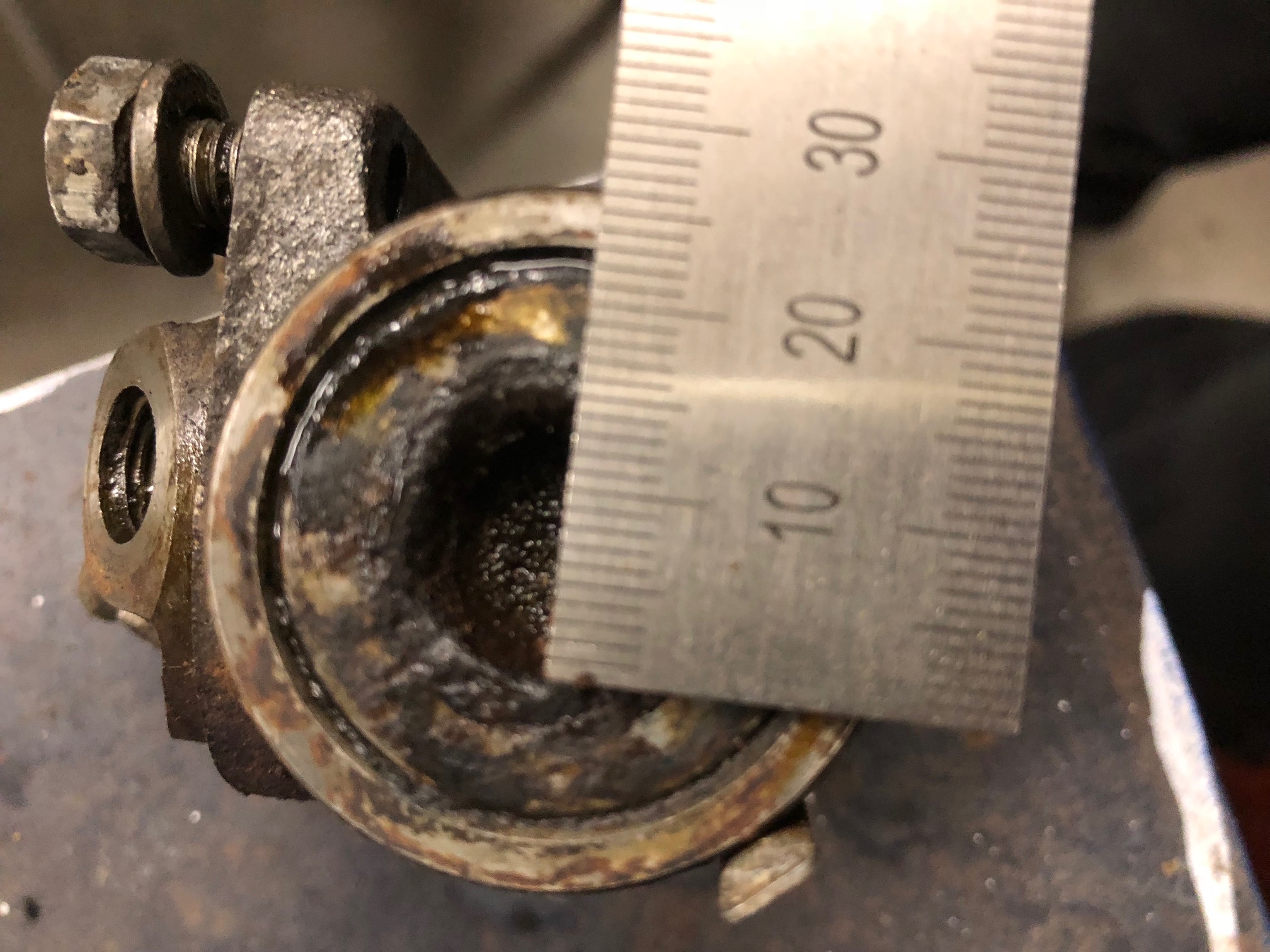

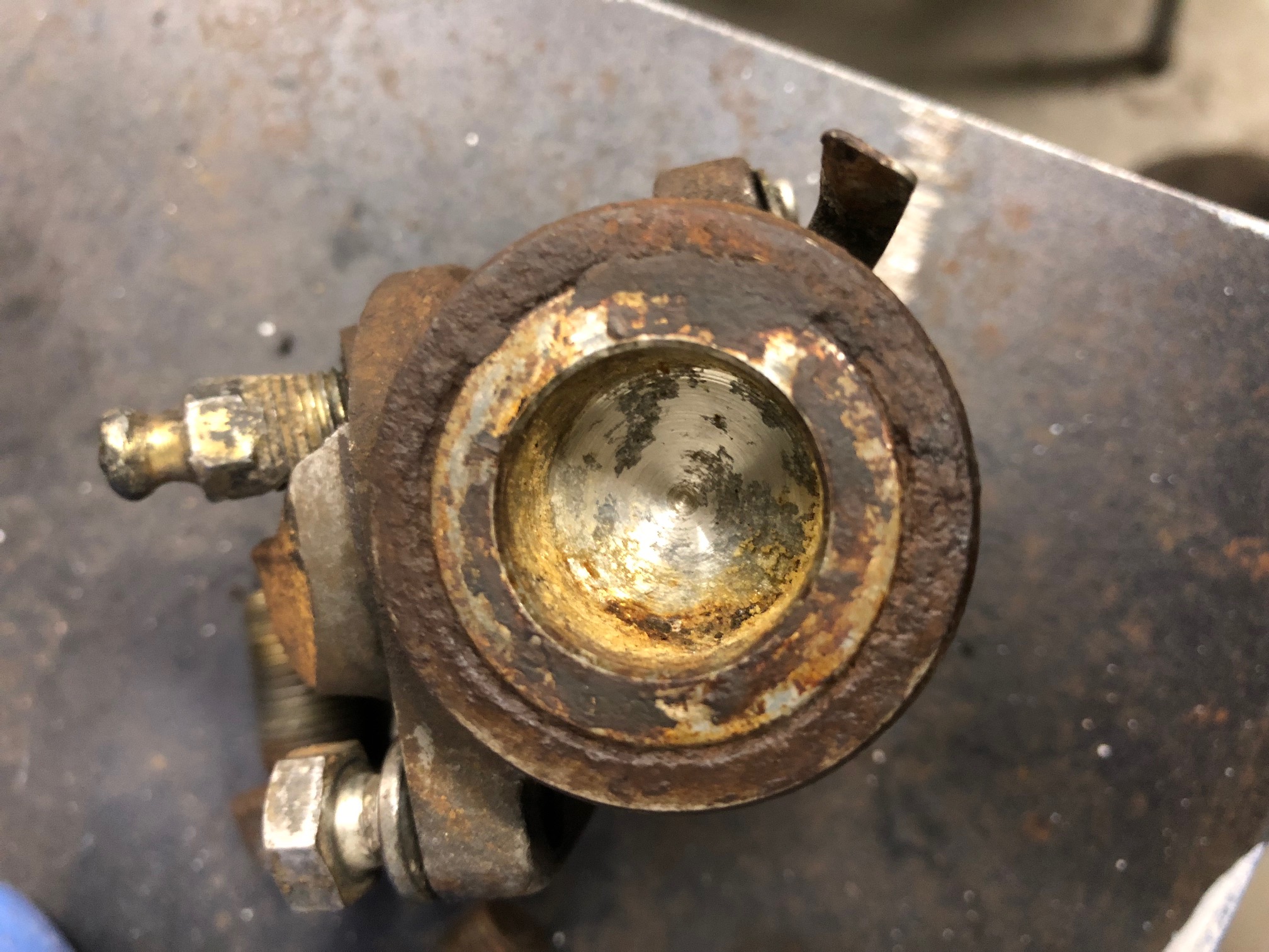

I pulled one of the front wheel cylinders off and started to strip it. The pistons are seized as I expected it would be and will need a soak in penetrating fluid and then some grease pressure to free them (accoridng to the internet). I was surprsied though to find the pistons are different at each end of the cylinder. One has a 'hole' 20mm in diameter, while the other is only 15mm diameter. I didn't pay too much attention, but I think the one to rear is the smaller one. Is this normal?

The wheel cylinders are 1” on the rear and 1 7/16”?? On the front. More braking force to the front to avoid locking up rear brakes as weight of the car dives forward. Standard stuff, later cars may have a proportioning valve instead.
You will be best to get the cylinders resleeved if you intend sticking with stock brakes. You can drive the pistons out using a vice and drift if you’re careful. More care to get out bleed screw and tube nut cleanly. If you want to keep the tubing intact you can remove the rear wheel cylinders with it intact. Just undo at the brass union on the axle. I’ve just been through all this. Have a look at my thread Clay’s Wedgewood Blue FB Ute

I haven't mucked around with drums for a long time but it appears that whay you are measuring there is where part of the mechanism sitss into the wheel cylinder the piston is the outer circle you can see.

The "smaller inner diameter" on the rear slave cylinder piston is accumulated crud. Grab a screwdriver and you can dig it out.

Correction to my post above, fronts are 1 3/16”. Just dropped my resleeved but still leaking front driver wheel cylinder back to south Glenelg Brakes.

Thanks for the replies. I filled the smaller end with brake cleaner and it softened up over night - you were right on the money Rob!

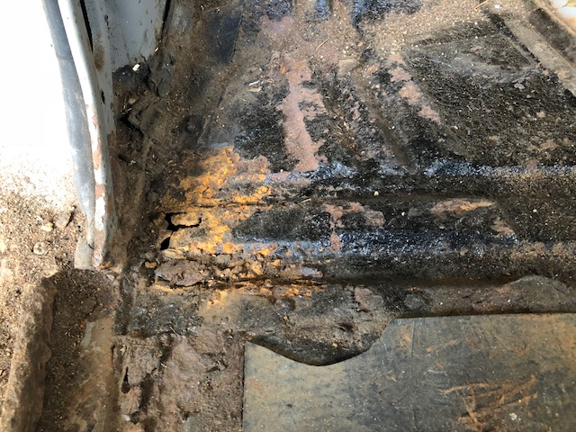

The strip is progressing slowly, but havent had any major dramas so far. I have pulled the old mats out and found some rust in the passenger floor near the a-pillar junction which will need cutting out. One surprise on pulling the mats u was that the transmission plate was missing - why would someone leave that off when putting the mat back in is beyond me. Luckily I found it in the parts pile so will reinstall it when putting everything back together.

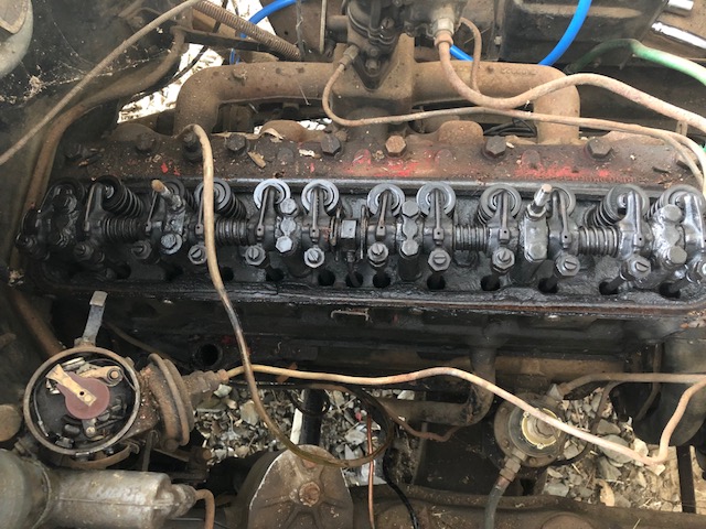

I also thought i'd see if I could start the motor before pulling it out. It hasnt run for 20 years. Following the guide on this forum I put some oil in the cylinders, drained the sump and replaced with fresh oil, removed the valve cover and distributor and tried to spin the oil pump with a drill. Used up the battery of my cordless before any oil appeared on the top of the motor. Does that mean my oil pump is knackered or am I doing something wrong

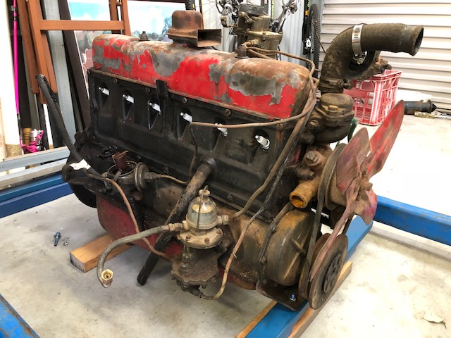

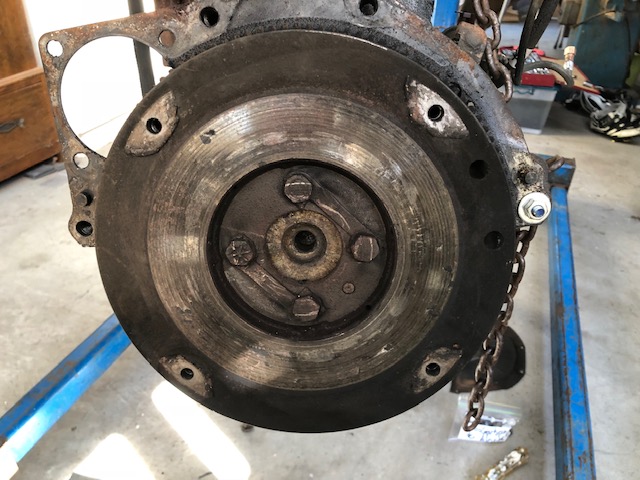

Got the motor out this weekend - relatively straight forward. It's now sitting on the floor of the shed while I source some longer bolts so I can get it on an engine stand.

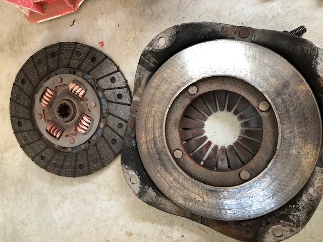

Clutch looks to have plenty of life left, but the fly wheel looks a bit grotty.

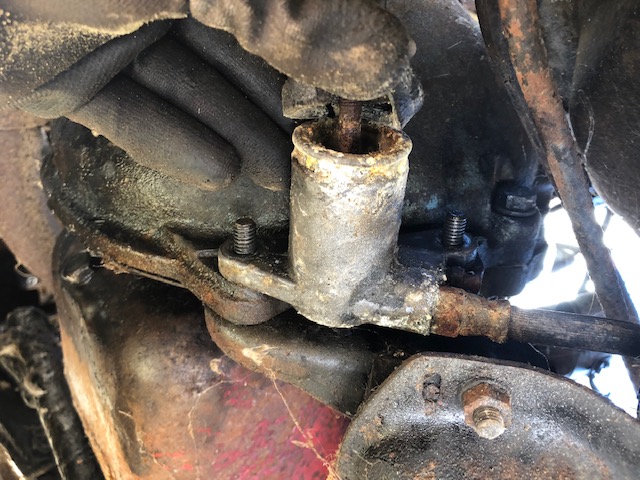

Clutch slave cylinder looks to be finished...

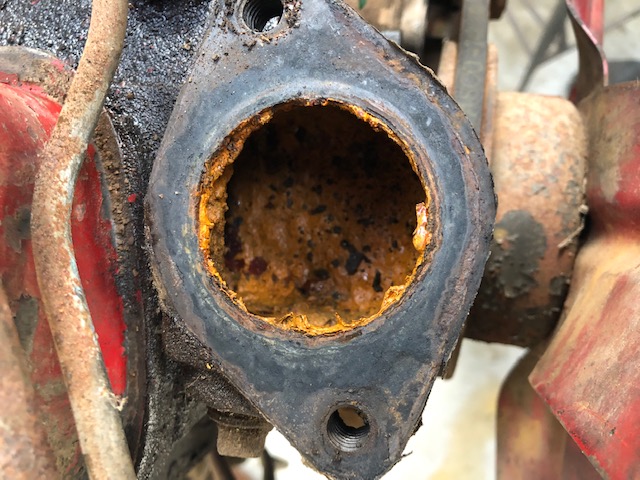

So today I took what I thought was the thermostat housing off. Inside I expected to find a fair bit of rust around the thermostat. I was half right -should there be a thermostat in this hole?

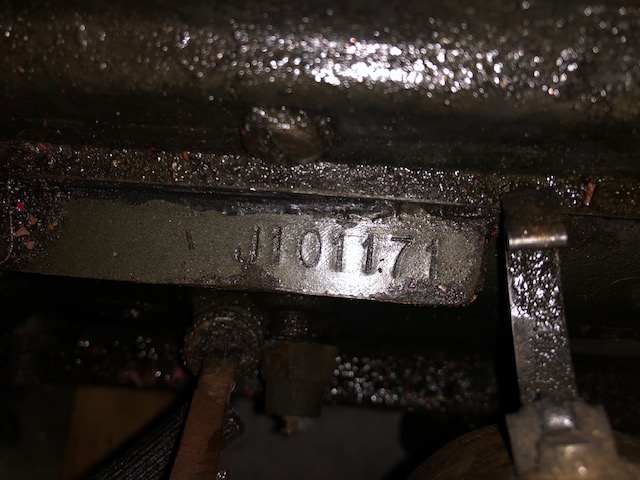

Also turns out my motor is out of an EJ according to my understanding of the engine number prefix. Shame it’s not the original.

Yep there should be a thermostat there. It maybe that the motor was over heating and someone removed it to improve cooling? Keep up the good work, keen to see progress pics.
