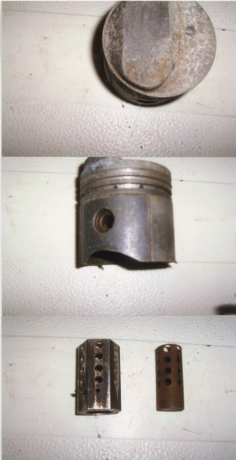

Not much more in the way of “fancy” stuff for the rotating assembly. The lifters will use standard GMH items, refaced if needs be, with the little buckets pressed in to them to suit the angle the Repco pushrods run on (the buckets come with the repro head). According to the lumpy humpy guys you can run &*#@ lifters, though I’m not sure of the advantage other than availability (I’ve got plenty of grey lifters, so haven’t bothered researching the specific model of &*#@ lifter used). I’ve seen some of the lumpy humpy lifters get cross-drilled to lighten them. John Brown had the jig for doing this, though I no longer know where the jig lives (see below):
Lifter jig.jpg (293.53 KiB) Viewed 1440 times
The lightening would lower the reciprocating mass, lowering the amount of energy consumed in spinning the motor and giving faster rev response. My gut feel is that my lifters are going to be under enough stress with the buckets that lightening is not a great idea.

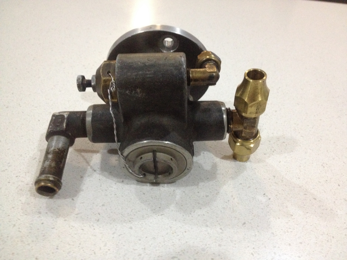

Thanks Blacky - please do post a photo. I heard that the guy was casting them, but I don't do Facebook, and missed the boat. How heavy is the wall thickness around the cam gear? I'm wondering if it is heavy enough to either mount a fuel pump to it, or stiff enough to take a doubling plate to mount a pump to. Plan is to use the older Hilborn pump that I overhauled and posted on the forum earlier:
Optimized-Hilborn pump.JPG (690.71 KiB) Viewed 1437 times
... or failing that, one of the PG150A pumps I own.
