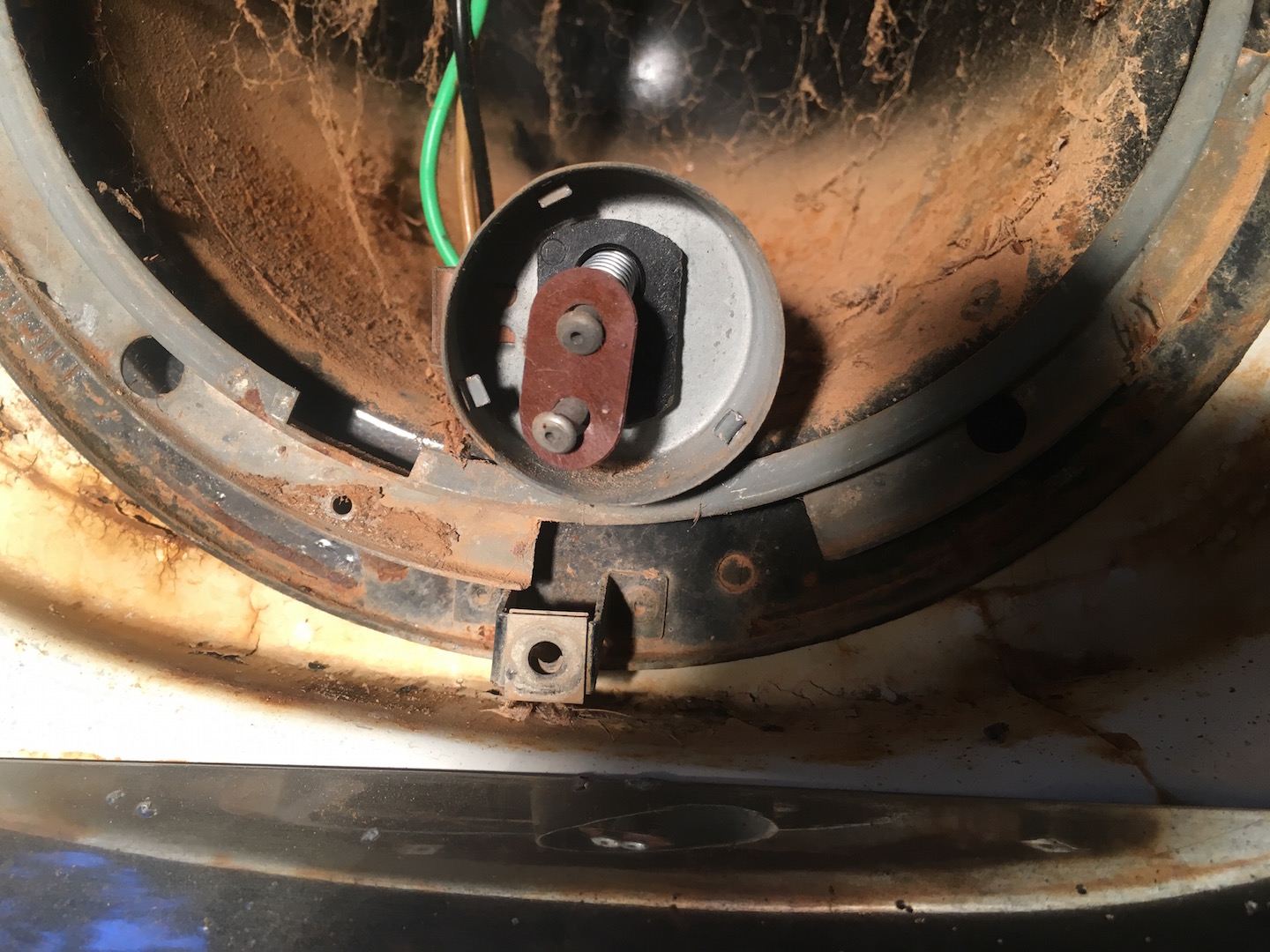

One of the jobs on my page long list to get her ready for licensing was the RH low beam wasn’t working
Looks like someone’s decided this’d be a good spot to set up camp.
Need to replace this fella.
This little bit broke in two when I removed the lamp - do I need to replace it or is it ok without? Looks like an insulator.

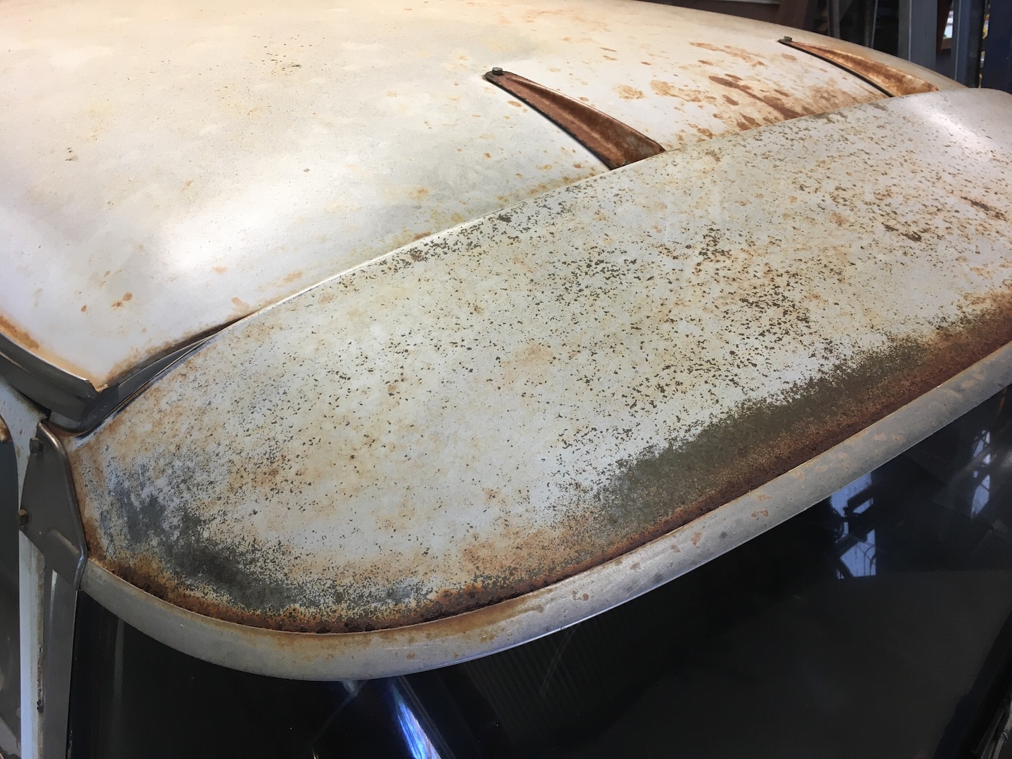

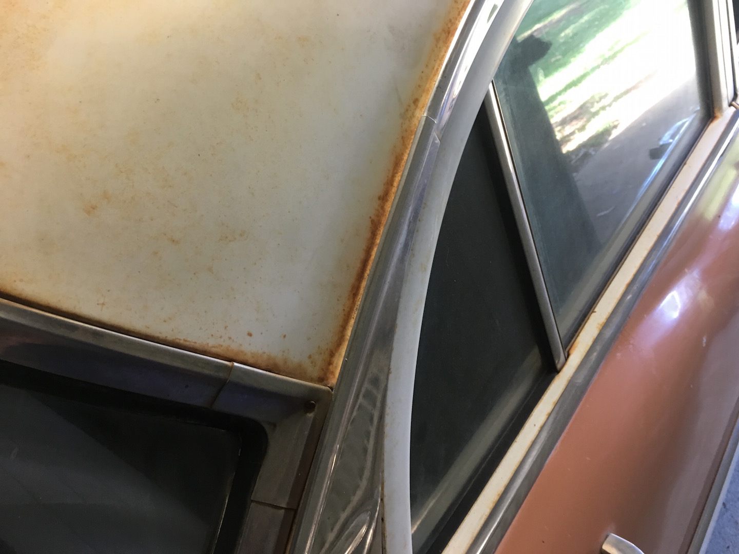

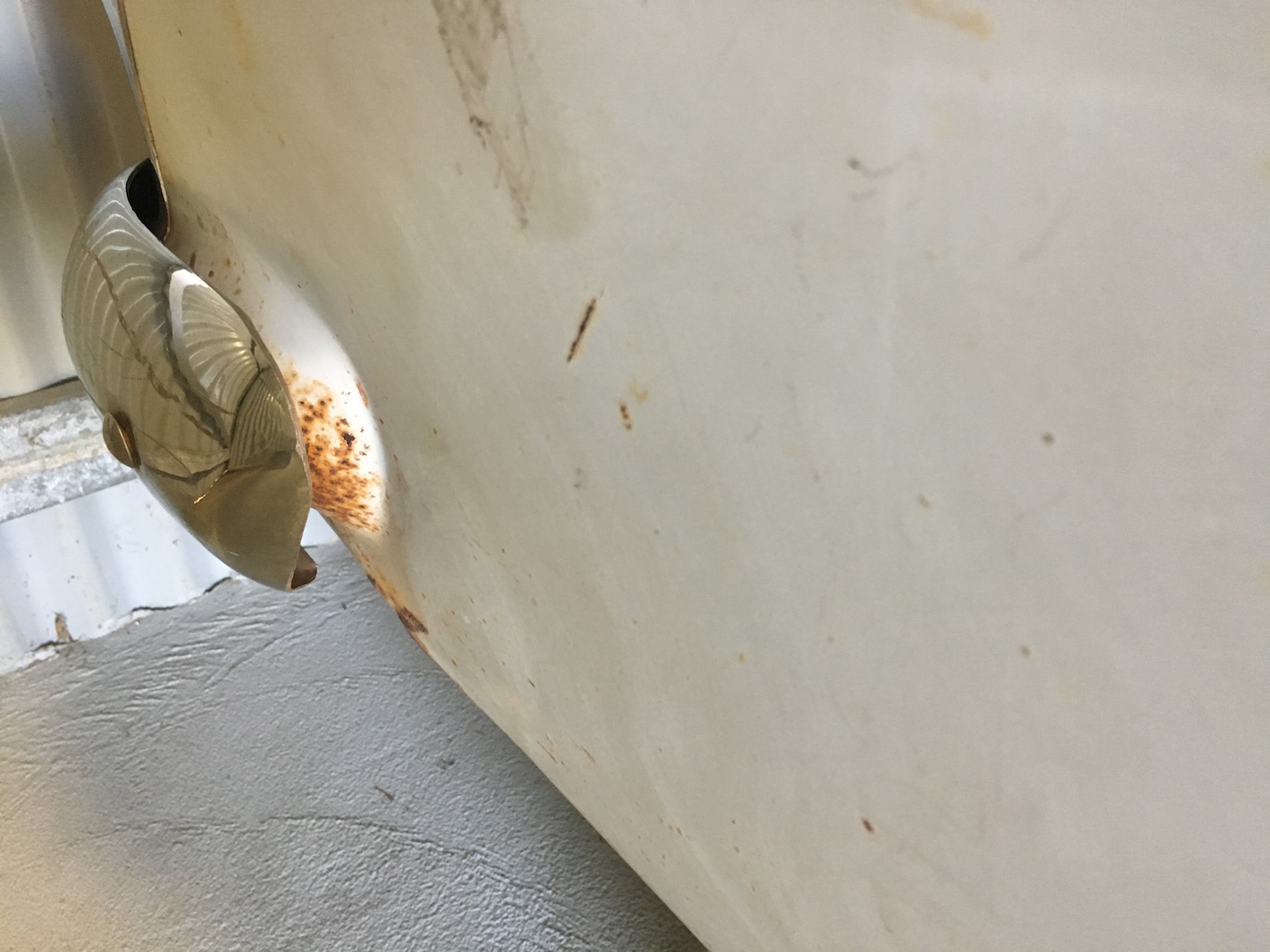

Rust wise, the usual things like inner/outer sills, rear door doglegs & front fenders look pretty good but hard to tell unless you start removing paint which I don't want to do. The previous owner has replaced all four floor pans and made repairs to the k-frame and a couple of patches here and there. So, structurally, I think she's fine. There's lots of "patina" which I'm happy to keep, but my main concern is the rust in areas where the shiny trim bits meet the shell and what's under the trim - some pic's below. So my focus now is to get her roadworthy & licensed, then I can tackle those possible problem areas bit by bit whilst still being able to drive her.

Doesn't look like anything too serious there, just a car that has been used here and there with the usual marks. If the car is looked after and kept under cover, it is likely none of those areas will deteriorate / progress too far.

bloody nice John. Looks to be in fair to reasonable condition

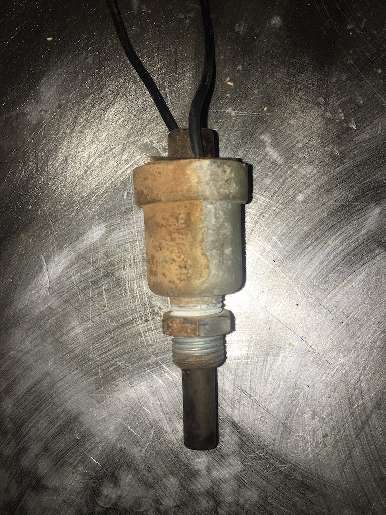

Another job last night. The brake lights weren't working and also noticed there was over an inch of freeplay in the brake pedal. I got under the dash and disconnected one of the brake switch wires, copping a load of brown, southwest, country road dust in both eyes. I cleaned the terminals and did the other one. Being very clever, I shut my eyes this time Image
The lights worked now, but not until the brake pedal was pressed a fair way, so I thought I'd adjust the freeplay first. I adjusted until I got somewhere between almost no freeplay and 1/4". As per normal, I read the repair manual AFTER I'd adjusted and found it should be 1/8" - close enough. There's almost no adjustment left now - is that normal?
Now there wasn't enough adjustment in the brake switch to make it contact when it should. I thought about bending the bracket, then decided instead to modify the switch with the bench grinder - probably removed about 3/8" all up.
I adjusted until the switch activates just after the freeplay takes up.
May be an original switch - Delco Remy written on it.
Now brakes and brake lights are all good. The previous owner told me he'd replaced or had serviced the brake components about 18 months ago, including cylinders, flexible lines and all but two hard lines. They seem fine whilst driving.
Posts: 11064
Re: My new Fb
Sounds like you are missing the bump stop rubber up top next to the steering column. Pity to grind the switch down really not necessary. The rubber is prolly 12-18mm depending on condition and will take out much free play.
Clay
