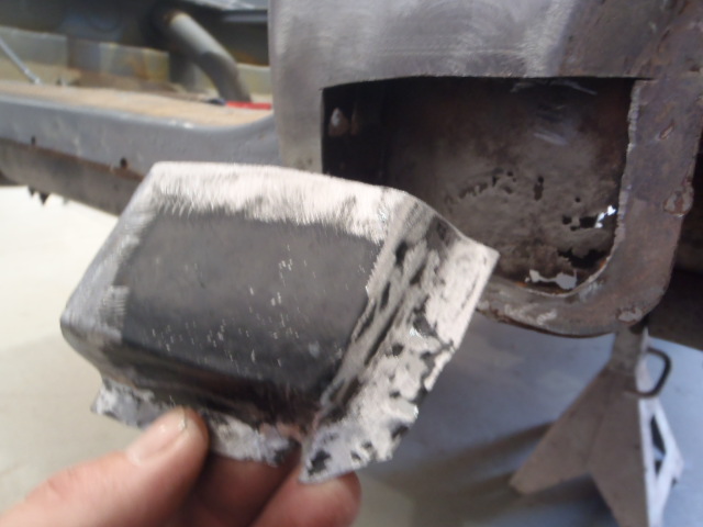

He also replaced the trailing lower corner of the passenger’s guard. It had had an interesting historic repair… an initial rust hole had been repaired by welding over a 6”x6” steel plate, then feathering in the edges with bog :wtf: . The tinworm continued to eat the old guard, and then the repair plate. TJ cut out the old plate, and rebuilt with (one layer!) of new steel.
Had TJ run his eyes over it, apparently also assisted by a visiting rod club, and can’t find any more rust in the vehicle. Happy days!

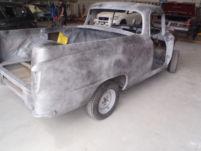

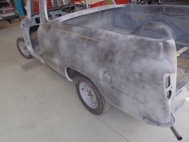

The boys at Hawkesbury City Smash have been busy - ute is now in highfill. They had to fix a little rust around the tailgate hinges, but otherwise rust-free.
Bring on the Silverton Grey!

Re: Harv's (Grace's) EK ute
Blacky wrote: Thu Nov 02, 2017 11:40 pmcool - pics ????
Ute photo 1.JPG (79.7 KiB) Viewed 1719 times
Ute photo 2.JPG (79.01 KiB) Viewed 1719 times
Ute photo 3.JPG (81.32 KiB) Viewed 1719 times
Ute photo 4.JPG (83.17 KiB) Viewed 1719 times
Posts: 11665
Glad you and the ‘puter are back on speaking terms. Lucky girl and impressive progress. Thanks for sharing.
