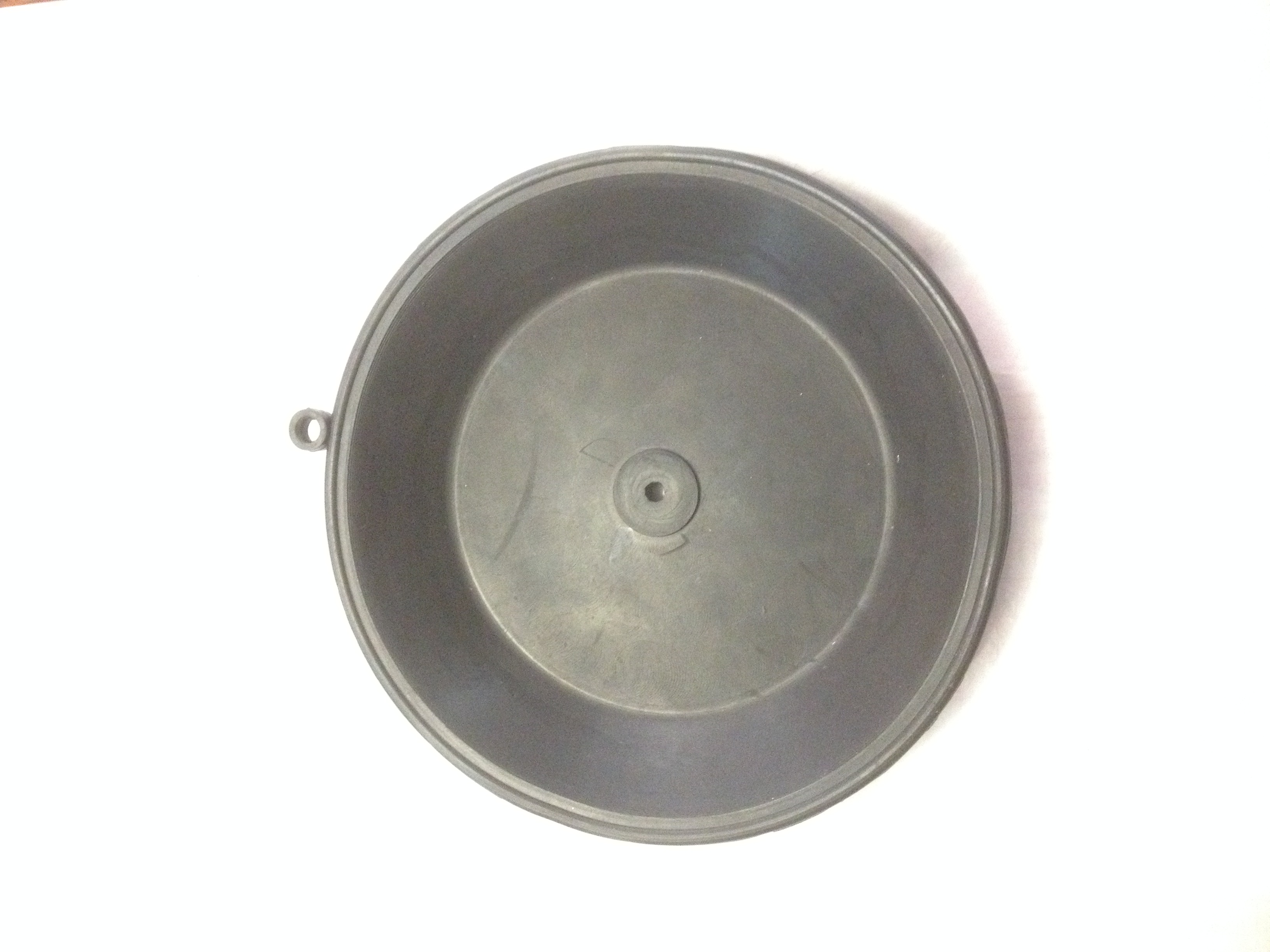

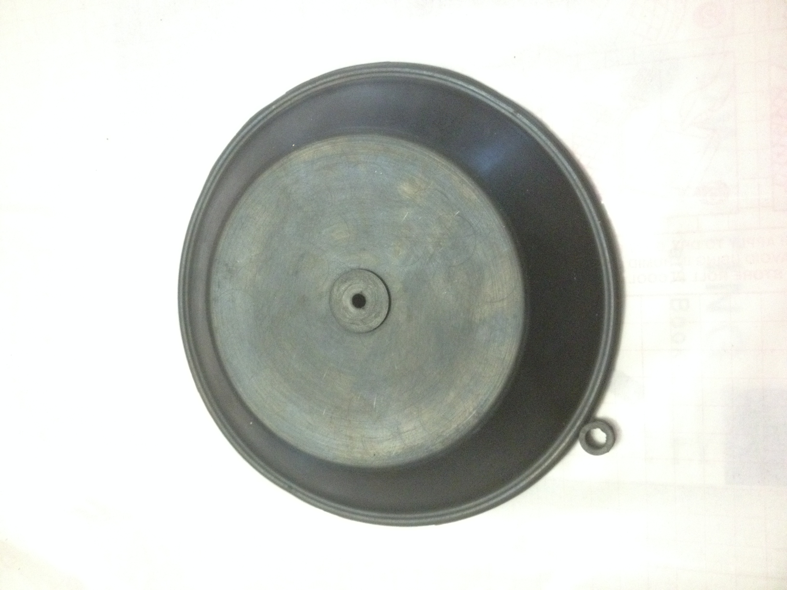

Yes the main rubber they use is off a newer model and you would need to purchase their adaptor plate for it to work. They probably should have told you.
Ive got the mould and remanufactured them in the correct rubber, they wont go goowy. Have about 20 left over if anyone is interested, I occassionally list them on ebay for $50, that was to cover my costs not to make a profit. I have 10 boosters of my own. I used the original drawing from PBR in melbourne to make the mould so as per original dimenssions including the attached pipe.
The engineers at pbr said they scrapped the mould because they had mistakenly used the wrong rubber and didnt want to be forced to do a recall.
Hope this helps.

Hi,
Yep they did make mistakes back then. They forgot to allow for the vacuum sucking the engine oil fumes back to the booster when you turn off the engine and affecting the main diaphragm rubber. Basically there was two rubber types those that were external and those that came in contact with brake fluid. Unfortunately should have used the chemical resistant type, they used the wrong one. That's also why they ask you to instal as high as possible under the bonnet.
Anyone that has a main diaphragm shape that doesn't look like the pictures I posted has been affected. The rubber stretches to the shape of the booster and become soft and stretchy therefore not transferring the vac to the piston properly.
reprehensible isn't the word I would have used, criminal would be better. Is their eyes it wasn't dangerous because you don't loose your brakes just the boost.
