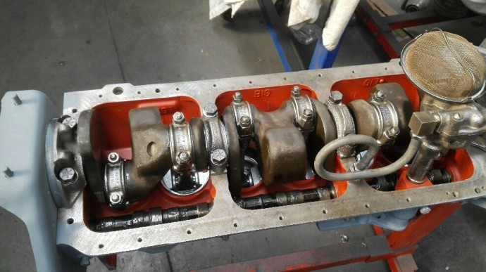

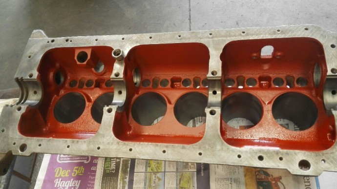

The engine builder has sent me some photos of how the 138 is progressing....
The crank was ground, block decked and bored, new everything, cam was ground to allow for the twin carb set up....Head was given a birthday as well, new springs, valves, ported and polished, stainless valve seats to run unleaded fuel(at $2.00 per litre)
Block is gloss black all bolt ons will be grey... twin Bovx carbs with a "monaro motors" manifold..
