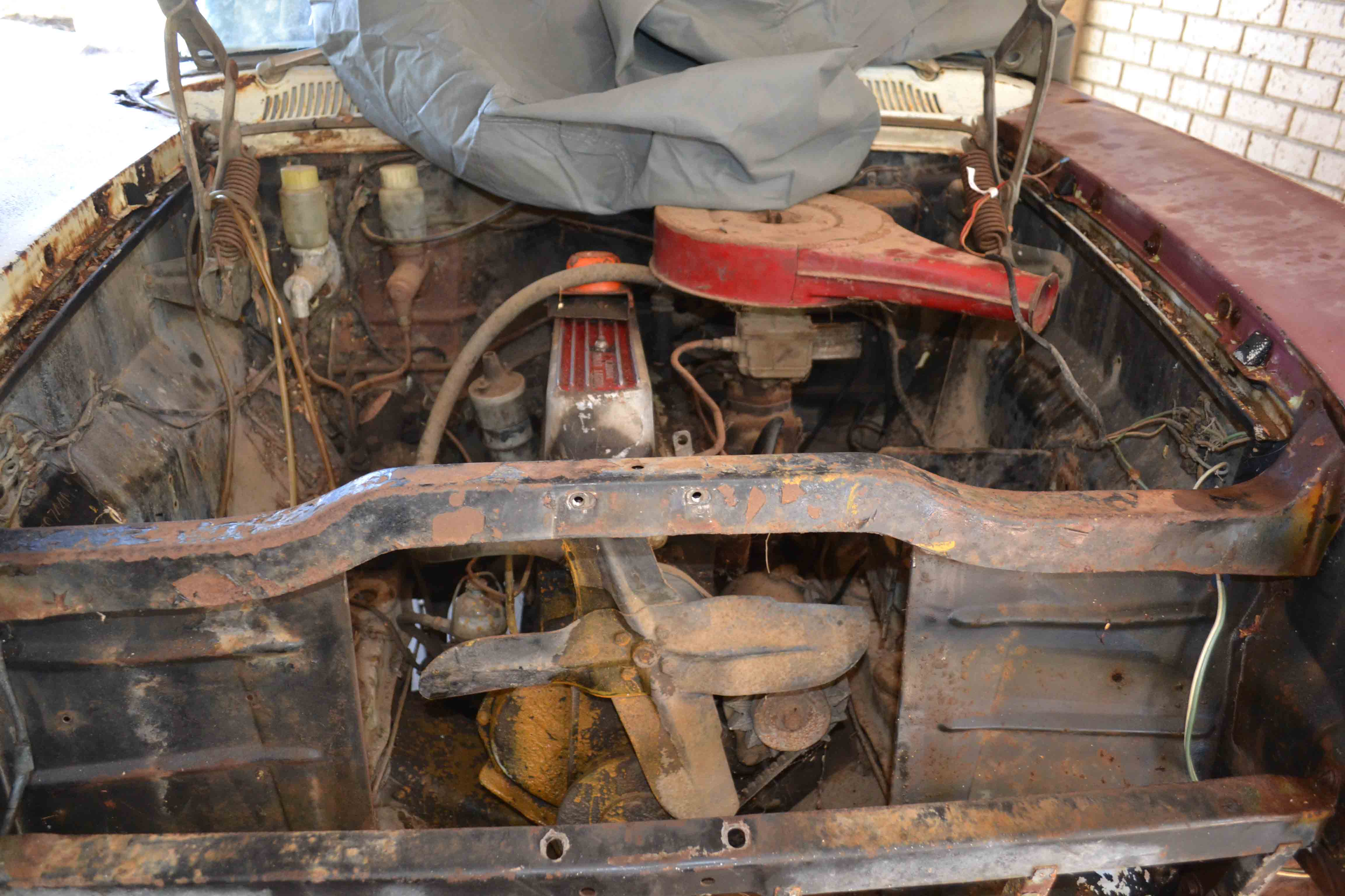

So this weekend has involved stripping interior, removing tow hitch, removing rear bumper and tail lights and removed the radiator.
Radiator out but unfortunately the support bracket will require a bit more persuasion with a couple screws to remove.
So removing the interior has revealed some lovely Iron Oxide in the rear floors as well, so looks like I'll be up for all new floor.
