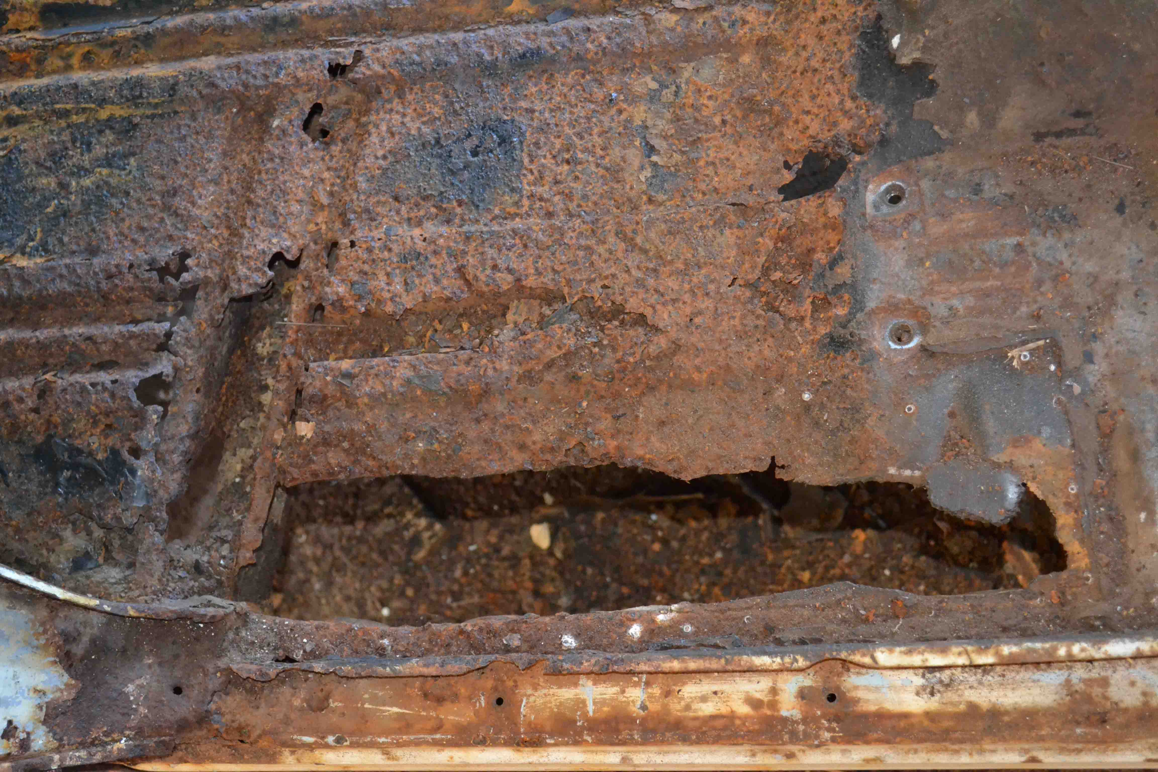

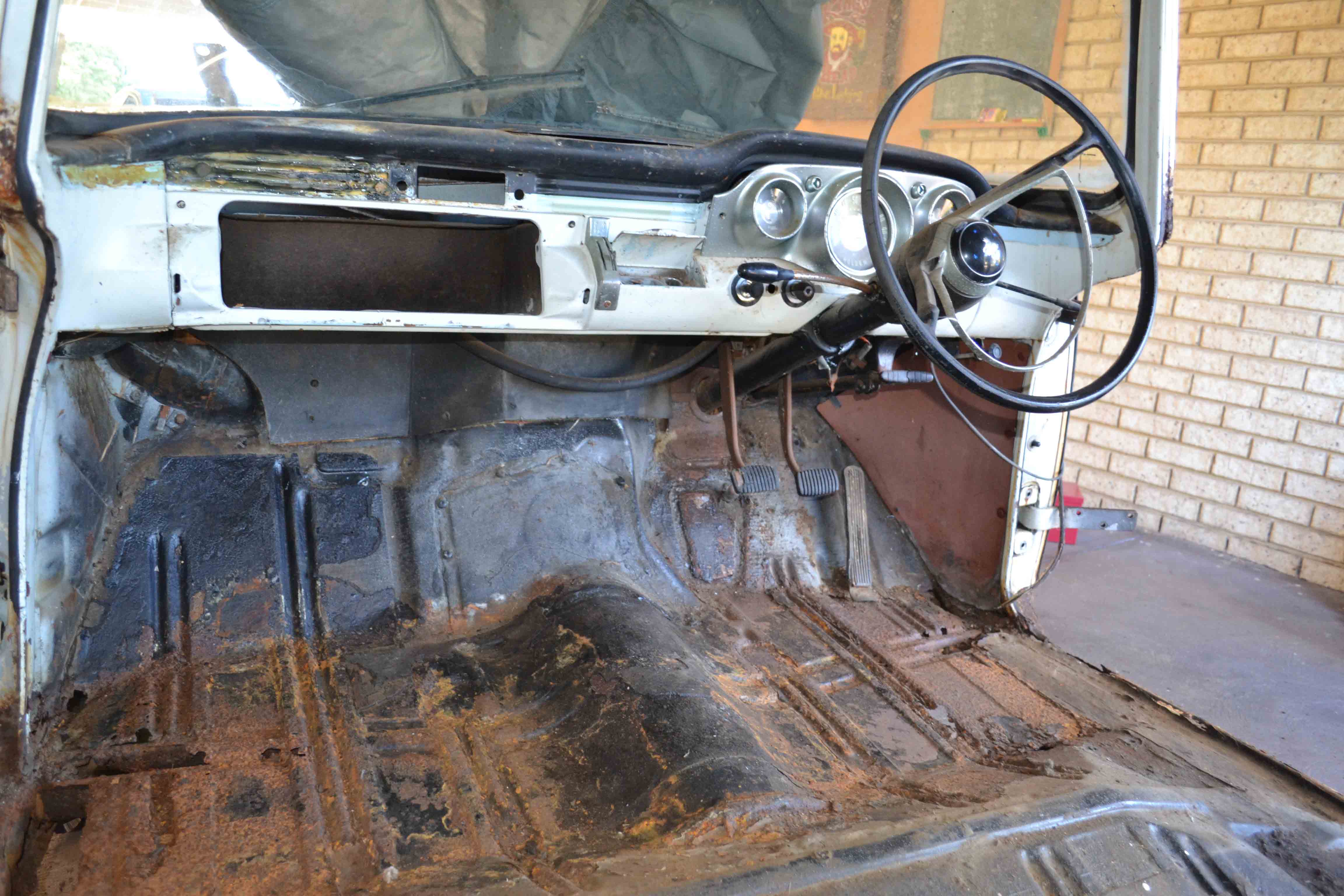

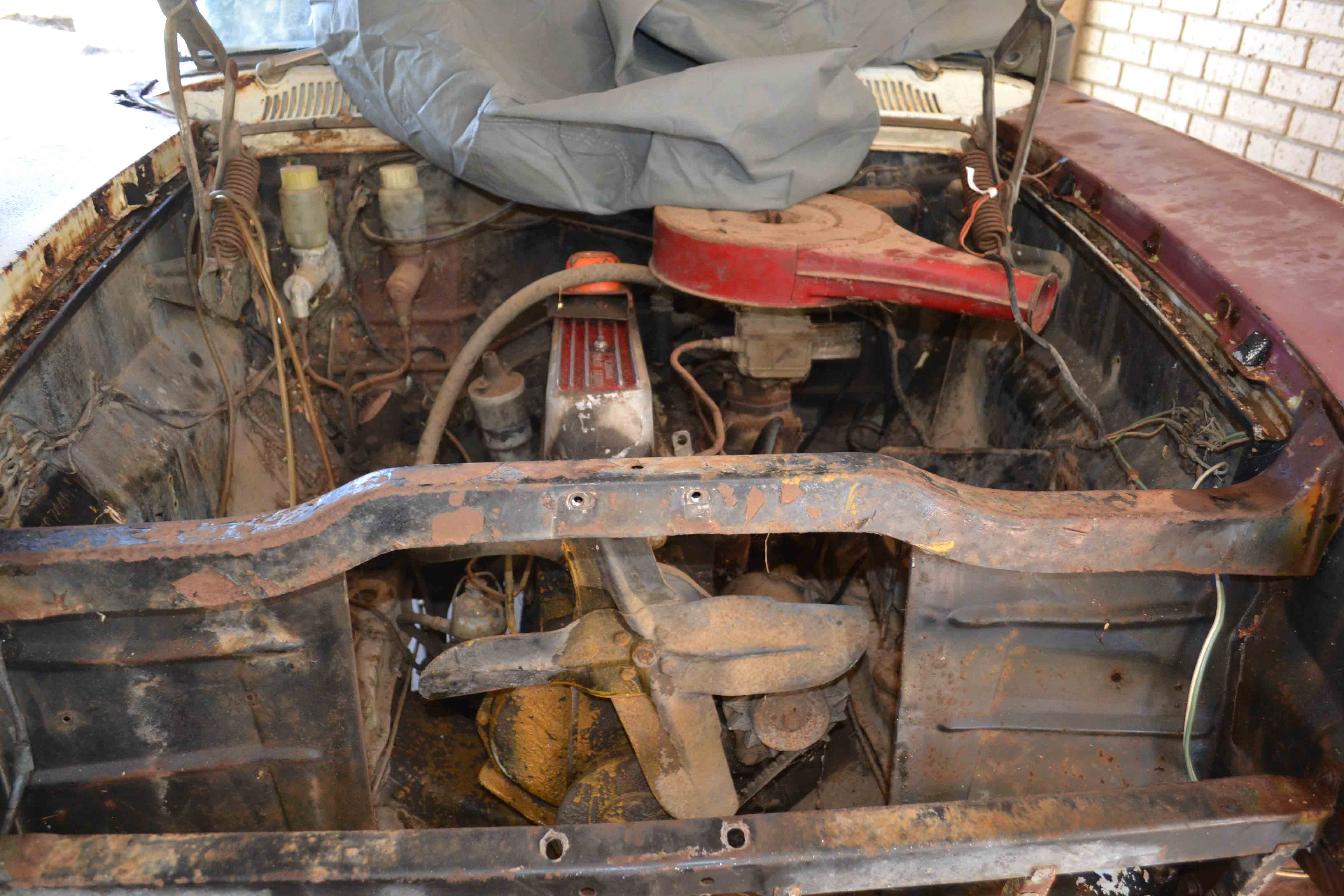

So this weekend has involved stripping interior, removing tow hitch, removing rear bumper and tail lights and removed the radiator.
Radiator out but unfortunately the support bracket will require a bit more persuasion with a couple screws to remove.

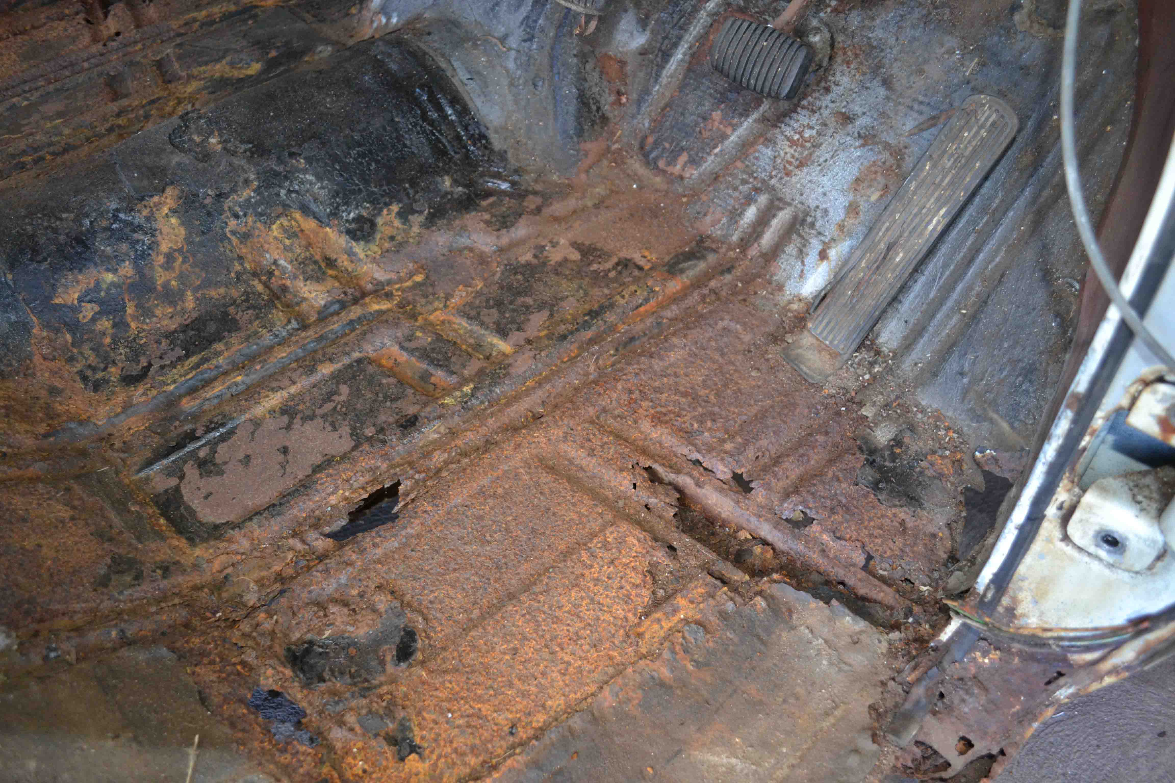

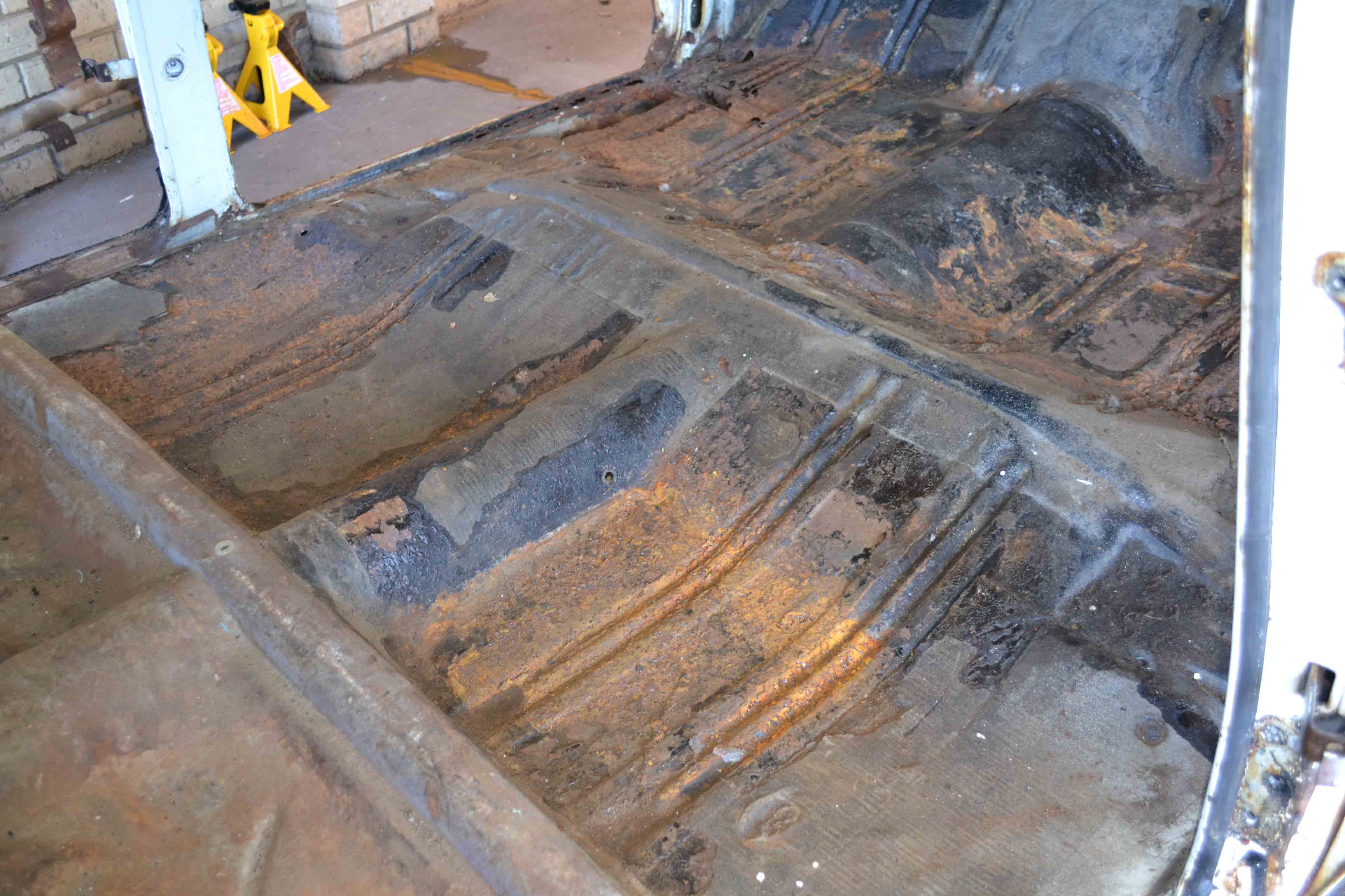

So removing the interior has revealed some lovely Iron Oxide in the rear floors as well, so looks like I'll be up for all new floor.
Hopefully I'm not posting too many photos for you all haha.
Posts: 14279
Re: EK Holden Project Perth W.A
all pretty standard rust so far ......
