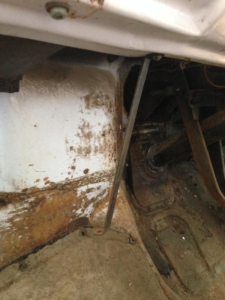

forgive my ignorance but with the rust you found on the roof did you prime over it to repair later or did you leave it bare in that area ?

The rust I found in the roof just received a real good wire wheeling, and then I primed over the top.
I plan to come back to that area at a later date, strip back enough to do the repair, then prime over the welded in section.

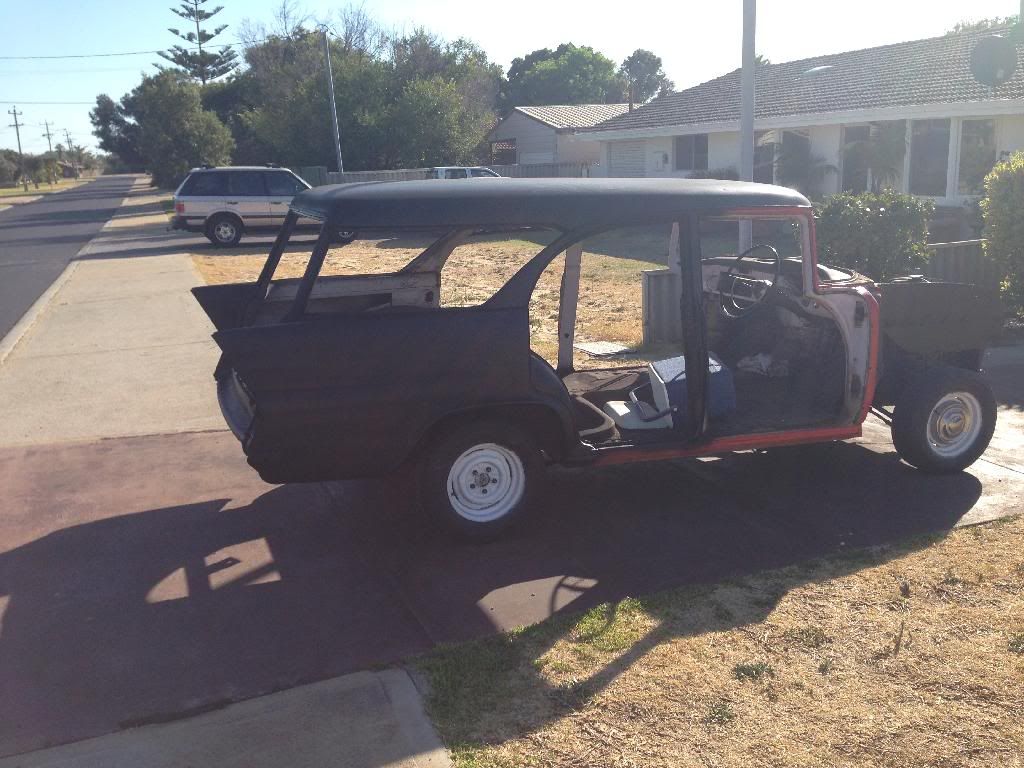

Put a solid day into the wagon...for both rear quaters, rear door rubber channels, b pillar, and around the tailgate area paint stripped and wire wheeled.
happy with the lower rears, only a couple of little holes, around the windows is solid, and the doglegs are clean, although one looks like it will need some attention to get the correct position.
Layed down some more epoxy, this time it came out dry, my gun was playing up abit, but I think it's mainly from the heat we have had. I don't think it should matter to much as it will have highfill over the top.
