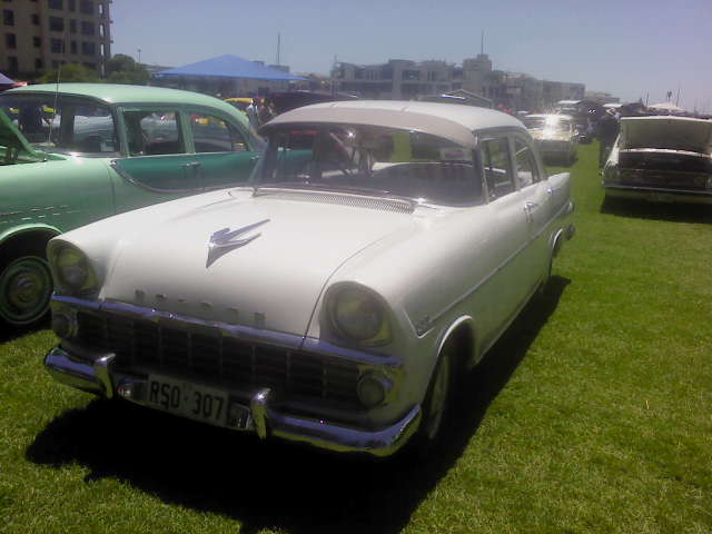

by notnad kram
Ok thanks guys for all your help, I couldnt find it so I rolled down to the mechanic who found a little piece of metal in the dizzy which must of moved while reversing up the ramps, it was arcing out across to that. Anyhow he tidied up some wires and connected my diamond dot radio and $50 later she's a runner with abc radio, life just got good again. :grinnn: Thanks again to you all, Mark

that was All Holden Day at glenelg, 3hr drive and she drove really well.

Posted: Tue Jan 22, 2013 1:09 am
by MeFB
Happy dayz :thumbsup:
Car looks good.
