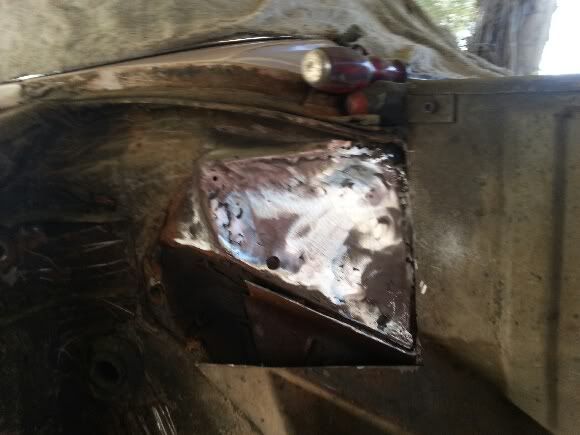

bootlegger wrote: Ill be able to fix the firewall properly without taking the subframe off.
Hi Dave, May I ask how do you cut and weld these two bolt-attached surfaces (subframe and firewall), without making the subframe a permanent fixture to the firewall?
Thank you,
Steve

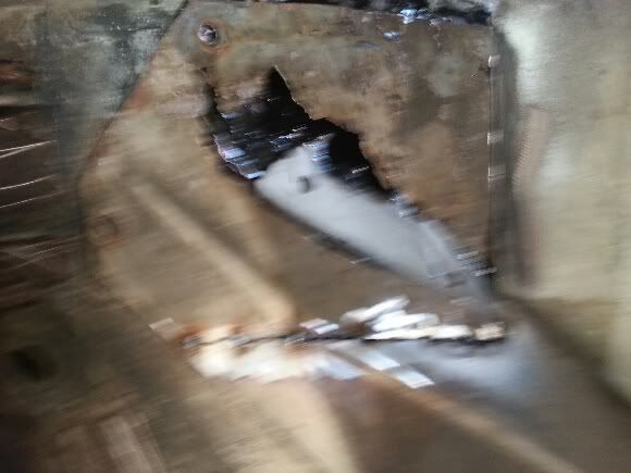

Here's some photo's of the firewall repair that Dave texted me. I'll let Dave explain how it was done.

Thanks pete. Steve im figuring re your question about doing a firewall repair with the subframe in place stems from somebody telling you the only way to fix it is to weld the subframe to the body.
I hadnt done one this way before so your query yesterday put some doubt in my mind also.
It was surprisingly straight forward.
The main problem with this area is its made up of three layers with im guesing almost no paint and the dirt builds up there.
The pics are out of sequence but bascally i cut away the outer subfram revealing the inner frame.
Once i got this away i could cut out the firewall and replace it with good metal.
I painted this with kill rust the reinstalled the heavier section reinforcing piece.
The lower section of the outer subframe was good so i welded that back in and then cut off the rusted out upper.
Then i made a new upper drilling some plug holes to weld the layers together instead of the original spot welds.
Once all welded i ground it painted it in kill rust and resealed the gaps with bitumen as original.
It came out great. Apart from the black patch you cant tell it had been done and you can still unbolt the subframe as per original.
