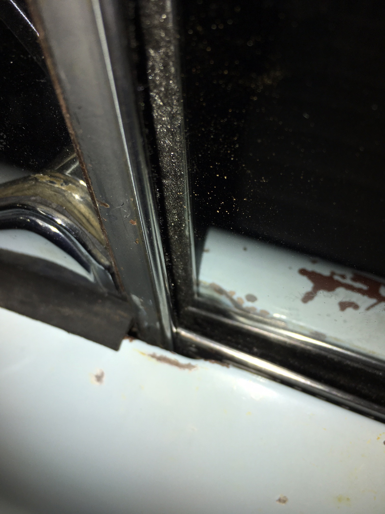

Im doing the q windows atm and was wondering if you replaced the other rubber on the vent window the one on the back side the of baily channel.
Edit, i took a pic of the rubber so left to right is the frame then steel insert with old perished rubber on it then new rubber then glass and frame.
so the back of the new rubber doesnt seem to fit over or be the correct shape to fit over the steel insert, do you discard the old steel insert and glue the new rubber staight to the actual frame.

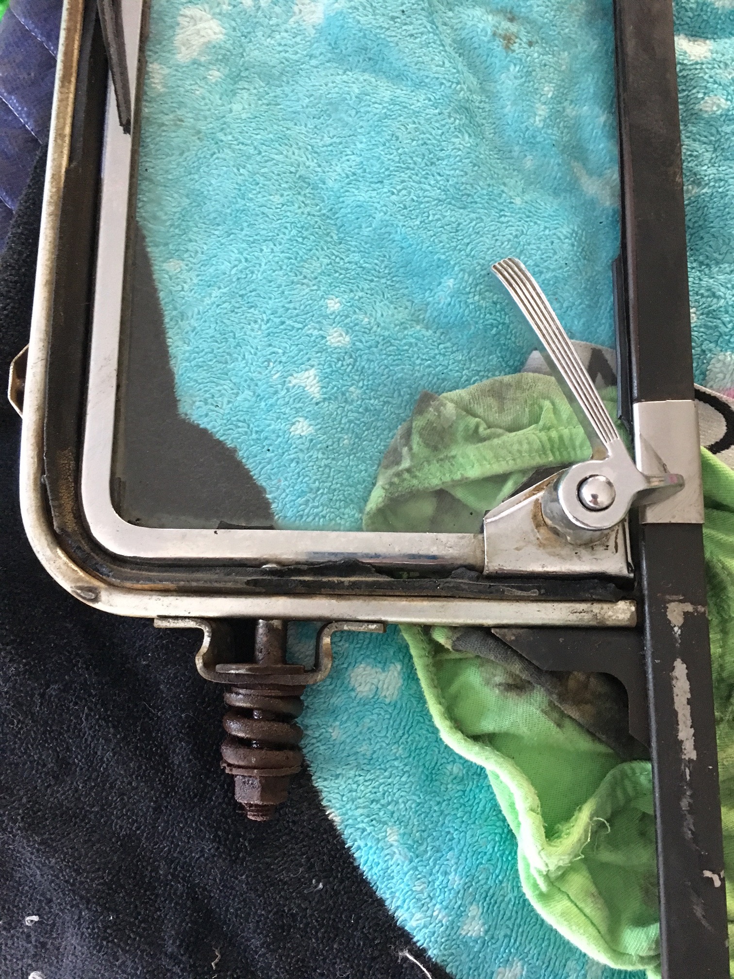

Spindle 1jpg.jpg (1.04 MiB) Viewed 6824 times

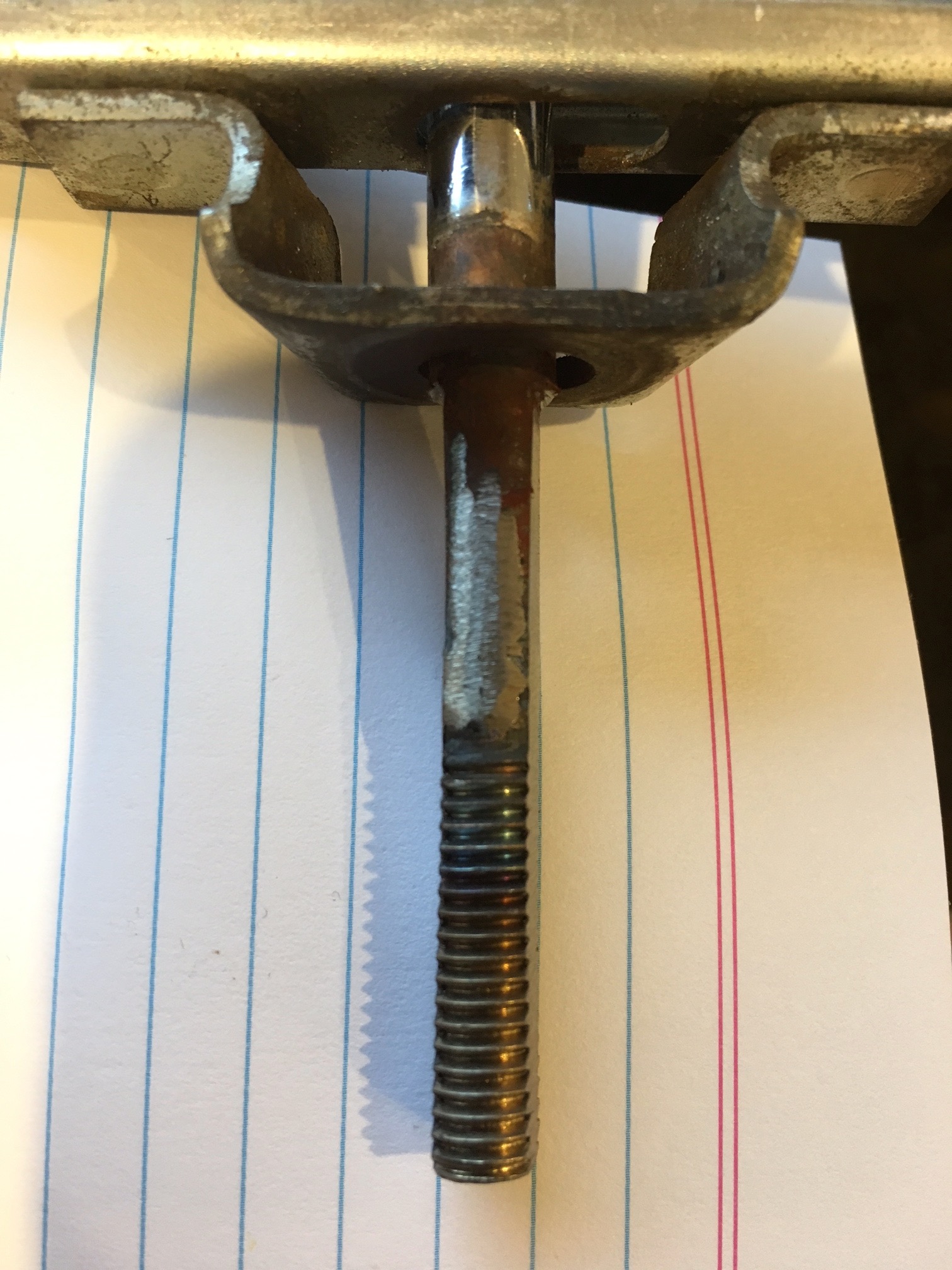

Alas, I didn't think to look and hence the reason why I broke the lower pivot spindle on the second window yesterday. :crying:
So I thought I would share what I did next as I am not sure what others have done by way of fixes.
I called around and took the window to a local welder. He managed to weld another bolt on to the broken spindle by creating a 'v' in one end, and an 'arrow head' in the other. I understand that the join will not be as strong but I am pretty happy with the end result for the time being. Of course the only measure of success will come when I put the new spindle to the test when I reassemble the window tomorrow. A careful eye will see that I already have a problem as the new thread appears to be slightly larger and not quite the same shape. The nut doesn't notice a difference but the vent stop is going to take some convincing before it finds its way back to its old home...
