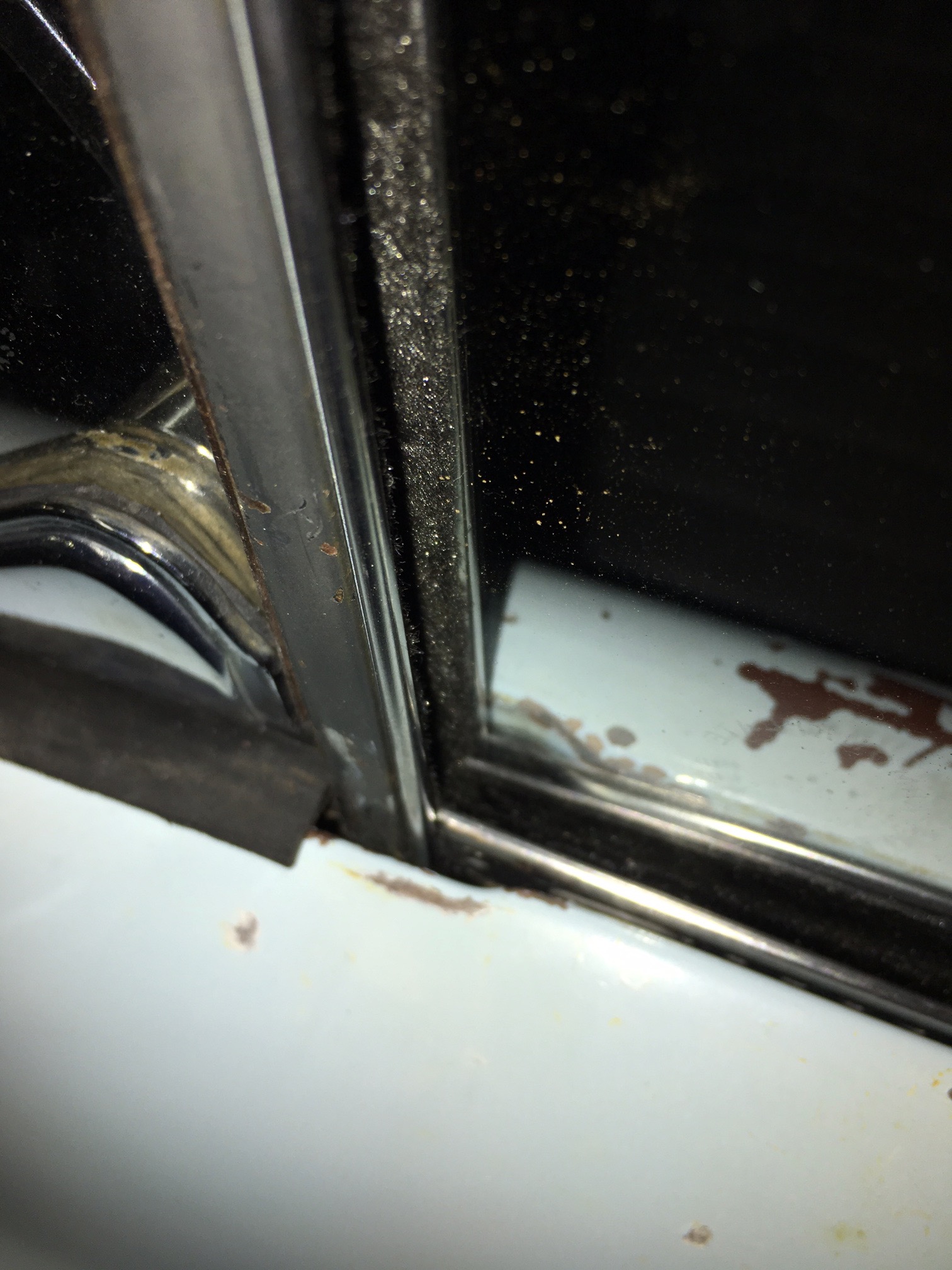

Im doing the q windows atm and was wondering if you replaced the other rubber on the vent window the one on the back side the of baily channel.
Edit, i took a pic of the rubber so left to right is the frame then steel insert with old perished rubber on it then new rubber then glass and frame.
so the back of the new rubber doesnt seem to fit over or be the correct shape to fit over the steel insert, do you discard the old steel insert and glue the new rubber staight to the actual frame.

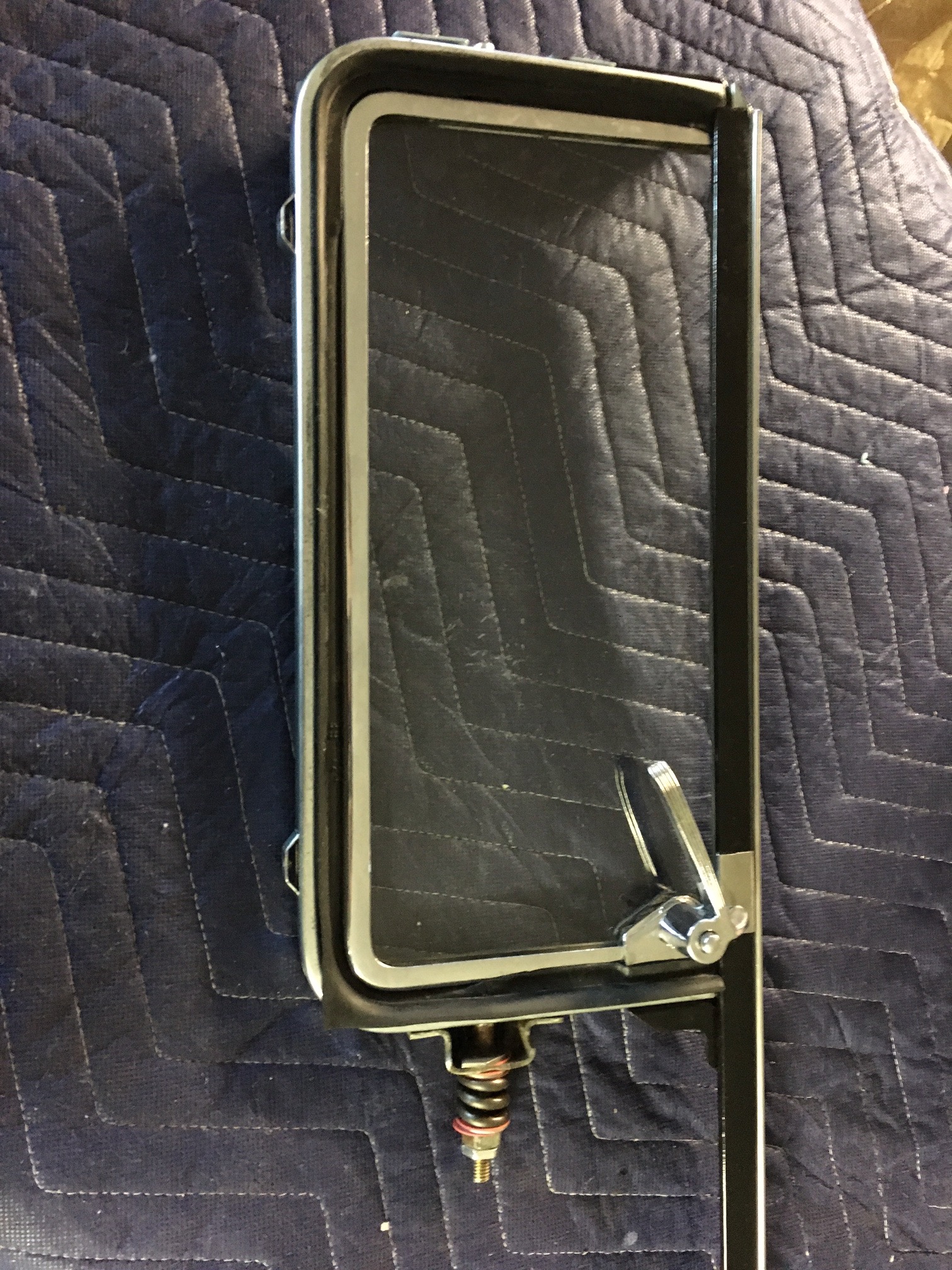

This would have been a great post for me to read before I started the quarter vent windows.
Spindle 1jpg.jpg (1.04 MiB) Viewed 9445 times
Alas, I didn't think to look and hence the reason why I broke the lower pivot spindle on the second window yesterday. :crying:
So I thought I would share what I did next as I am not sure what others have done by way of fixes.
I called around and took the window to a local welder. He managed to weld another bolt on to the broken spindle by creating a 'v' in one end, and an 'arrow head' in the other. I understand that the join will not be as strong but I am pretty happy with the end result for the time being. Of course the only measure of success will come when I put the new spindle to the test when I reassemble the window tomorrow. A careful eye will see that I already have a problem as the new thread appears to be slightly larger and not quite the same shape. The nut doesn't notice a difference but the vent stop is going to take some convincing before it finds its way back to its old home...
Spindle 2.jpg (581.62 KiB) Viewed 9445 times
One question I had is what paint have others used on the bailey channel? There are too many versions of black (phantom, evoke, ebony, black metallic, matt, gloss) at SuperCheap for my liking.
Wayne

Just for the record, the repaired thread seems to be working so far. I am not sure if I got the vent stop right (and it's too late now) but so far the repaired thread seems to be holding up well but time will tell. Happy with the result.
Couple of questions for those that might have recently been there, done that. In fitting the outer door rubber I found that the new rubber does not have a square corner like the older original rubber, which leaves a gap in the top corner. (I should have taken a blurry photo as my finished job on the door rubber is a little 'wobbly' in spots.)
Have others experienced the same problem? I was thinking of cutting a corner piece and glueing it in place but I thought I might see what others have done.
I was also surprised that the outer doorbelt doesn't have the same profile as the inner belt and so I have a gap between the rubber on the quarter vent and the new door belt.
Has anyone else had the same experience and if so, what sort of fixes have you tried.
